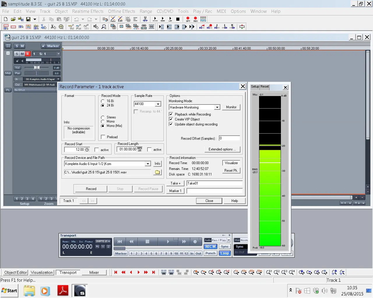

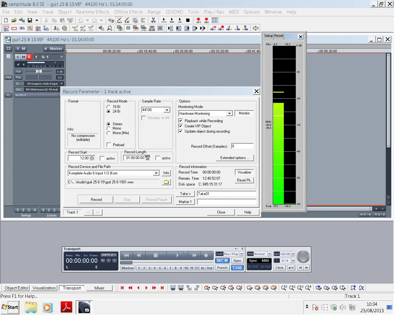

Not talking of converting TRACKS Bob, just a mono input and this could hardly be easier in Samplitude!
Just pop the button marked Mono Mix and You're somebodie's Uncle! I hope the screenshots make it plain?
I used the KA6 and plugged a Mex Strat into the left input. I tried the same exercise with A.A. 1.5* and Reaper. Neither do it so easily to me but then we have "grown up" with Samplitude from Music Studio Gen 6 over ten years so everything else seems clunky to me!

Oddly, I uploaded the STEREO screen first then the MONO one but the order has reversed. Oh well!
Yea Dave, all of the DAWs I have worked with has this same function, that is why I was confused about a mono input. When selecting in Reaper or Ableton, you get the option of how you want the input. I only see a few occasions to use stereo, so the inputs mainly stay mono.
But, if I have a stereo input (from say a Youtube source), I use a utility that adjust the spread from 100%, to zero.
