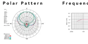

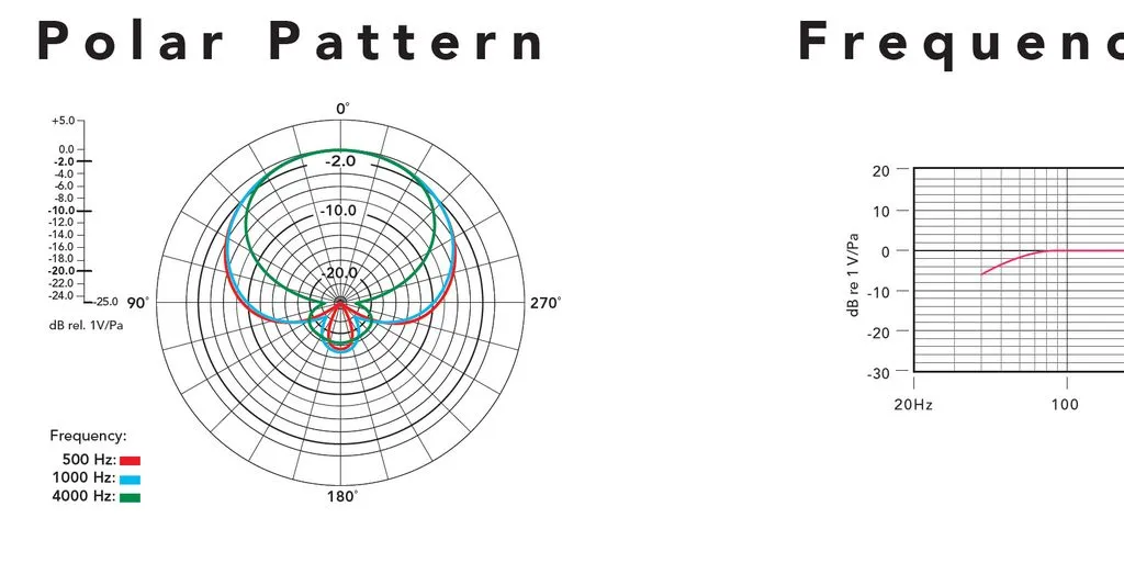

What is behind the mic when you're recording? The NTG3 is a super cardioid which has a small node of sensitivity projecting to the rear of the mic. Wondering if what could be picked up from behind if there is a close wall may be causing some odd phasing issues that are possible reason for a boomy/bassy sound. The wall behind the desk likely isn't helping much. Just as an experiment have you any blankets that you could hang behind the mic and behind yourself or others means to make a recording in a room that may not have as many acoustic reflections.
I think a distance of 12-14 inches was mentioned. I may be wrong in the case of this particular mic, but I don't see proximity coming into play at this distance.

I'd be looking more at the 'big lobes all around top bottom and sides. The back's down dozens of dB :>)

C/o the polar plots from both. After seeing the AT's plot I looked up the OM-5 again. Sure enough.. the lowly OM-5 appears much tighter than this shotgun'. I'm sort of curious. It would seem it could do better, room rejection wise regardless of being out like that.
