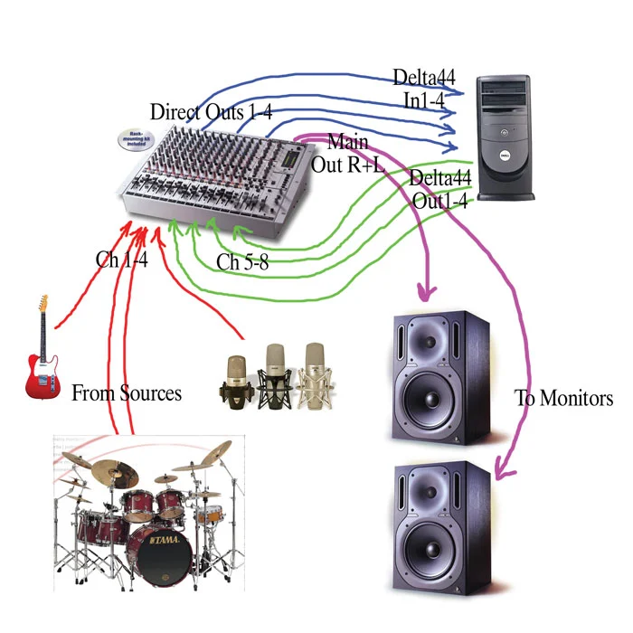

1.) I'm thinking about buying a Behringer EURORACK MX2642A --- has 16 inputs and 8 channel inserts (direct outs), has preamps and Phantom power for mics, etc --- all for less that $300. I want to have a mixer for the preamps and phantom power for the Delta 44's 4 inputs, as well as a mixer for the 4 outputs. Would this be a good choice? Go out of the mixer into the Delta 44 into the PC, then go out of the PC into the Delta 44 into the mixer for playback? Would this create a feedback loop? I've attached a diagram below...

I'm curious about the wiring, though. Can anyone confirm or deny that this will work? See the attached file (setup_chewmanfoo.jpg).
Thanks!

It's more a matter of mixer routing then wiring and it will work if you use the channel inserts to send out the audio to the delta.
I would recomend a Mackie 1402 or Spirit M4. That Behringer has more channels then you will ever need with that sound card and the mackie and soundcraft are higher quality.

So what I'm hearing from you guys is that the Behringer mixer is so bad that even though I can get 16 inputs, 8 direct outs, rack mounted for under $250 bucks, I shouldn't. Remember, I'm just starting out here. The Mackie 1202 VLZ PRO, which has just enough inputs, and has no direct outs. And it costs **twice** as much as the Behringer. So, as far as I can tell, it won't work for my application (4 in, 4 out Delta 44) because it has no direct outs, which means I can only record 2 channels at a time (R&L from the Mackie's main outs). The Soundcraft M8 is perfect for my application (each 8 channels has direct outs), but it's $550. The Behringer is only $250.

I feel like I need at least 8 inputs in the mixer. 4 for instruments, 4 for the outd from the Delta 44. I also think I need direct outs from the mixer, or I'm stuck with recording 2 channels at a time from the mixers main R+L.
Is this correct?

The 1202 has inserts on the 4 mic channels (pretty much the same as direct outs) as well as 4 Buss and 2 AUX outs for a total of 8 individual sends.
