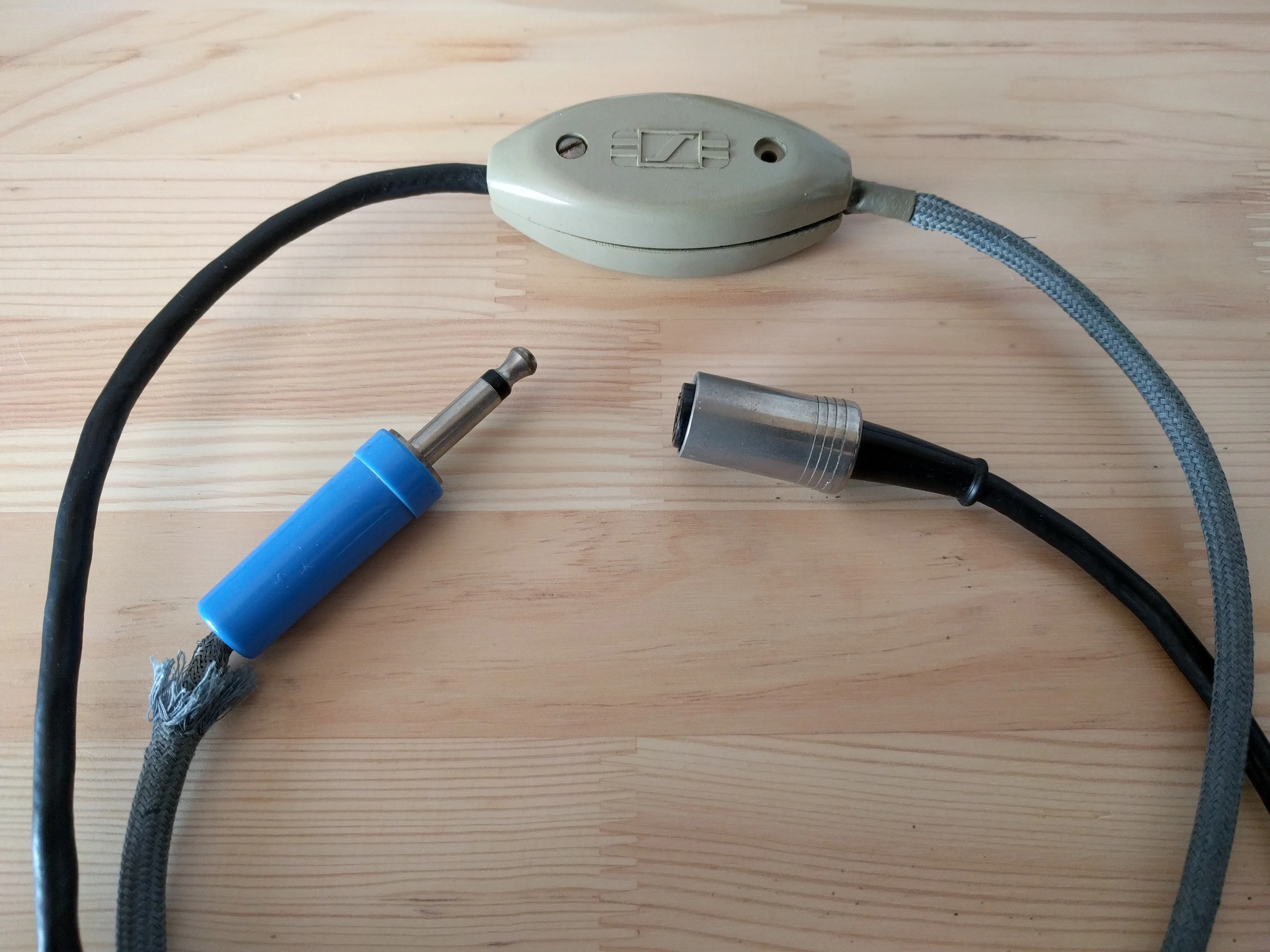

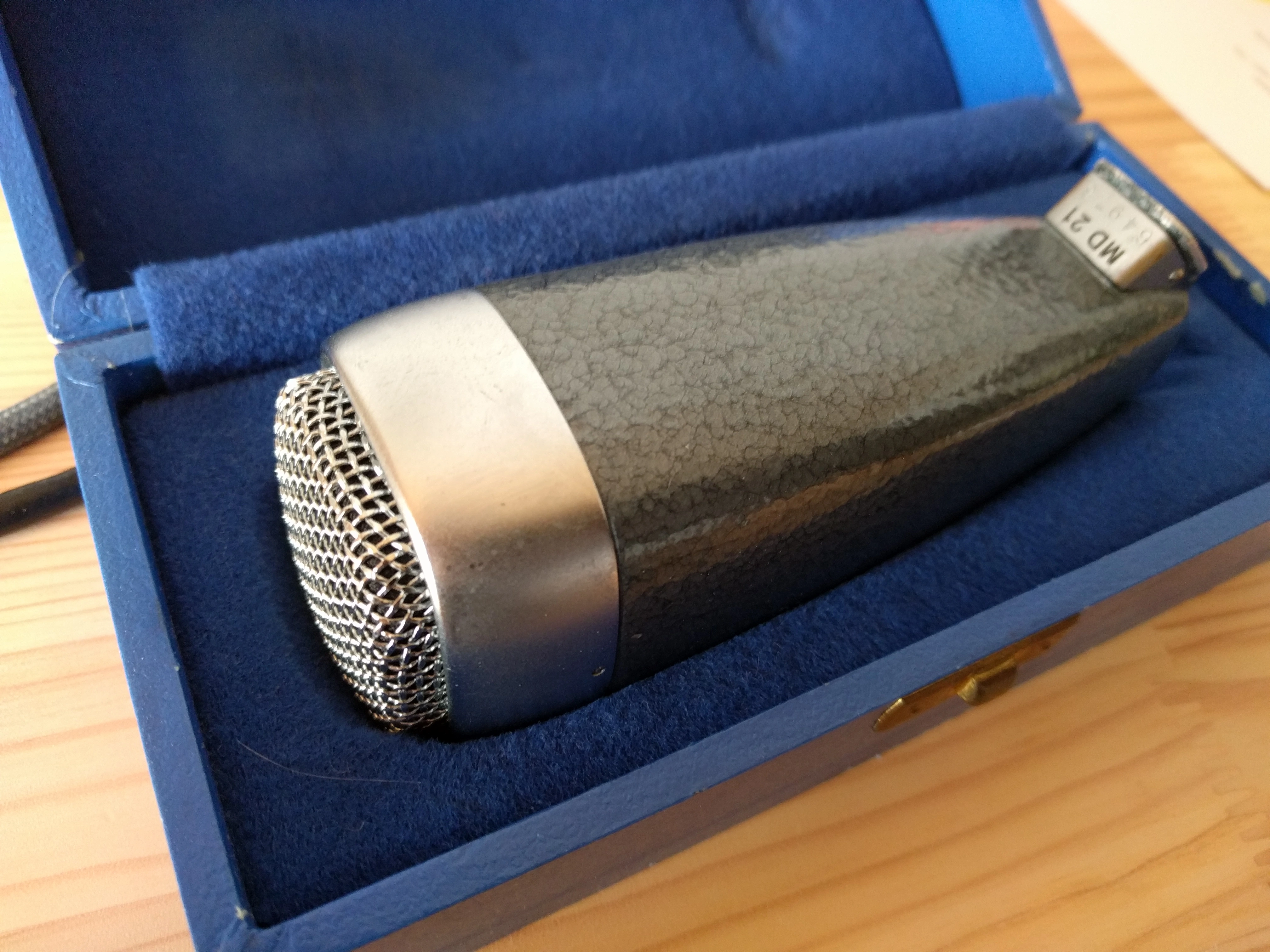

The MD 21 is a current microphone and still made today.

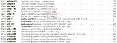

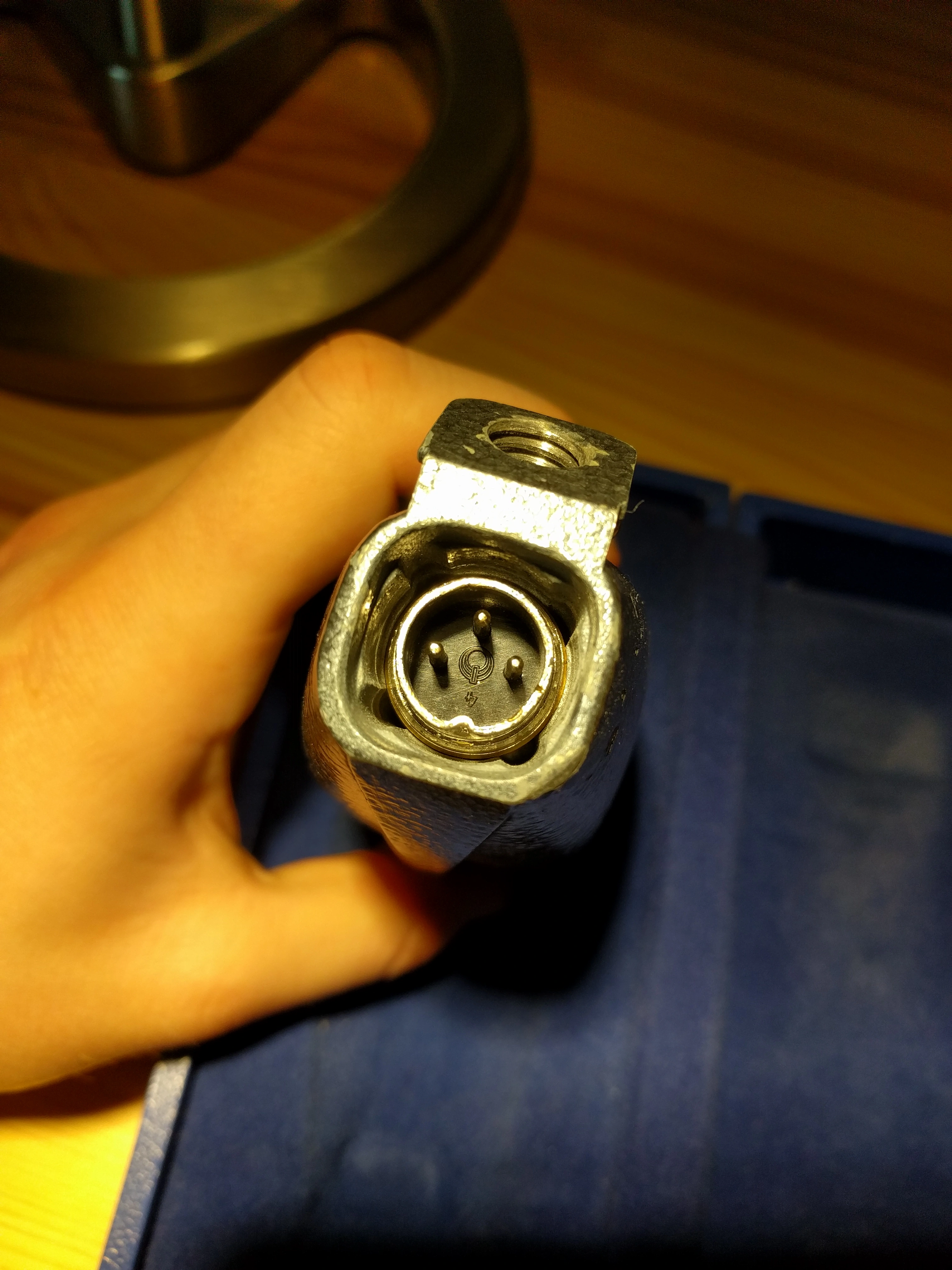

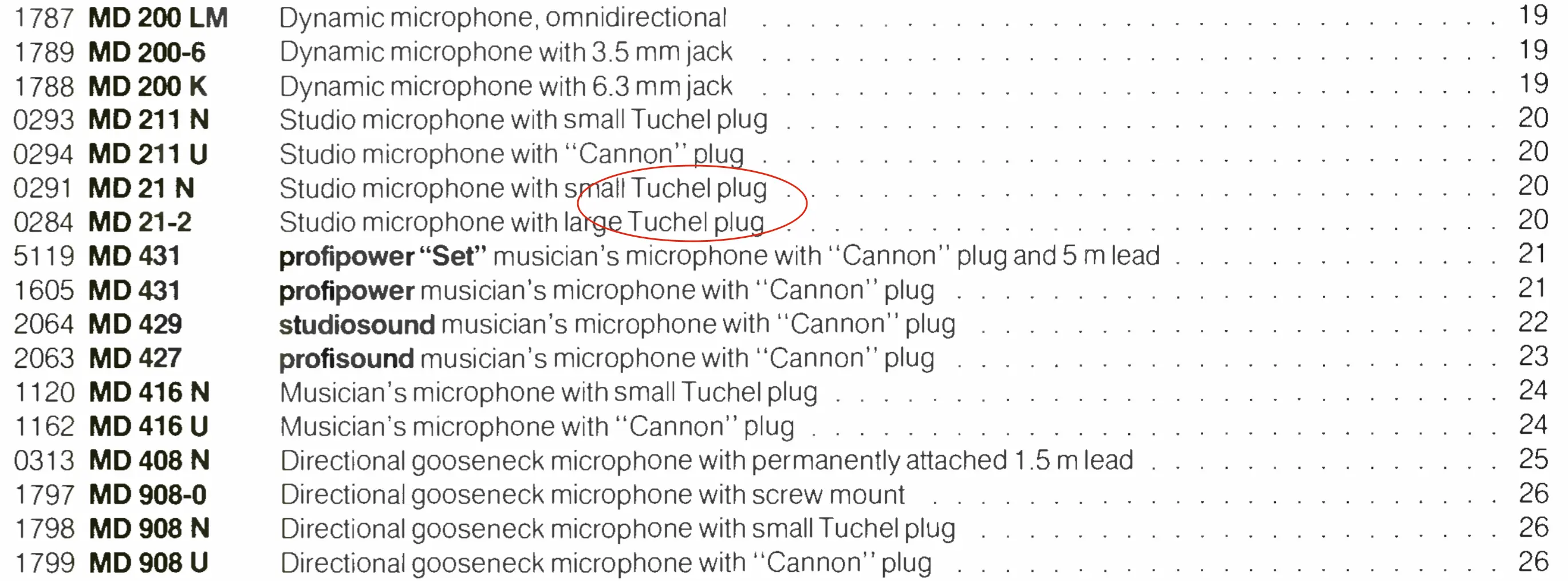

Personally I would ignore the cable completely - the cable-wart is either a transformer to unbalance the microphone or one that also converts it to high impedance for ancient tape recorders; so you don't really need it.
So - just get a new cable with a Tuchel DIN connecter at the mic. end (also made by Binder and you can get these from Canford Audio in the UK) and an XLR on the other.
The MD 21 was, according to Rupert Neve when I spoke with him some years ago, the best reporter mic. ever made. And that's why it's still made today.
