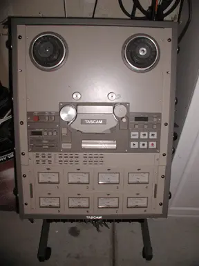

It's a private sellar.... no ebay! The sellar says that everything worked fine until they transported it. After that, 3 channels didn't work.
The circuit cards in the 38-8 are in the bottom of the machine for each channel. Many times these card are easily unseated, jarred loose, etc. The 38-8 seems to have had problems with mechanical circuit board connections as they aged.
These machines are notorious for having connections come loose during transport. If you buy the machine, I can tell you the procedure for reseating your channel cards.
The relays ON the channel circuit card have a higher than average failure rate too. But we're talking about a 15 to 20 year old machine here too. The failure rate was within spec when they were new. Contacts get burned and chared and continuity is lost.
That could be the problem. If you're a tech, or are experienced in electronics WITH the manual it's not that big of a deal. The snag comes when TASCAM charges you for the relays and I don't know what they cost.
It will be K101, K102, or K103 on the channel card. Don't assume because I'm telling you this that that is the problem. The tech I talked to in St. Louis this morning said that 90% of the problems they see on the older TASCAM 38-8's are loose circuit board connections.
Check the condition of the tape guides, the capstan, and the pinch roller to help judge the amount of use the machine has had. If the flat spots on the lifter base assembly are round with no flat spots (these are the two metal posts that the tape rides under. They are under the head stack cover.), chances are you will only have some loose connections somewhere. Many times re-seating the cards upon arrival will circumvent any problems you may have had.
If this guy is being honest with you about the machine working until it was transported and you can inspect the machine in person, I'd say go for it.

Damn, I didn't look at your IMG link at first because the site is loading so fucking slow right now.
That looks to me to be a 58-8. They are built like tanks and weigh almost as much. They have heavy-duty everything in them. Motors, reel tables , chassis, you name it. That is a Pro ATR.
I would bet it's a connection problem betweeen the channel cards and the mother board.
I'd still pay that much for that type of a machine that wasn't working with the rack stand and the DBX units.

I don't have a manual for the 58 series, but I would imagine that the channel cards are still on the bottom plugged into the mother board.
Tascam deck
FYI:
The deck in the photo looks like an ATR60-8. Which is what you started out calling it (an "ATR"), so that doesn't come as a great surprise. The 58 is a different model. That's not a 58.
While I won't claim any great expertise on the model, I believe it's general architecture is different from a 38 (or various other models, for that matter): it's more "modular," with separate boxes for the input/output, the transport, etc., which you can mount in various different ways.
If it works (or can be made to work for under $1,000) it's a great bargain. Even if it doesn't work, the parts are worth $220++.
I wasn't sure about it. It had been awhile since I had seen a 58.
Glad we found out what it was. :)

Picked it up this morning! Haven't plugged it in yet though. That sum-bitch is heavy.... but it's beautiful! I probably won't get to try it until Sunday.
Thanks for all the Advice,
RF
ATR-60 8 update
It powers up beautifully! There's no physical damage or blemishes anywhere on this deck. The DBX unit is an old looking thing and the number on that is 208. I have no 1/2" reels to actually try this beast but so far so good. The cables look a little oxidated, which might be the only problem with the 3 channels not working. The seller hardly new anything about the machine and judging by where he live (ritzville) it was probably barely used. I'll bet that with just a little bit of cleaning and maintenance, this beauty will work perfectly.
