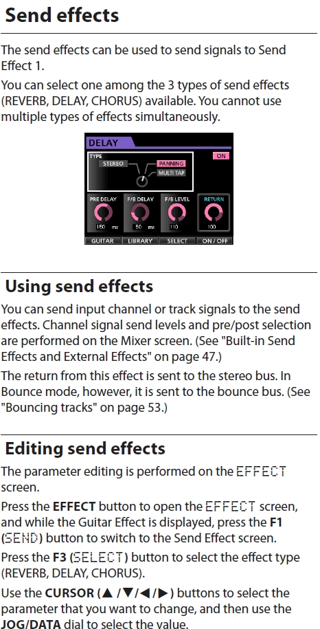

I doubt it's the unit itself. And we could probably use a little more detail as to other settings you have live at the same time. The manual is skimpy on how to use the send effects but it shouldn't be difficult to trouble shoot. I'd start with the feedback setting and work from there. Do you have the manual? See page 65 below.
I really appreciate the time you took to explain, but I actually resolved this. It was my own mistake. I accidentally was sending guitar effects to the voice track so I was getting all sorts of distortion and stuff. I went into the guitar effects and shut them all off, followed your instructions, and all is well. I thank you!!!
