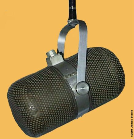

You should propably make a zeppelin like windshield for it.
Didn`t find good pictures of ribbons in the field ( as used in the film industry as they were),but make kind of roomy basket to put it in and cover with the same material as with pop filters. ( ask your wife/girlfriend )
