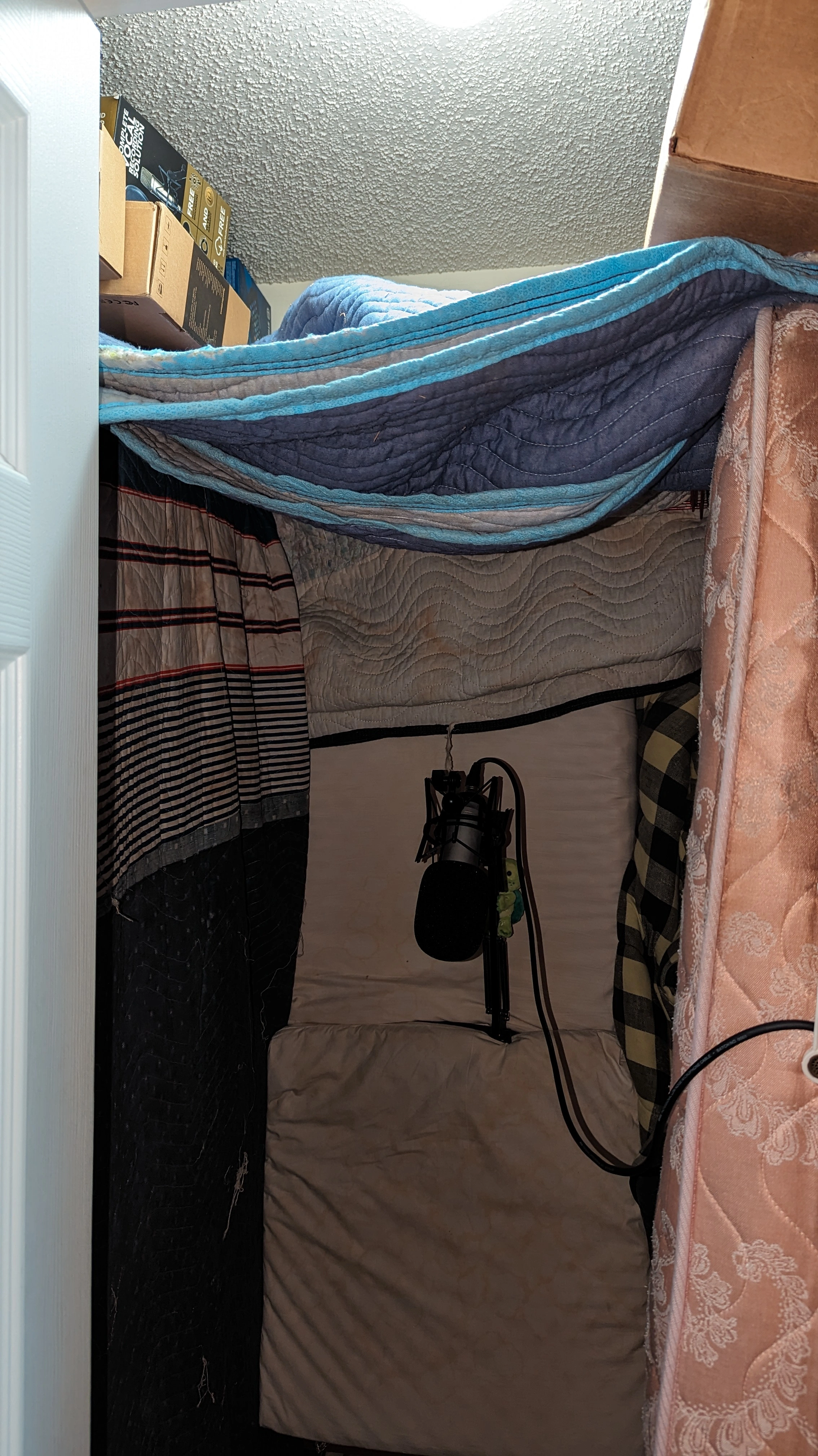

I converted my walk-in closet into a sound-treated recording booth. It's not tiny, but there's limited room.
In design 1, the XLR cable ran from the mic to the interface and laptop outside the closet. The problem was that I couldn't see the interface or laptop, so getting good levels was a challenge, and I couldn't wear a headset to listen to what the interface was hearing.
I redesigned, and in design 2, the interface came in the booth with me, and a long USB cable ran from the interface out to the laptop. That allows me to eyeball levels on the fly with the halo around the Scarlett gain knob. But if I should be doing playback through the Scarlett, and not from laptop hardware, that's going to be a problem.
What's the best solution to my chicken-and-egg problem?
Put the interface by the computer, set the level there with plenty of headroom so you never approach 0 dBFS and record without worrying about it. Getting finished product levels is done in a later step.
I suppose it is a matter of what you want to extend. If the workflow dictates it, perhaps extend a monitor with wireless keyboard and mouse into the closet. Add a headphone extension cable and you'd have pretty much everything. This way, you can operate the DAW while doing voice work, leaving the computer out of the booth.
Extending something seems important, particularly if a client wants a live directed session...
Without a major closet reconfiguration, it would be hard to get a monitor and controls in there.
