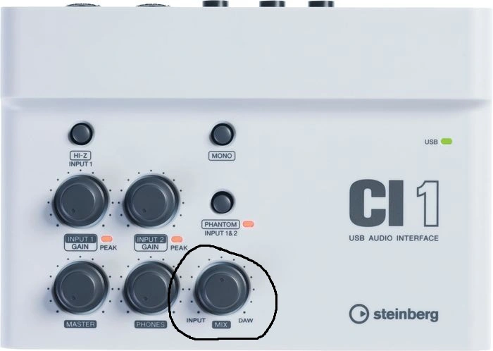

That is not the audio interface you should be looking for. You have to get an audio interface like the Steinberg CL1 that allows you to have a choice of how much you want of your DAW/music/mix and your microphone/instrument .
I have already attached what you should be looking for in the audio interfaces that you find/consider. Hope this helps.

Look at the knobs, does it have any options for you to control the Mix? No. Just find audio interfaces that are good, because if you buy cheap ones, they will just suck, and your money will be wasted. Steinberg CL1 is a pretty decent one and is pretty cheap, too.

That's an interface of sorts but it's aimed at DJs and only does CD players and record decks--it doesn't have a microphone input or monitoring out
