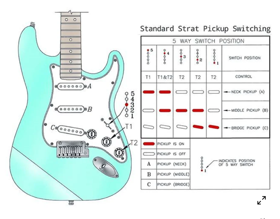

According to the chart posted above (in post #20):
position 1 = bridge only
position 2 = bridge/middle
position 3 = middle only
position 4 = neck/middle
position 5 = neck only

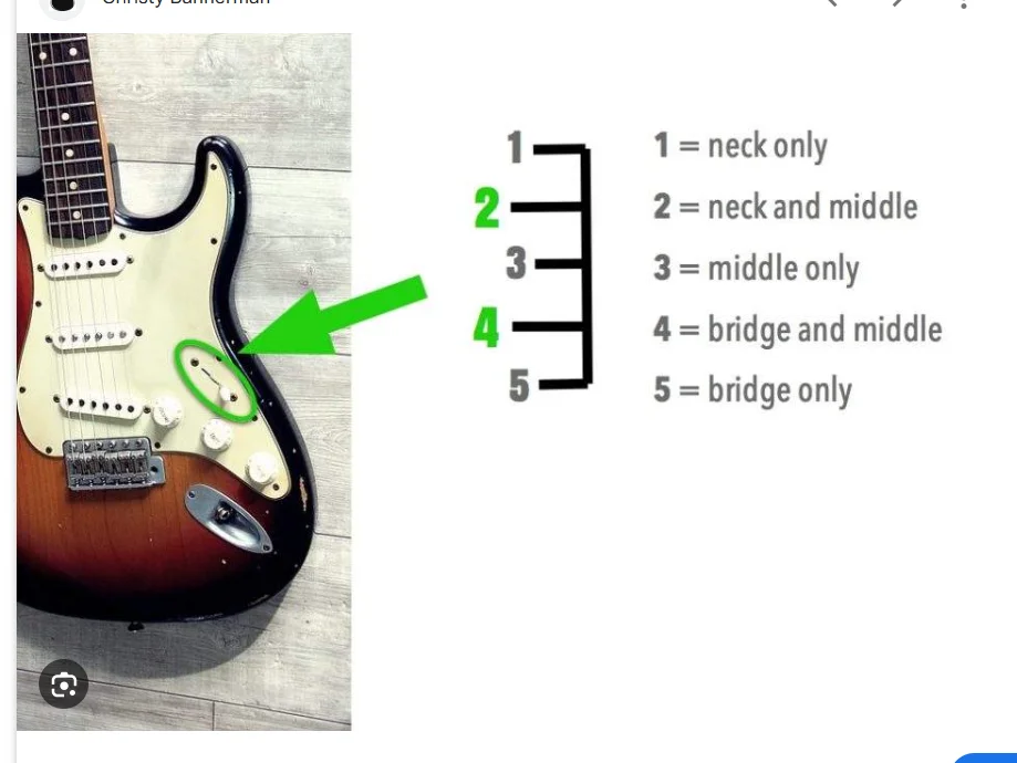

Are you calling position 4 bridge/middle? This is why I was avoiding switch number settings, because there doesn't seem to be consensus about this. See attached images. These both came up when searching "Strat pickup position 4." Two charts showing the exact opposite numbering system.

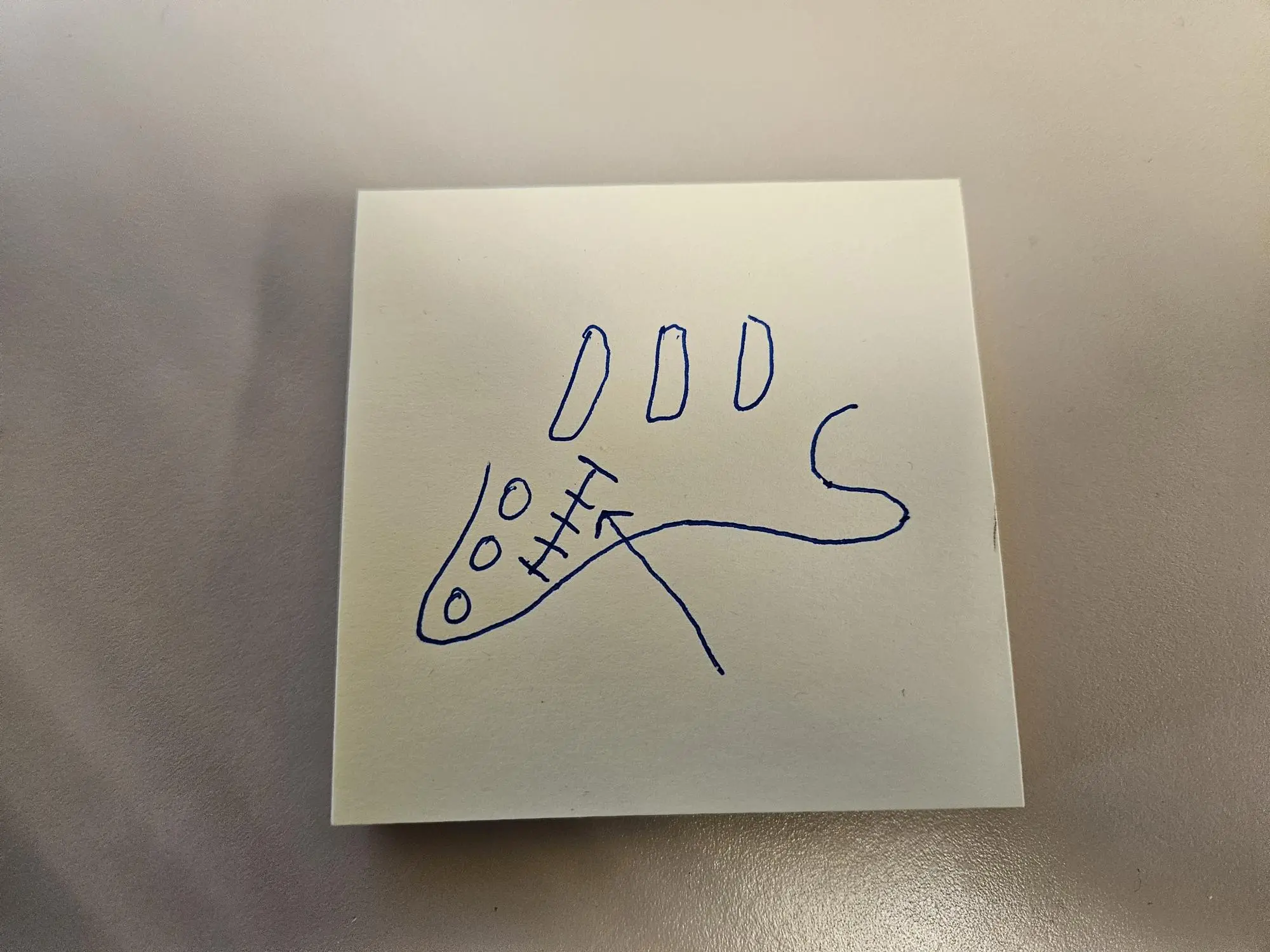

The drawing attached shows the switch position I'm talking about. It's when the neck and middle are selected. Depending on whom you ask, this is known as position 4 or 2. According to the chart in post #20, this is position 4.

No ... the bolded line above is not correct. I don't know how else to say this:
The position that has the issue is the neck/middle position - not the bridge/middle. The bridge/middle position - the second nearest the floor - sounds absolutely fine.
The neck/middle position - the second nearest the ceiling - is the one that sounds out of phase.
