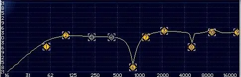

I've tried it all, playing with freq and all, but the sound just aint curved, i attached a picture of my EQ, i really tried moving it all around.
Maybe i will try uploading a mp3 sample so you can hear
