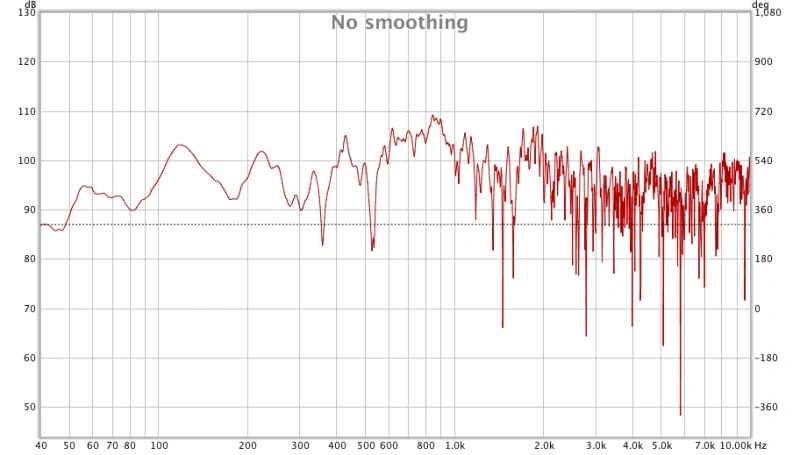

Looking for some help! I have my small little mix room (7' w x 10' l x 8' h) that is essentially covered in gear... no treatment up at all yet. I calibrated and ran room EQ wizard (using a Behringer ECM8000) and got the attached... needless to say some serious issues.
Wanted to get some opinions on the best way to maybe tame some of these.

Looks like a few peaky areas that standard bass traps could assist with. With a room that small as much trapping as you can squeeze in is going to help.
Thanks for replying!
I assumed bass trapping would have no real effect on the significant valleys I have at 300 hz, 500 hz and above 1khz... or are these less of an issue?
I have to question how "linear" a $60 microphone can be. Those 'valleys' may be more of an equipment than room issue.
