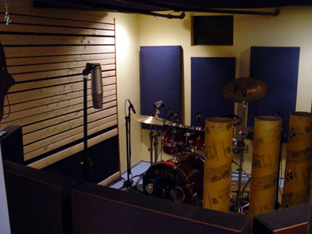

I am almost done finishing my drum room 12ft -14ft - 8ft
It is sounding really good .
The 12-14-8 room won't have quite as bad a modal problems so would probably sound better for the drums, plus that's kind of cramped for a CR - I wouldn't change them around... Steve

Whats with the round tubes in front of the drums? What does that do for you?
It is a project I working on
On I/3 of the surface I am cutting ½ in holes, then wrapping the whole tube in batting and covering with fabric. Then filling with insulation and sealing them up.
Then mounting then on old music stands so they are adjustable.
One side is absorptive and the other side is reflective
I have made a lot of different types of gobo’s and these will just be more portable, adjustable and look very cool.
I am using foundation forms that I bought at Home Depot
They should be a lot like Tube Traps I can post work in progress pic's I any one wants to see
