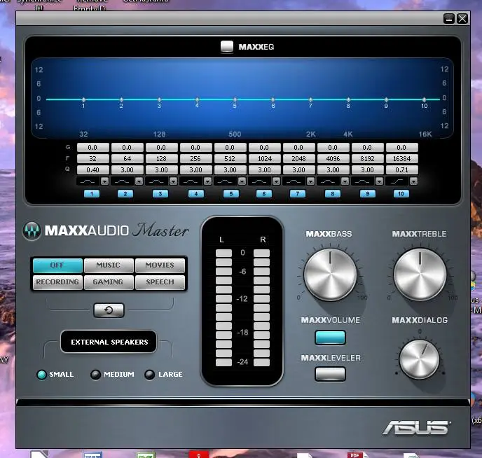

Has the computer got any software associated with its audio that can muck up the sound? Screenshot of my PC's audio software that can make things sound bad...
