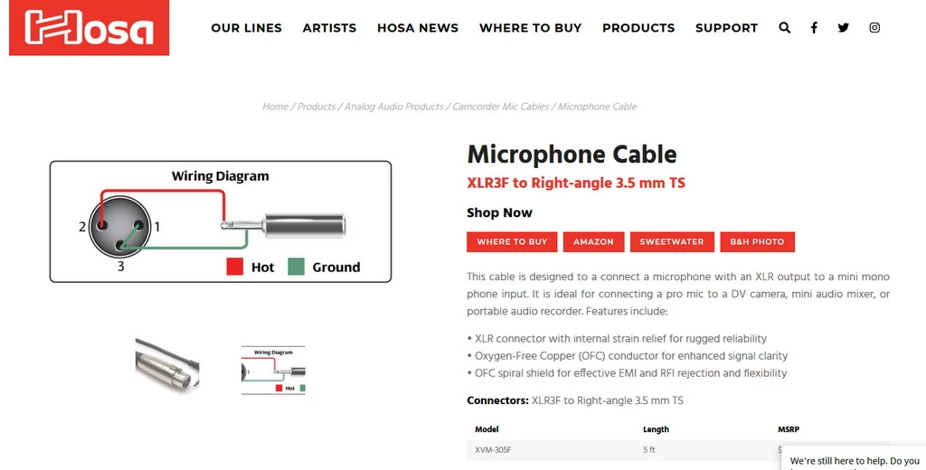

I have used the cable linked below into a computer with a Shure SM57 which has a similar sensitivity to the PodMic, but the mic needed to be close to my mouth to have decent levels. It may work, but not at the best the PodMic could likely be capable of. Cheap enough to try if you really don't want to get an interface.
Hosa-XVM-305F-Camcorder-Microphone-Right-angle (other cables may work, but the connection needs to be made from pin 1 to pin 3 in the XLR connector. The HOSA I know has this)
