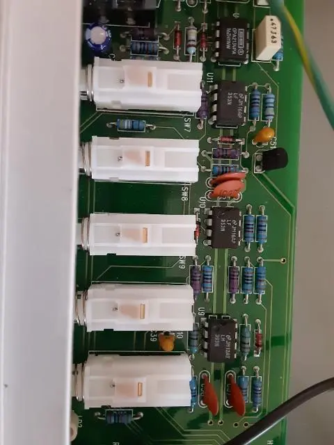

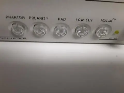

APHEX 207 dual preamp 19" rack.....great unit...but.....the weird buttons were really "sticking" and not popping back out.
The sticking buttons appear to be spring loaded. They were unable to easily switch from ON to OFF.
Theres 10 of them! and only a few worked ok.

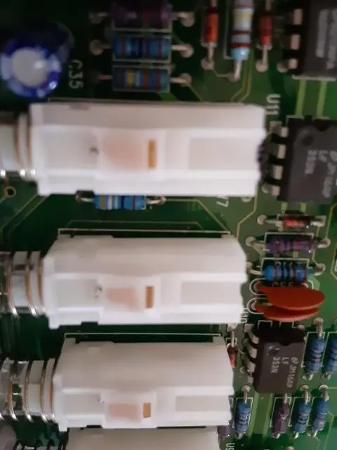

Reviewing deeper, the brand is a WB Electronic switch.There wasnt much to see in the switch, its encapsulated. A push button with a Spring. the springs were not able to be changed out, replacing the switches seemed a lot of soldering!! for 10qty switches each with almost 10 pines each!
Being a mechanical switch I thought getting some fine oil on the plastic moving switch could help. But light amount of oil didnt work.
I then thought to really swab it up with oil, using a tiny fine model airplane painter brush and fine oil, I soaked the oil , brushed on the oil to the white plastic switch, focusing on the slides and the tiny hole on the top and cycling the switches many times and re-applying oil has them working like brand new! So did all 10qty were re-lubed and unit put together.
These type switches are also found on some Fender Amps per pictures. On/OFF, Double Throw /Single pole etc.. so this procedure to oil switches might help someone?

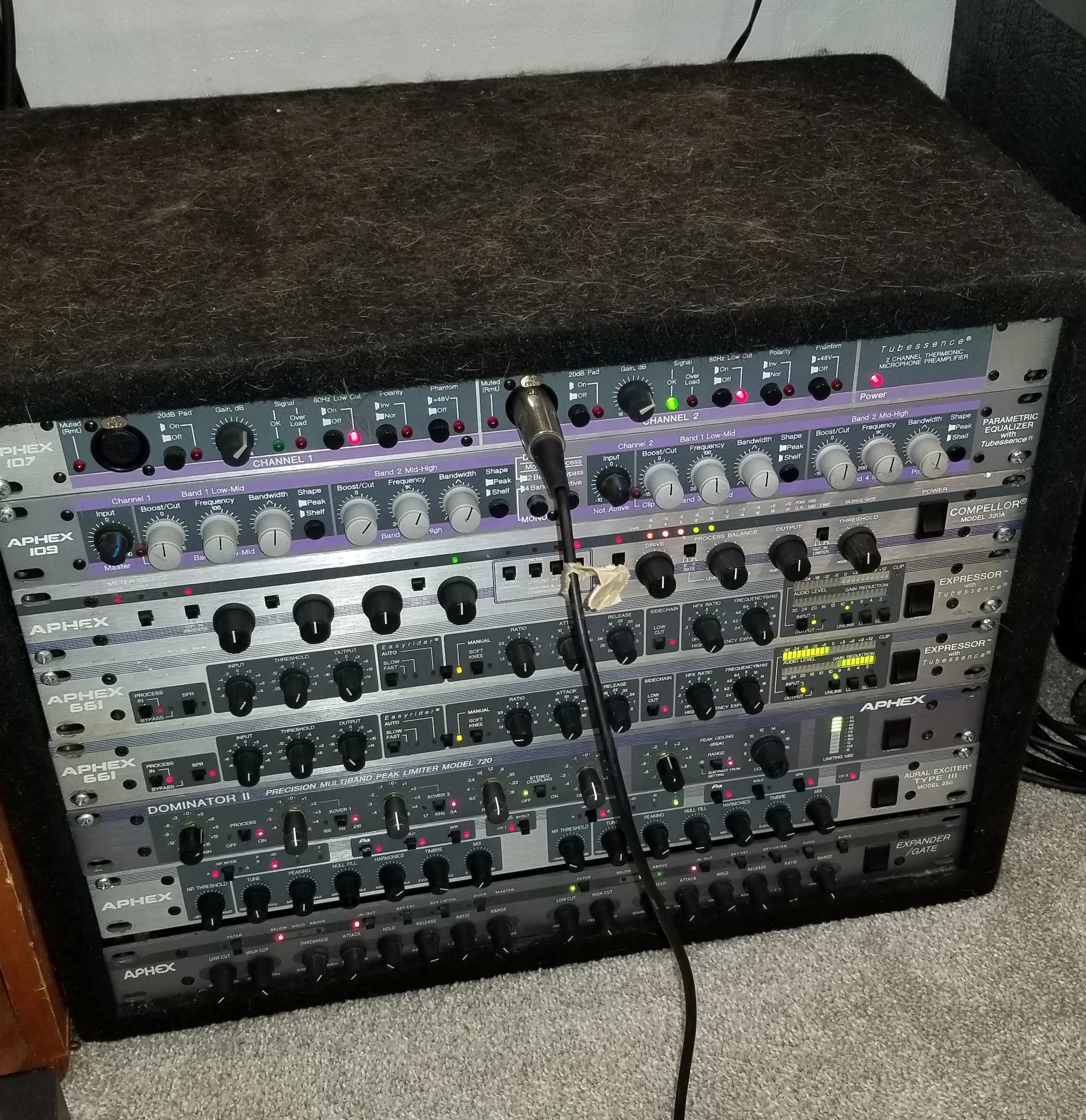

Aphex rack gear from the 80's was what they used at the TV studio I briefly worked. The whole package works together and is so transparent. Pro grade. Does +8 for the station. Heavy aluminum rack chassis. Transformerless. Amazing stuff that was ahead of its time and is waiting to be rediscovered.
Aphex 107 tube pre
Aphex 109 Tube parametric 4band
Aphex 105 gate
Aphex 320 A compellor/ compciter ..makes the buzzy voice with the 'drive' knob / auto-compressor
Works great together as a complete channel. Try to get the whole thing, they are relatively inexpensive now a days.
It does have a nice sound and for the prices good deal. I was reading albums the aphex was used on , seems Linda Ronstadt and others was in the article.
Interesting picture, Ive never seen the 109 EQ, ...very analog vibed... aural exciter. compressors I think I tried a bit.
Nice two channel rack probably ready for direct to Tape, no plugins needed!
The 109 is from the tube essence series and is a Parametric. It does more than a standard retractive EQ.

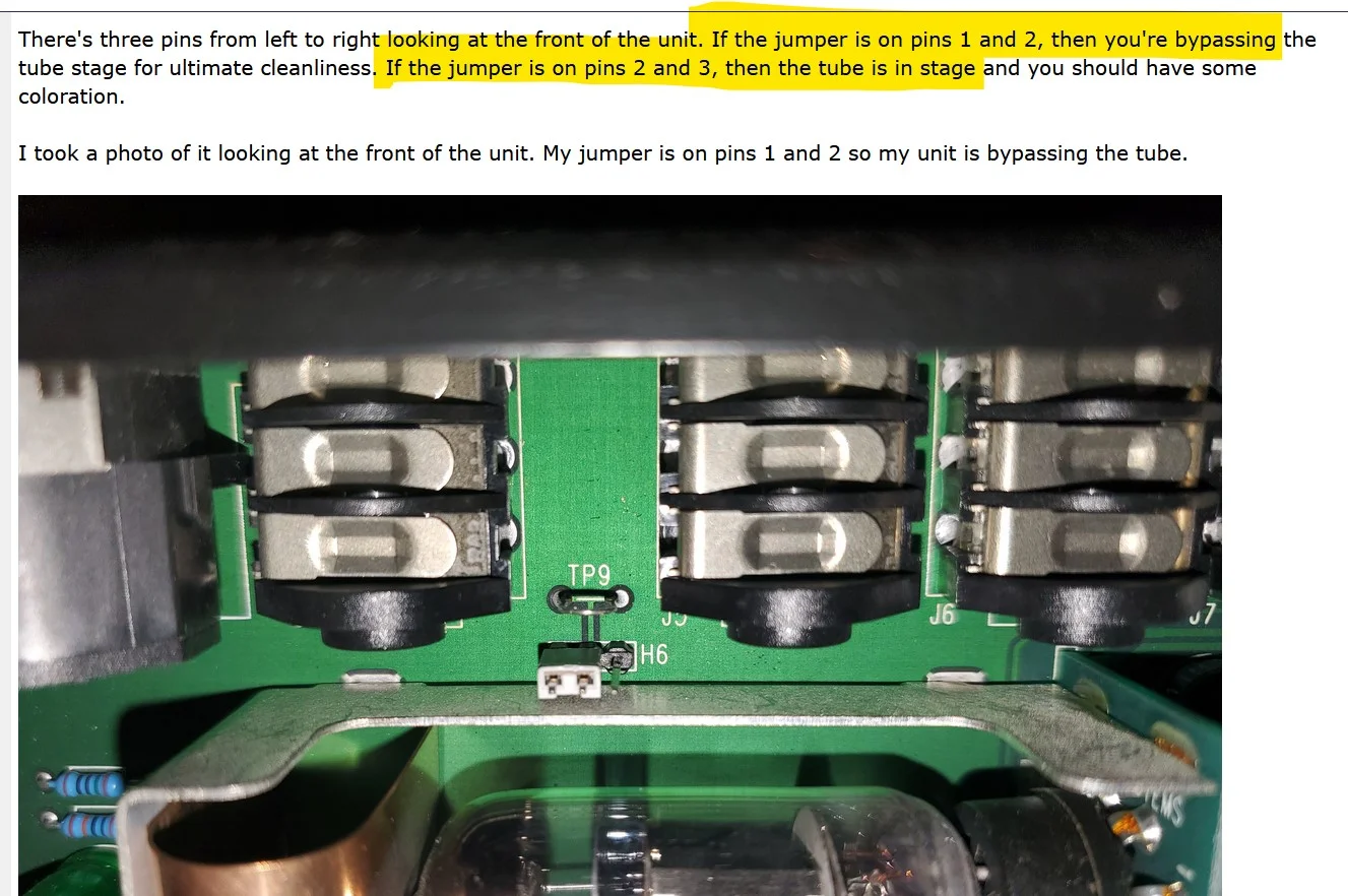

On the Tube Essence stuff there is a jumper to defeat the tube circuit. Just lift the lid.
All kinds of cool little tricks in them
very cool info, never heard that before about the jumper. they were ahead of their time!
now UA710 and others offer "clean IC or sparkle-tube tone".
Nice troubleshooting tip!
I opened up the 207 but no jumper, however, the INSERT OUT is pre-tube, so that's an interesting tip for comparing
"clean IC only" vs the "tube Reflective Plate" output. :guitar:
