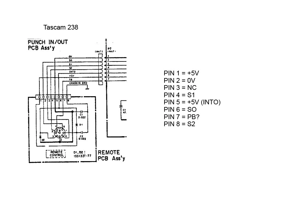

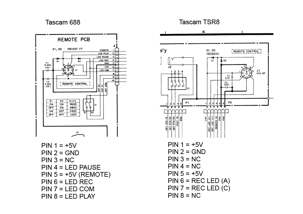

I've had a look at the schematics for the 688, the TSR8 and the 238. They all have the 8-pin DIN plug and if my interpretations of the schematics are correct, have the correct voltages on the pins. Anybody have time to verify this on the schematics I've uploaded? Thanks Al
  • remote control schematic  connectors for Tascam 688, TSR8 and 2381024_1.webp
  • remote control schematic  connectors for Tascam 688, TSR8 and 2381024_2.webp

My TSR-8 came new with an RC-408. Aside from other compatibility issues, what makes this one different than most other Tascam remotes I have is that it's a round, 7 pin DIN style connector. Most of my other, older Tascam machines use remotes with an oblong connector, like the RC-402 that my BR-20 uses. The RC-88 I Googled up looks close to the 408, but not exactly the same.
It's actually 8 pins
If they're electrically compatible it might be worth trying, but there's no guarantee that they're using the same serial protocol. Especially since they have different numbers of buttons. If it works at all you will probably have to figure out which key does what by experimentation, and make up some labels.
If you just need simple controls like start, stop, record, play etc it might be better to get or build something that uses the parallel remote since the protocol for that is pretty straightforward.
For what it's worth, the RC408 doesn't actually give you any feedback for more complex things like arming tracks, so you may as well do that on the deck itself to ensure that it actually worked and is about to do what you think it's doing.
Thanks JP. I seem to remember you have a TSR8 yes?
Yes. I still have the RC408 but I'm not using it a lot at the moment. The buttons were always pretty flakey, probably needs me to open it up and clean them. These days I usually just use the automatic punch in and run to the other room.
Late to the party - I did use an RC88 with my TSR8 - some of the buttons are different, but I don't remember which ones. Basically, you have to remember which button does what... More frustrating than worthwhile.
