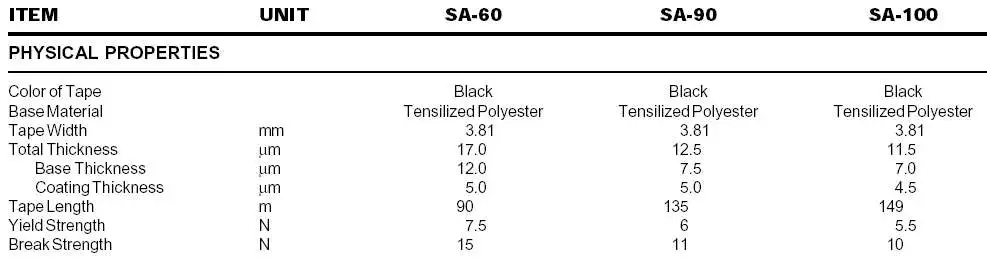

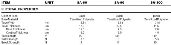

Going back to the original Portastudio 144, TASCAM recommended 60-minute tape because it’s thicker and therefore less vulnerable to stretching, and has less print-through. 60-minute is the cutoff. Everything below that is the same thickness. 90-minute is a bit thinner and 120-minute is just plain too thin and not recommended.
Stretching disrupts the consistency of the oxide layer, which results in more frequent and longer dropouts over time.
That’s the main reason for shorter tapes. Another reason is if you just want one song on each tape.
At the typical double speed of a cassette multitrack 60 minutes gives you about 15 minutes of record time. If someone is troubled by leftover tape they can use 30-minute tapes for about 7.5 minutes of record time. There seems to be little to no cost advantage to buying tapes under 60-minute. Shorter tapes are less common and may be harder to find. Hopefully 60 or even 46 minute will be around for a while.
90 or 100-minute tapes are fine for listening, but the process of multitrack recording demands the shorter (thicker) tape for best results.
Looking back, I think careful tape brand selection, using C60s and a regular degaussing and cleaning schedule are a few of the reasons my cassette compositions didn’t sound like they were done on a portastudio. It is a delicate format, so every little tweak makes a difference.
.........Yup :)

Nice info!
Thanx!..............;)
PS: Another side effect of tape stretching would be to induce a subtle wow into the program material. ;)
