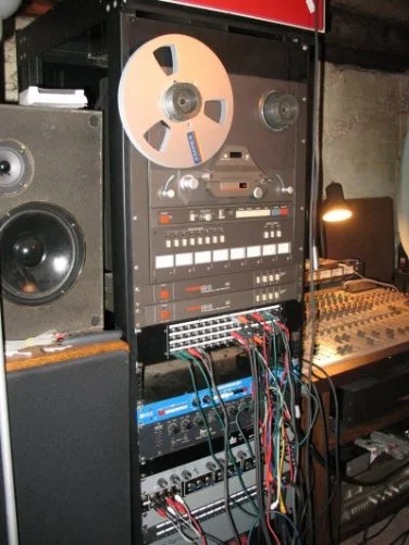

I've posted pictures of my custom cabinets for my Tascam 80-8 and Teac 7300 in the past, but don't mind posting them again for your enjoyment. Everyone always likes the simplicity and functionality of the design. ;)
Seriously, though, the main thing to consider is that the reels clear everything. I would build a 19" wide space above for the machine (with room for reel overhang) and also a 19" wide space below for future rack mount equipment.

This used to be a straight-front equipment rack that I modified for use with my 38.
After cutting the front at the angle you see, I moved the rack rails forward to flush mount the equipment. I also cut the rack rails to fit only the sloped area.
The left over rail I used to make a seven space equipment rack.

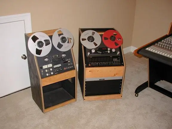

I made these myself and I'm really not to good at wood working. If you can handle a saw and a screwdriver, maybe you can make your own over a weekend. The rack and tape machine stands have nice wheels on them (hard to tell). The one with the Otari holds tape on the bottom and the other one can hold 19" rack gear. Got everything from Home Depot and didn't cost too much, they work fine and look pretty cool (I think!). Hope this helps.

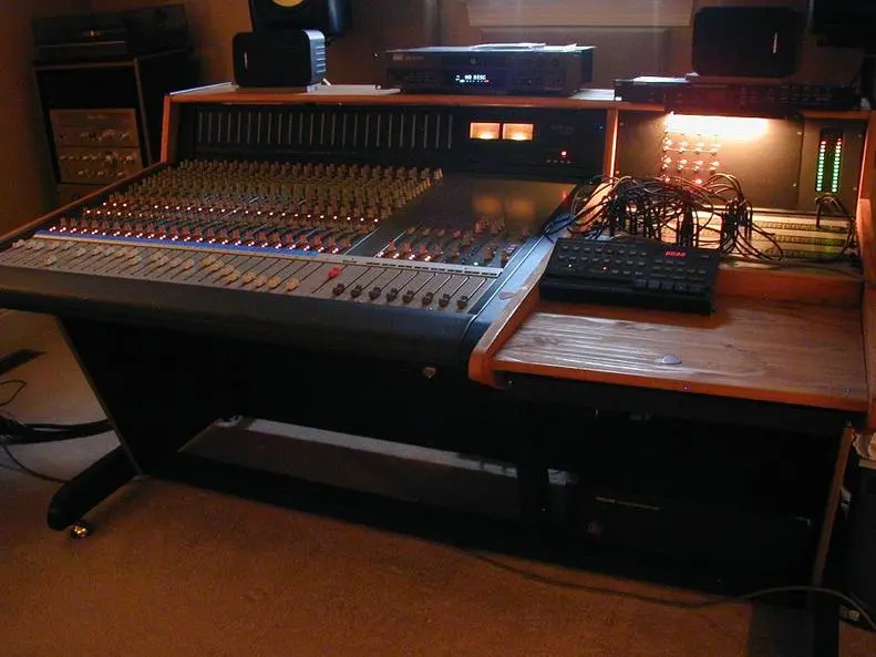

Nice desk! What kind of mixer is that?
Mixing Desk
Hi, it's a Tascam N3500, 24x8 mixing desk. Got it about 2 years ago and it's a perfect match to the Tascam MSR 16. Thanks, appreciate the comment! Jerry.
Really sweet ideas and work. This is what I'm looking for. I don't want to re-invent the "reel" here and it's good to see some ideas. I also don't want to spend an eternity on creating a masterpiece only to have it not quite user-friendly.

VERY nice work, Jerry. Yikes, I'd better clear the crap offa my drawing board and jot down some ideas I'm getting ready to steal from all o' ya'll.

Nice pics, Gerard. Where did you obtain the table/enclosure for the large mixer? And is that a vintage Sansui receiver I see I see in the pic, looks like a G series model.
I have a Tascam M-512 mixer, and I'm looking for a good pedestal-type table for it. Back in the mid 80's, Tascam offered the CS-512 and CS-513, (as seen in the operating manual binder) but they are long discontinued.
The 512 is about 32" wide and deep. The width is not a problem, but most tables' depth are 30" max. Rather than Raxxess and other well known suppliers, I was looking at various catalogs of office furniture/computer workstations, and was thinking of the WSG-3060 with optional accessories of caster wheels and riser shelf (and either oak or cherry, not blue :)

Really nice work! :)

Thanks for the comments gents. SteveM, my console is a M3500, not "N" as stated in my post, lack of coffee, sorry. Beatlefred, i just made plans to fit my needs. I'll see if have some shots without the board on the stand, maybe you can get a idea or 2 from the photos. Again, I'm not a wood working guy and I tried to keep cost down by using plywood and pine. But it does what it's supposed to do: hold up my board, the power supply and patch bays!:D
Also, the gear you see is part of a very old Technics stereo setup, no plastic, all aluminum. I have the whole set, most in storage. The turn table (Thorens) is wired to the pre amp section and the output of that is tied to my patch bays. Just so I can listen to records through the "system".
Jerry
