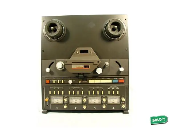

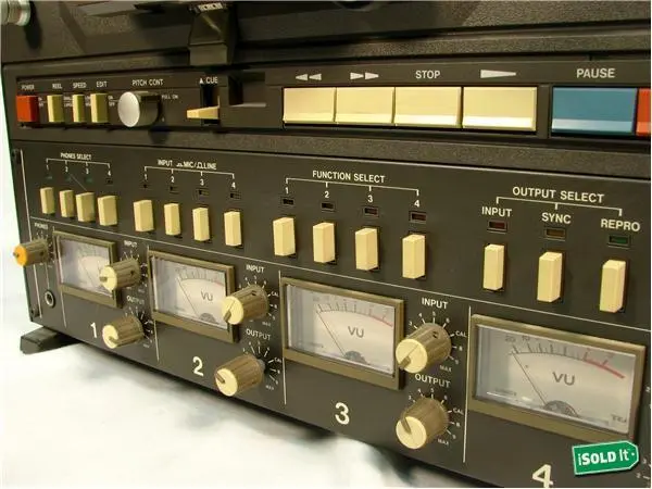

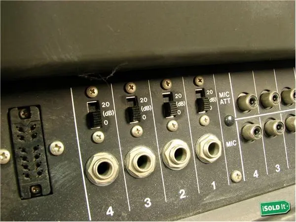

However, the only 4-track reel/reel that I'm aware of that has mic inputs would be the Tascam 34B, so I'd suggest finding one of those instead. It's just like the 34 in the transport section, but with an added (4) mic inputs, In/Out level controls, and a 4x1 mono headphone amp, built in.
See! You were very close by choosing the 34, but you'd want the "B" model, which gives some handy upgrades to the 34(std).
See: Tascam 34B
Tascam 34B, back.

Tascam 34B, connectors.

Tascam 34B, controls.

Whats with the 1/4" mic inputs? Are those high impedance?
From the 34B manual:...
"Microphone Input - 1/4" phone jack accepts unbalanced signals from any type of microphone having any impedance from 150 ohms to 10K ohms."
