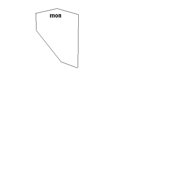

Hi Tony - Welcome to the forum. I'm not sure what you mean by "ambients"... can you explain it better? Also, a drawing of the room layout will help.
Kevin.
By ambients I mean that there is a minor reverberation off all the drywall and hardwood flooring. Not good at all for mixing.
Trying to figure out how to submit a drawing.
TK
Here's a crude drawing. MON is where my monitors are.
Also, what I'm looking for is a cheap way to deaden the room.
TK
