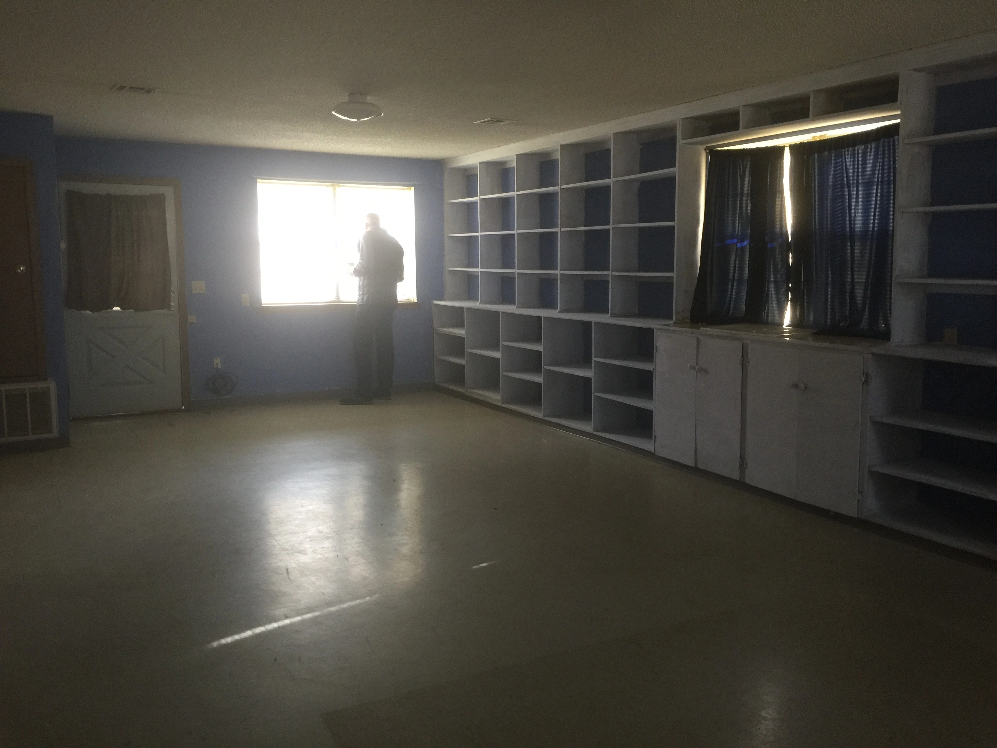

Alright..... I'm in a bit of a pickle.... I've got this pretty cool room you might have seen before....
The problem is, it is very echoey. Very very echoey!!!!f
I woefully overestimated my budget to get it ready to record in by the month of February because my budget ends up being ZERO dollars American.. I just record for myself, but would like it to sound the best that it can.

Leave the floor hard...but you'll need absorption on the walls and ceiling.
Noting in your list will really do much of job....you need some traps.
It's gonna take a few $$$...but you can make them yourself, and for a couple hundred dollars, have enough material to build a decent number of traps.
Do it right as much as you can...otherwise you will just be fighting the room.
Thoroughly treat one corner of the room and get/build a couple of goboes. Use the goboes to enclose a small dead area within your large live room. You can move things around to dial more or less of the live part of the room into the recording.
Excess room is only a problem if it's in your MIC pattern
And usually even then only if it actually sounds bad.
I'd be willing to bet that once you get some furniture (like couches and stuffed chairs), throw down a couple area rugs, and fill those shelves with stuff (!!!), it'll probably be alright for most things. When you have some money to throw at it, do work toward trapping and/or goboes, but if your budget is $0, then you just do what you've got to do.
...But this is also going to be a mix room, which is a bit different consideration from tracking. Near field monitoring at reasonable levels is kind of specifically meant to take the room out of the equation. The sound from the speakers will usually be louder enough than the verb that you'll be okay. The first place you'll want to do "real" absorption will be right around the mix position - the old thing about first reflection points, ceiling cloud...
Well, with acoustic guitar, I just aim across the guitar down to the carpet - the angle at odds to any normal wall ceiling reflection and it's not often I have to add a foam or whatever to block something. What room do we hear with the MIC off the cone and the guitar amp blasting away(though, it wouldn't hurt cleaning that up) ?
This ^^^^ is where I'd start. Not to disagree with anybody else's suggestions, but things change quite a bit just getting the stuff in the room. And I know Miro said leave the floor hard, but do you have a large area rug or carpet scrap to throw down on the floor to try? I find that effects things considerably sometimes. And don't try too hard to make it dead. I agree this is more critical with mixing, but with near-field monitors and maybe that mattress behind you it might be just fine. I like a room with character. I've got the opposite going where the bedroom my drums are in is very dead just due to size, odd-ish shape and thick carpet...low-ish popcorn-texture ceiling. It's pretty dead and just doesn't have anything to offer the mix. I like to run my Radio Shack PZM mica I have with the custom preamps from Uneeda Audio out to the living room or something just to get some space in the mix.

Don't get too hung up on the character of the room. That's my opinion. The space in which you record can really be another instrument in the band so to speak. Have fun experimenting with different mic placement and source placement (i.e. you :D). It's a whole new palette you didn't have when mobile.
I watched the documentary Sound City recently. I highly recommend it. A tiny blip of a point in the film was about the recording room at the studio...the dimensions and shape of the room should have made for problems...by acoustic design standards it shouldn't have sounded good...it was a converted factory, Sound City. But something about the room (who knows what) and that Neve mixing desk, well, it was good. Really good. And you can hear it in the pile of monster hits that came out of Sound City. That anomaly of a recording room was part of the ensemble. Embrace the room. This doesn't mean legitimate "problems" can't or shouldn't be addressed, but maybe wait to decide what really is a problem, vs maybe that "something" that makes what you produce absolutely unique to you and the offspring of Redneck Sound.
TBH...I only said that because all the acoustics guys say it's better to leave the floor heard and treat the walls/ceiling.
Most pro studios have the hard floors...though they also toss rugs on them often.
That said...my studio space is half carpet...with wood only at the console/mixing area, but I also have a lot of wall treatment there.
Where the carpet is, I have mostly wood on the walls, some sheet-rock, and I treated the ceiling to lose the flutter echo.
Could you (or someone)explain this??? I really like to use my condenser mic when when recording the guitar, I think it sounds so much better than the acoustic pickup. I've been using the acoustic pickup the last couple of years, but would like to use the condenser more (or exclusively).
It really just means to use the microphone's polar pattern and proximity to the instrument to minimize the impact of the ambient space. Essentially, use directional mics, point them directly at what you want to record, and get them in as close as you can.

Dude you got it made. You got a nice size "live" room. Others wish they were so lucky.
Like stated before, furnishings, etc will help to tame things a bit.
