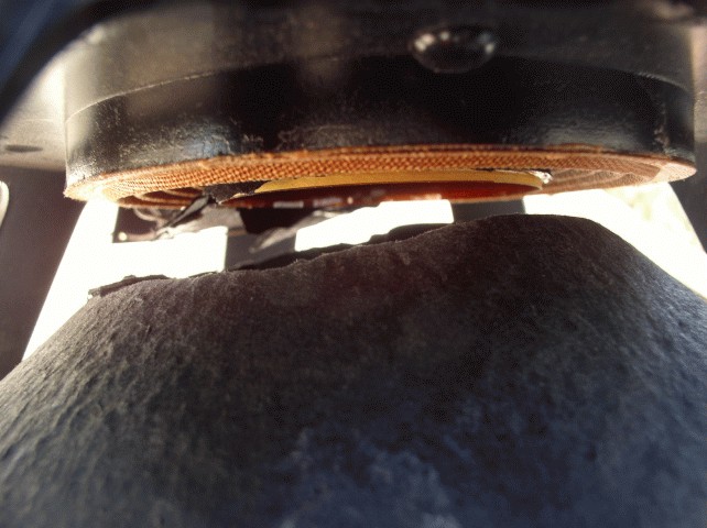

Here's what too much voltage can do in an instant:

Speakers all become rapidly less able to handle voltage below some frequency. To reproduce lower frequencies the speaker has to move more air, which requires it to move farther back and forth. If you try to make a speaker reproduce sound below its cutoff it can quickly run out of room to move and the parts will break. But even above that frequency too much voltage will cause mechanical failure.

That depends. If you way overpower the speaker you can pop it instantly with a low frequency transient, as I did with the one in the photo above. If the amps are about right for the speaker then you'll have to run it into clip for a while to overheat the voice coil, and that would sound bad.
