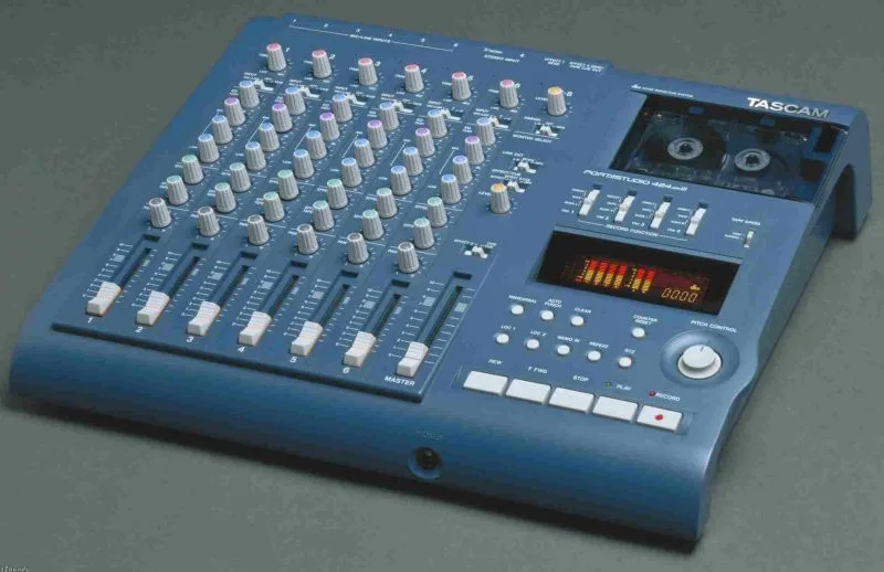

It's a Tascam 424mkIII Portastudio, w/built-in mixer.
8-input, 6-full channel strips, 3-band EQ w/mid-sweep, 2-Effect Snds, Cue.
