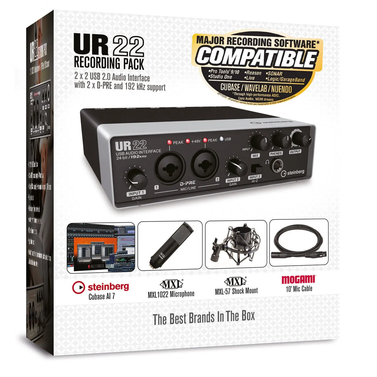

Do you think this this package a good starting point?
Morning SiriV and welcome.
The UR22 is a fine interface and would, in the ordinary course of events serve you well. I have no knowledge of the microphone but most are very usable, maybe a user here can comment?
If you catch a slight reservation in my tone it is because I would ask, "do you intend to record voice and keys together"? If so you will need an interface with two more line inputs. Yes, you could have mic on one channel and one channel of keyboard on the other but its a bit of a kludge and you will lose any "stereo" qualities that I am sure that stonking piano has!
So, we come to my personal favourite AI, the Native Instruments Komplete Audio 6. You still get Cubase DAW software (none better for MIDI work. Don't forget to pick up a pair of DIN MIDI cables) . Not only does it have the extra pair of balanced line inputs you require but can download a version of Kontakt Player and about 3G of samples. It also has the lowest "latency" of any AI in its price class and several above it.
Even if you intend to record keys and voice separately, having everything plugged up and ready to fly is surely worth a few $$$s?

Thank you! I would normally record vocals and piano separately, but sometimes it's nice to record it at the same time as well so it's good to have that opportunity. I looked up the link you sent, and I think that would be perfect! It's also really good to get recommendations from people who have more knowledge about this than me, so I think I will buy that one.
And yes, the Roland 700gx has a pretty amazing sound, so it would be a shame not to capture that in recordings! I've also looked at different microphones now and found that Røde microphones often are recommended for good quality home recordings. I'm considering NT1-A or NT2-A at the moment, but I'm open to hear other suggestions.
So, my shopping list this far looks like this:
Native Instruments Komplete Audio 6+ Cubase software
Røde NT2-A+shockmount and pop filter
KRK rokit studio monitors (I need new studio monitors for my stage piano anyway)
