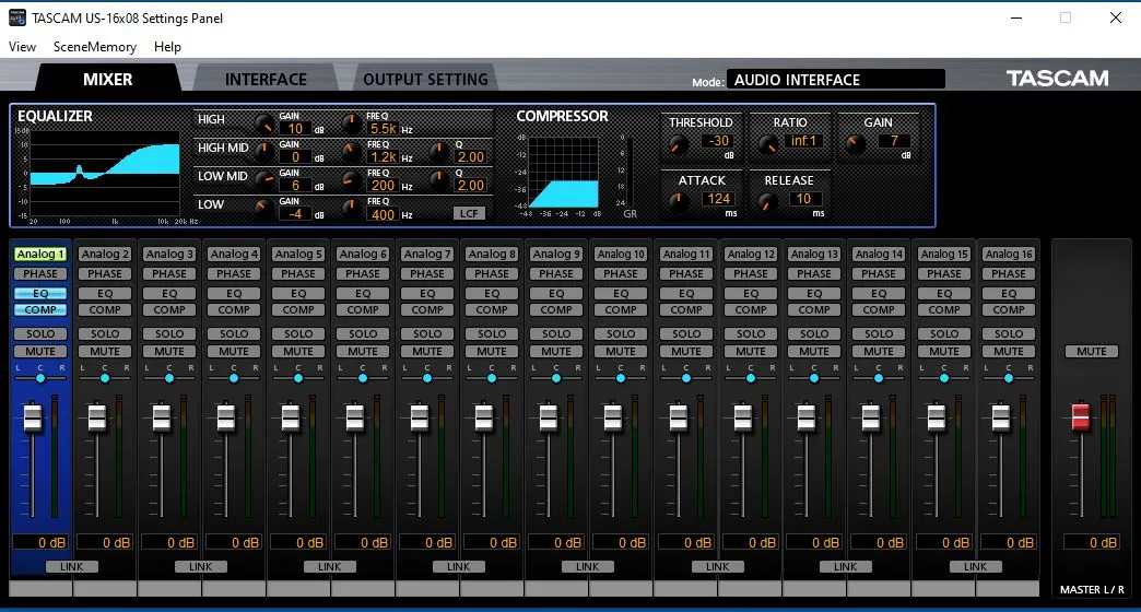

An audio interface will convert the audio signals into digital inside the device, and then feed that directly to your computer. When you set up the device as the source of your inputs, then you will find you have multiple channels. You can get an idea how things are routed with an audio interface from the attached screen shot from my Tascam 16x08 interface. You have 16 channels of digital audio available, 8 from microphone preamps and 8 from line or instrument inputs. All 16 channels are available at one time, and its already in digital format.
