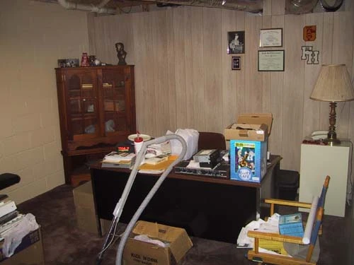

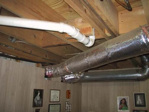

ok, here is the ceiling, and the room showing both types of walls. (its all cleared out now..and like i said, the flourecent light is gone, so no prob there. thanks!
really would like some ideas about the ceiling....if it is going to mess with my sound being studded like that -...i figure foam on the walls will take care of a lot.

and, the walls

I would fill the ceiling joists with insulation and hang acoustical tiles below your pipes. This will provide dead-air space to help with isolation.
As for the cement walls.. attach 2x2 strips every 24" and use 2" rigid insulation in between the 2x2s. Add paneling or drywall on top of that.

Personally, I'd be more worried about those two walls first.

cement first...gotcha.
well, I have a large amount of foam I can use in addition to the acoustic panels I have....
will that help? on the cement walls?

Suppari is right on about how to handle the cement walls. I might even take it a step farther and attach resilient steel channel (available at home depot) to the 2x2's. Then, attach your drywall to the steel channel. The channel is pretty inexpensive so it shouldn't add too much to your total cost.
In my last house, we finished the basement ourselves and used steel channel on the ceiling along with a nice think isulation (can't remember the "R" number... sorry) it really isolated the noise between the basement and the main floor. It was awesome!
