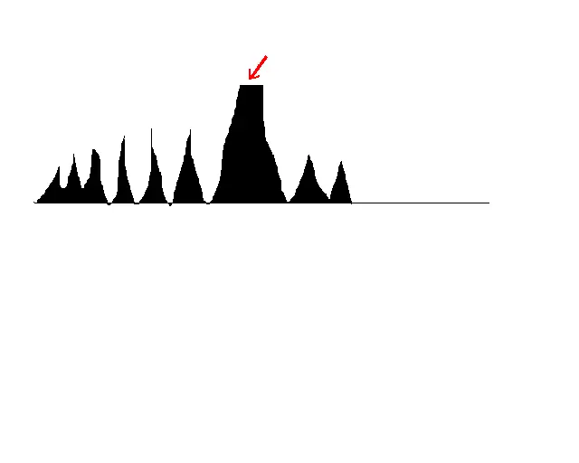

I have a cheap Shure 55SH, a Soundcraft Spirit M12, and a PC with MAudio Delta1010. I'm trying to record a vocal track on SONAR 2. I get a lot of this:
attached: wave.png
That flat spot on the wave is where the meter on SONAR goes all red, and there's nothing but a buzz on the track. I try, but I find it incredibly hard to find a happy medium so that all the quiet vocals have a lot of body and sparkle while the loud vocals don't do what they did here. What's it called?
Anyway, how do I set up the microphone where I won't get this? Do I need a different mic? I set the fader to unity, and talk into the mic while I increase the gain until it's almost to 60 dB. Is this wrong? Is there a method in software to make the flat spots sound OK? I tried the limiter, but it just makes the entire track quieter, but the flat spots are still flat.

I'm not the greatest person for advice, but try a compressor maybe so that it can't peak to a certain level?
The way to set levels is to sing the part as closely as you can to the real performance and set the gain so your loudest parts do not clip. When you are setting instrument levels do the same. Be sure to check the bass notes because they are usually the strongest.
Proper mic technique is a big part also. You need to work the mic like it's another instrument and get up closer or move back farther away as necessary. Just make sure that the overall sound doesn't change too much. One of the problems of recording in a poor sounding room is that as you get louder you hear more room sound in the background that wasn't there for the softer parts. Only acoustic treatment of the room can help that.
Is that a screen shot of the real wave form that was recorded?
Having a cheap mic to record vocals is no help usually. Cheap dynamic mics will exibit some strange behaviors when tracking dynamic vocals.

Cheap mic, screen shot...
Yeah, it is a crappy mic. I'm going to try using a CD played into one of the channels and recorded through the mixer and soundcard to rule out the expensive components.
No, that was not a screenshot. It was just a diagram. But on the loudest parts, the waveform "goes off the scale", and the sound is muffled and dead.

You need a compressor or limiter in your vocal recording chain. These are the times when software alone can't cut it. You are clipping the soundcard, and once that's done you can do NOTHING to fix it afterwards. Go Buy an RNC, or a Behringer Composer Pro, or an 1176;).

The preamp has very little to do with it and in the case of soundcraft M series they are generally considered superior to the mackie. Some preamps will distort earlier than others but your problem is on the preamp output not the input. You are distorting on the input of your soundcard and with digital there is no such thing as 'headroom'. Once you pass 0db you are screwed.
I have never in 15yrs of audio work had to track with a compressor or limiter. A good mic will definately help if you can spend some cash but the most important thing is to set the level accordingly and use proper mic technique. Relying on a limiter for proper levels is just being lazy and with the low noise floor of digital gear there is no reason to have to push your levels that close to the ceiling.
chewmanfoo said:
That flat spot on the wave is where the meter on SONAR goes all red, and there's nothing but a buzz on the track. chewy
You can obviously see here your clipping the sound card, whether or not your clipping the pre on your mixer doesnt really matter (well it does....) The Soundcraft Spirit M12 is a solid mixer from what i know, dont know the the max dbu on its inputs is as high as mackies (+22) but either way, its entirely possible to clip the mixer and NOT the soundcard, that wouldnt sound good either just different heh.
