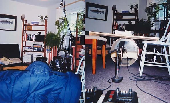

I've done that on a few session and loved the way it sounded. I would imagine that you would get great results using that great mic! You might want to also try builing a tunnel (see pic) if you want to isolate the LDC on kick. This way, I was able to mix in the specific amounts of the beater and the LDC pretty much independently from the whole kit, which is great if your going for that sound.
This method is also great for getting really useable kick sounds for those who only have budget mics to work with (in my case it was a unidyne III shure on the beater, Apex 430 LDC 3 ft out - total mic cost: $95). Usually no eq needed, and the bright characteristic of many cheap LDC's usually usually dont cause problems in this role.
