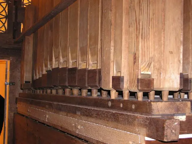

Here's a pic I found of an old fella with wood pipes, awesome.
