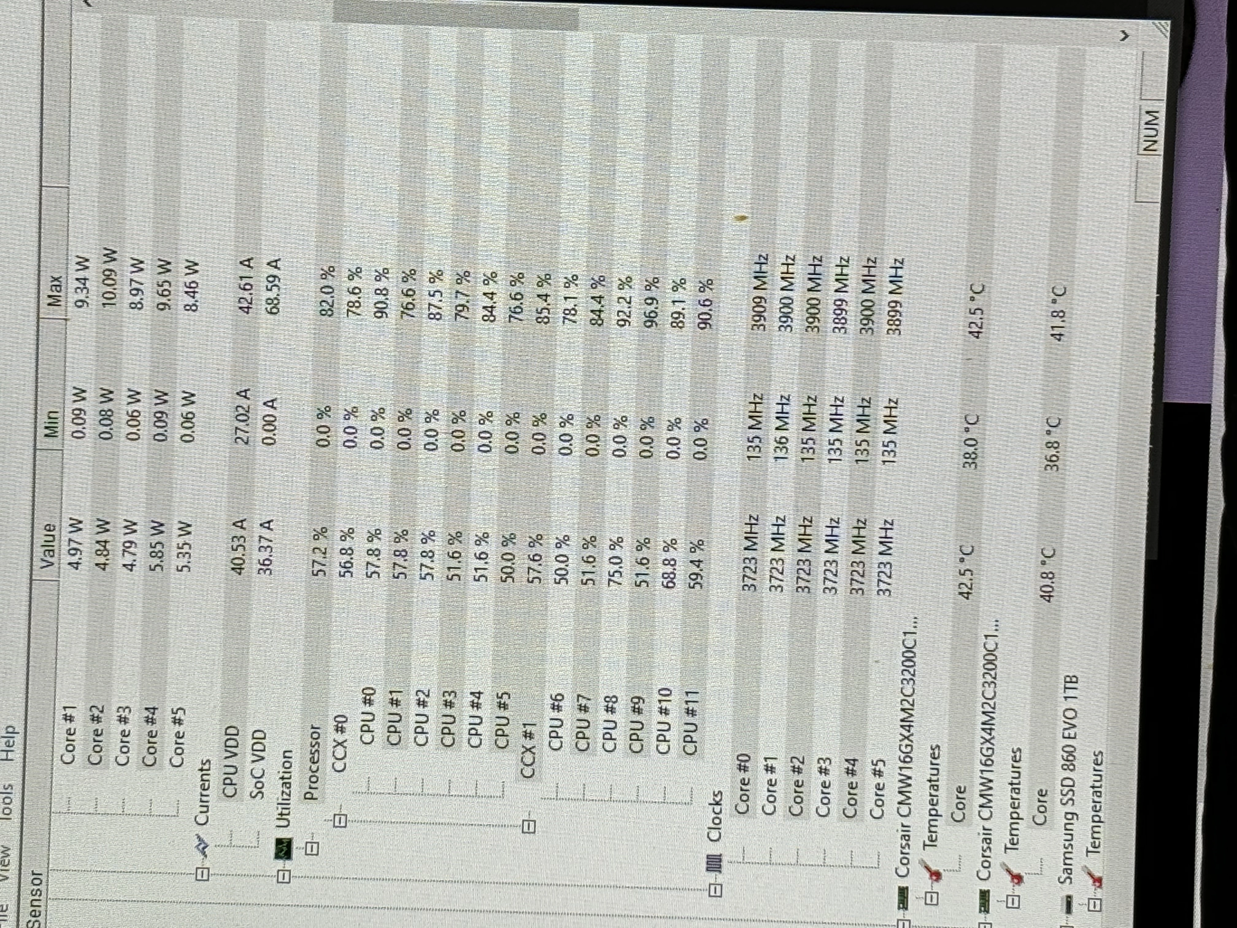

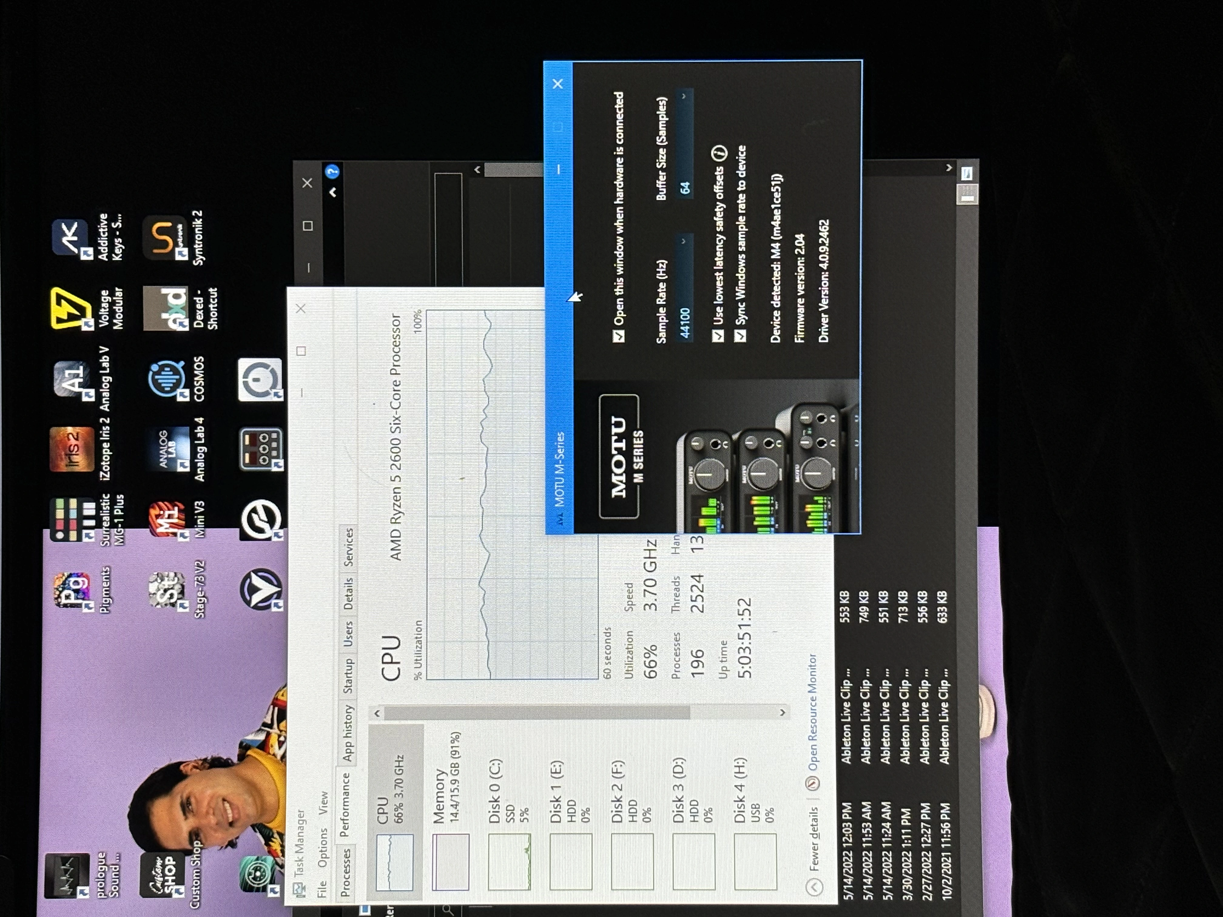

Hi everyone . Right now I started to make more quality music inside my budget. Bought a motu m4. Have a ton of plugins and stuff in ableton. Record my cab with mics and direct line. Etc... Also want to record at least 48khz. The thing is that my PC left behind and the processor and GPU are struggling heavy. Simply I can't record at this rate or have huge amount of lag. Yesterday I bought a new ram to remplace my 16 gb Corsair with a new 64 gb Corsair. Also will change my ssd with a fast m.2 That I bought for my laptop but never use. The question it. What processor I need? I have a cheapo Ryzen 5 gen 2 processor and my Mobo go up to gen 3.

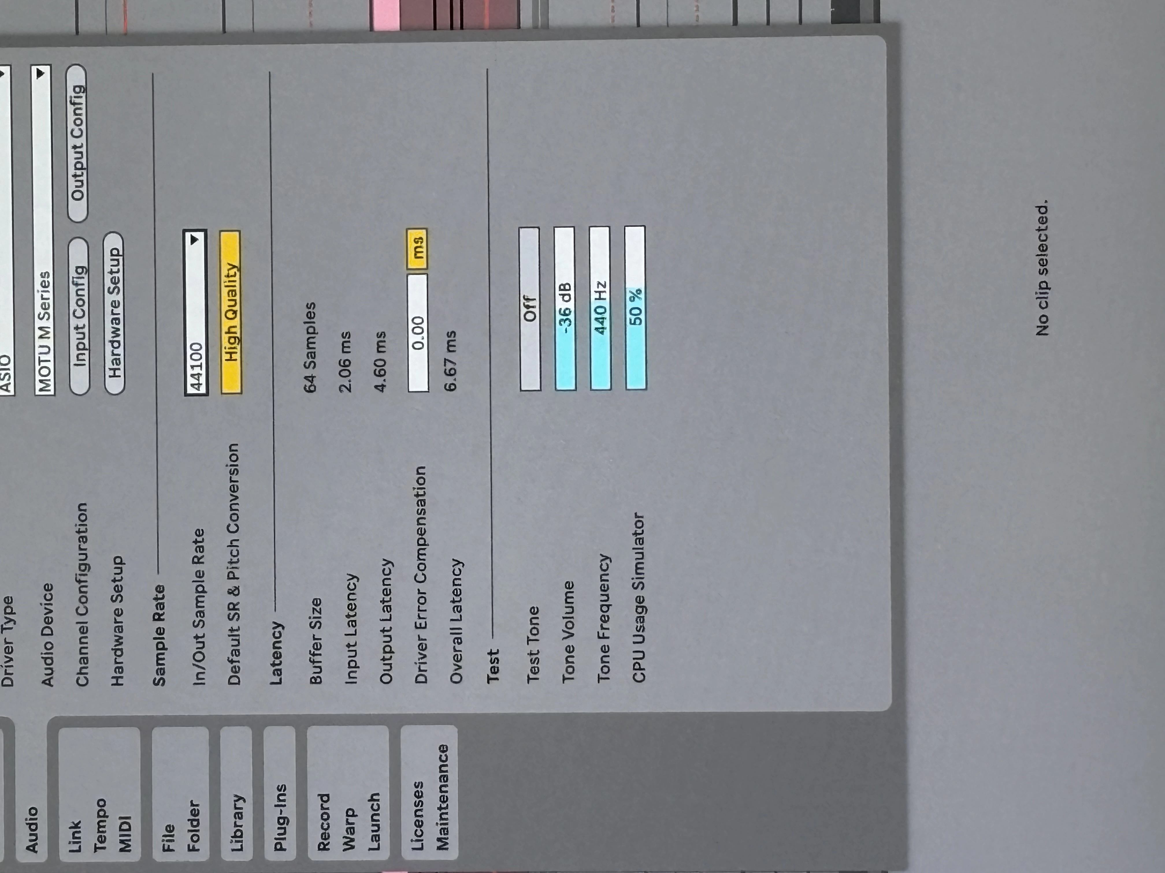

I'm trying to record my songs in high res. I was looking for the highest motu m4 sample rate and less lag but is impossible. CPU gets peaks in ableton. Still not in hwmonitor but is high. Yep I'm using ableton 11 with lastest asio. All I got is CPU peaking all over the place. Of course if I up the buffer size and down sample rate is usable unless you want to record guitar or bass in high res. I mean with big sample rate. I get acceptable lag in 6ms to near 10ms. More than that is a pain to hear the lag of the recording when you try to play the instrument. I see that waves cla plugins and kontakt plugins are heavy on resources. But I left the bass recording last when already have 25+ tracks and CPU can't handle anymore.

As it should be. Don't get too hung up on computer measurements CPU Memory usage etc. Just record it and go from there.
Work backwards if there is an issue. HWmonitor is a great tool, I use it often, but not something I would ever use trying to benchmark a DAW.

Really I want to record at 96khz (the top of motu m4) I open a new project. up sample rate to 96hHz, buffer size 128 samples give me nice 5.52ms latency in ableton 11. at new project without anything I have 3% cpu and memory at 6.6gb usage from 16gb top
recording a guitar with mic in the cab and a drums sample (2 tracks) almost no make any changes in the 3 to 4% cpu load.

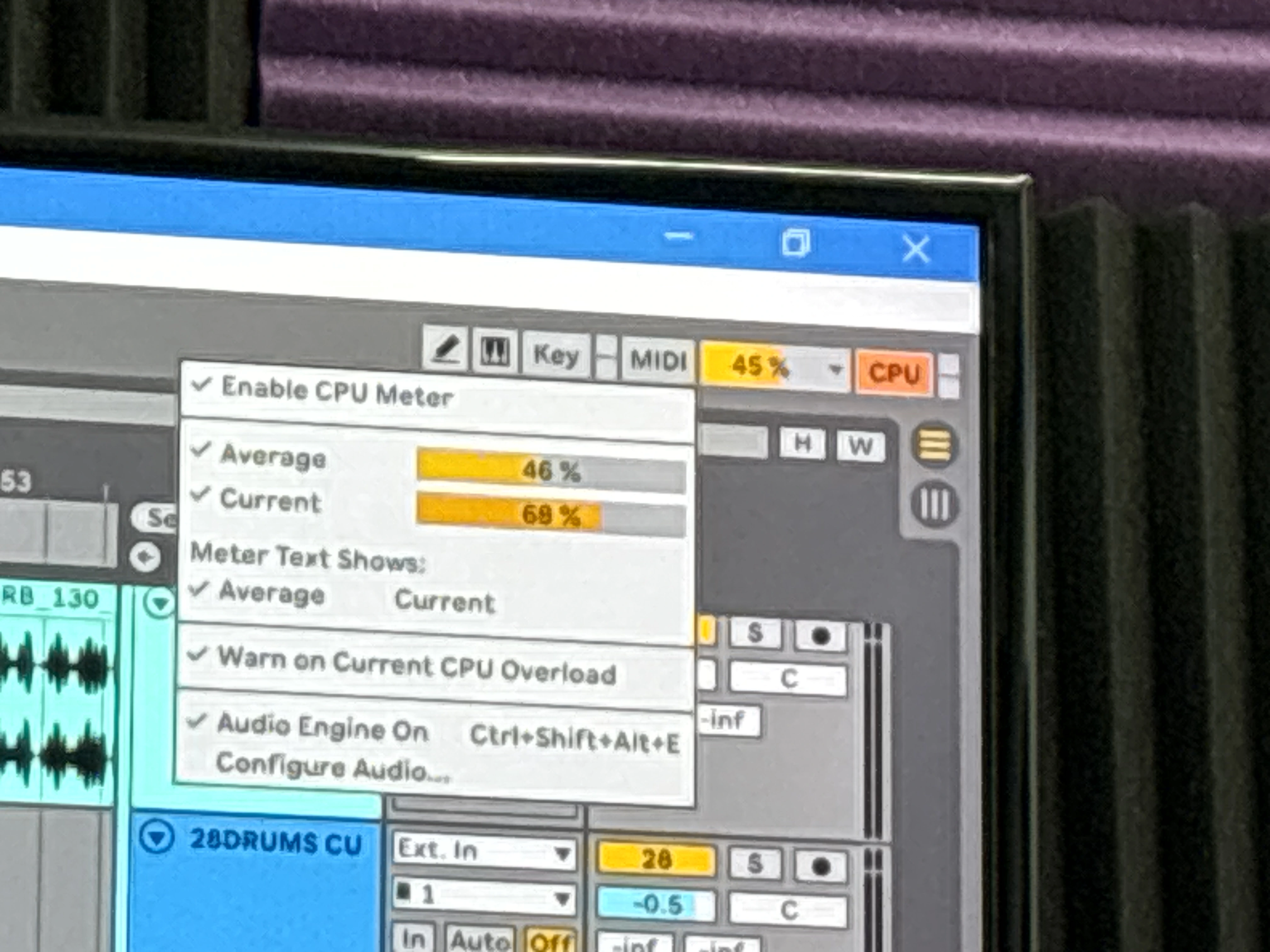

At current project I working I'm really in the mix process but I want to record again the bass and another line of guitar. Right now 30 tracks with most of them flatten I'm getting more than 100% peaks and average of 46%. Memory at 12gb usage. Using from 3 plugins to 8 plugins per track. Really like 2 tracks have 8 plugins. Mostly waves plugins, arturia and ableton.
30 tracks with 3 to 8 plug-ins per track? THAT could well be an issue. If you're talking about 100+ instances that need to be addressed, that's not an efficient setup. Can you combine plug-ins? Something like "don't use 30 reverbs, do a send and use one instance of the reverb".

BTW, you do realize that a latency of 5ms is equivalent to standing 5 ft from your amp. I've heard people say that 10ms latency screws them up. PURE HOGWASH! I would guess that 90+% of the time on stage guitarists stand 8 to 10 ft from the amp. I've stood farther away and it NEVER felt like it was lagging. People get bent out of shape about a number without understanding what it really represents. It's like significant digits in math, if you can only measure to 0.1cm, then there's no sense in writing down 2 decimal points.
I found my answer in this video.
So is a ableton latency problem when is in AUTO monitoring.
That's why I was hearing a tremendous lag no matter the overall latency
