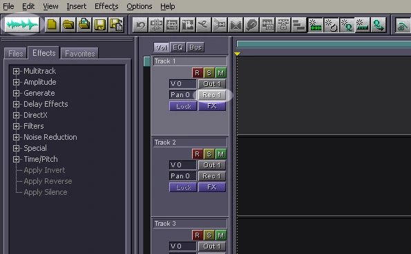

Make sure you are on the multitrack screen and not the edit screen. You can toggle between these screens with the button in the upper-left corner of the screen. On the multitrack screen, each track should have a complete set of buttons and controls for each track. One of these will be the "Rec1" button.
I have attached a close-up of a sample screenshot from my own copy of Audition and have highlighted both the screen toggle button and the Rec1 button.
HTH.
G.
thanks alot buddy...it didnt say Rec1 thats what was screwin me up but the button that was there fixed it...good lookin out
