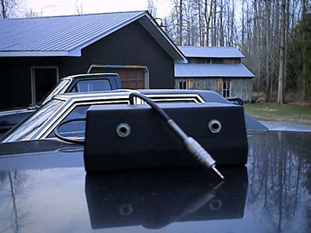

Just so you know what your looking for, it's a stereo 1/8" male, to 2 1/4" female. This would allow you to plug either 1 mic into the left or right of the soundcard, or 2 mics at the same time if your doing some stereo micing. HOSA probably makes one, but if your into soldering, make one. I built one awhile ago for not much:
Project box - $10
1/4" female jacks - $3 each
1/8" stereo male connector - $5
Some decent wire (sheilded) - 6ft of Canare - $6.00
Attached a quick photo of it just to give you the idea.

I'm assuming that's the pre amp in your pic?
You don't know how helpful you have been to me. I think I'm going to ask some of my sound engineer friends about the pre amp
no no.. that's not the preamp. It's just a plastic box. Something you can build if you like. I found it easier when working with 1/8" jacks to have an 'extension' so that I could connect 1 mic or 2 mics at time without having to crawl behind the computer, or mess around with Y cabling.
Stereo soundcards can have 2 inputs, Left and Right. It's nice to have access to one, or both inputs. All this box is, is a glorified splitter. Nothing inside except a little bit of wire.
So you would run your mic into the preamp, than out of the preamp into this box, and then out to the soundcard.
It replaces this item - 1/8" stereo male to 2 1/4" mono female cable.
Not a necessity, just a convenience.
