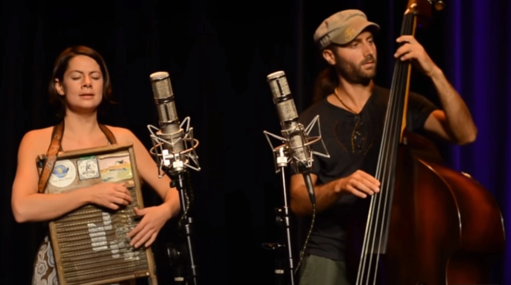

I just watched the video, and I think I see what has confused you and others - in that video we have the guitar sounding nice and clean, but it does have a pickup fitted and the banjo has a volume knob, suggesting it too has a pickup - maybe, but there are FOUR microphones. It looks like a stereo pair, but it is not. I actually have one of those mics, and it is a omni-fig8-cardiod large diaphragm type bit with two capsules, one above the other. The top one can rotate 90 degrees in respect to the other, so you will see that if we assume they are set to cardioie, we have one on banjo, one on voice/saw, one on the double bass (which might have a pickup?) and one on the guitarist. We also have waht looks like event company staple pipe and bar type drapes - usually heavy wool serge, with some purple decor drapes for the look. All in all, a pretty deadened acoustic and plenty of height and width to make the mic to subject distance sound like it does. Multitrack recording - scope for EQ and the possibility of blending the banjo/bass/guitar for clarity and tone.
There is no way that sound was a one or two mic recording where placement and natural balance and blend is up to the musicians - it was engineered rather nicely. A damn fine job I think. The mics were the giveaway, but they're rare and almost impossible to get. They use 5 pin XLRs to feed the two signals to the PSU. The design is based on the old Neumann SM69 idea of stacking the capsules to get as near co-incident positioning as is possible with larger diaphragms. The idea of using them like this to basically point at the different sources from the middle hadn't occurred to me. Easily misidentified as a stereo configuration if you have never seen one. I had 5 built, the minimum run the factory were willing to do. I kept one, and sold the others - about ten years ago. The factory won't make any more, and I have never seen them again,

@rob aylestone - Thank you Rob for identifying those mics. I have never seen them before, but I did conjur up a good guess as to their construction and usage in this video.. verified thanks to your description. Here's a pic to look at :
Watching that video and other ER videos, I don't think that any of the instruments are being taken direct, except possibly the bass. The banjo clearly has an empty plug on the front, and the guitar doesn't have a jack coming out of the endpin, as he usually does.
I think it's all acoustic using those stacked head mics. They look suspiciously like Telefunken AR70s but the mounts look Neumann.
Avantone Pro CK-40 is similar and a lot cheaper. It seems to me I saw another clone in that vein but can't for the life of me remember where.
Always wondered if you could get a couple figure-8s in a Blumlein pair, but in the middle of a 4x group. That would work with a 2-input preamp, with some work in the DAW. But, how would it sound?
p.s. (edit) Vanguard Audio Labs V44S
