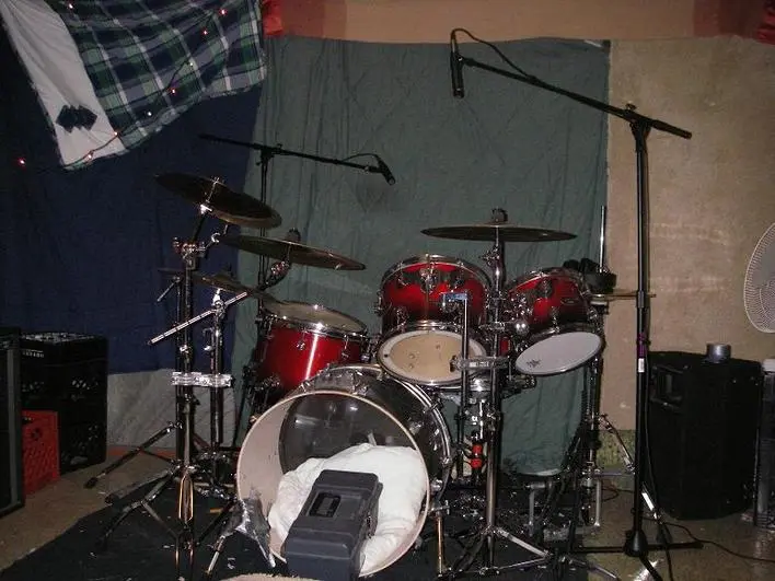

i have started recording drums... and was placing mics here and there to get a good sound. then i read about particular techniques. so i tried the recorderman with 2 sm57s and i am very pleased at the improved sound quality.

kick not low enough of a sound
and the toms could stand to be tuned better
the sticks i used were old so the ride sounded pretty bland
the performance is just ok
overall though, it is an improvement for me.

for what it is, sounds good to me..If you had a 3rd mic on kick, that would be a quite usable track...
does the kick have to be that muffled?
it doesnt sound very good when it is not...
the thing is falling apart ( see the duct tape ? )
im hoping to get a new one mostly to be sturdy but also it will probably sound better.
that's pretty solid. I think you might prefer some sdcs instead of 57s... still sounds good though!
the thing about recorderman is you need to have a nicely tuned set.
I used this set up with a 58 (top unscrewed to make it a 57, though) on the kick, and 2 58 ripoffs as overheads, and the drummer I worked with loved the results. (Granted it was his first time being recorded :P)
it is crazy the amount of factors that will effect the outcome of a simple recording such as this one... i agree tojo, a nicely tuned set is certainly necessary ( of any recording really! ).

i really like the recorderman for how powerful the snares presence is.
so plus a kick mic it will be great.
or i can go xy to get the symbols a little better ( at least i think it would )
and close mic the snare as well with a 57

Sounds good as been said before kick could use a boost in there but i know your now gonna take care of that
I have practically the same set up now i have a firepod which i run a pair of small diapragm condensers in for my oh's in a widely spaced pair. Then 57 on snare and a beta 52. You ll get a really nice stereo image if you try a spaced pair, well try everything out and see what sounds great to you.

with the recorderman method i almost feel i dont need to close mic the snare, but i definitely will if i try other overhead options.

I just picked up a Firepod as well a few weeks ago (have been using a Firebox for the past 3 years). I tried some spaced pair options, but none sounded right so I went back to recorderman because I needed to get the song tracked that day for a deadline. I'll be experimenting more and figuring out where to place the OH mics in a spaced pair this weekend, but for someone with only a few mics (or inputs) at their disposal, Recorderman and the Glynn Johns methods give very usable results (if not great results).
