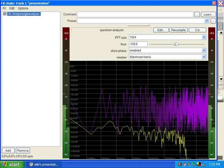

I'll see what I can do...
What do you think???
Unfortunately I think it's difficult to make any specific diagnosis from that screen shot because I can't see the frequency scale which I assume is along either the bottom or the top of the graph. Without being able to verify the actual frequencies of the various peaks, it's not a complete help.
Is that what it looks like when there's nothing but hum? Because that's what we really need to see - along with the frequency scale. It looks like *maybe* there's at least some regular repetition there, but I can't say for sure yet.
