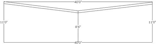

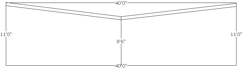

how about using some of that height to allow a new ceiling that will break up the standing waves floor to ceiling plus divide the room into two acoustic spaces so you can have carpet at one end and timber at the other.
see attached
cheers
John
see attached
cheers
John
Hi John,
I'll give this some consideration.
Do you have any thoughts on building Hardwood floors over Concrete for considerations in Moisture and Dampening? I'd like to not raise the flooring more than 4" or so.
