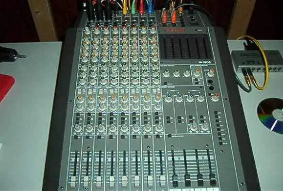

I would go the used tascam m30 m35 or maybe the newer style like the m 1508. There is alot to be said about having a true inline mixer that is designed for recording. It will save you alot of headaches during mixing and recording. With boards like that you wont have to do much in the way of patching. It can really speed up a recording session.
Here is a pic of the 1508 they can be had for about 135.00 on ebay and are nice little mixers that would work real well with your 22-4
I couldn't find the m30, m35, or m1508 on ebay (though im sure they'll show up if i wait), but i did find m308b

You just missed the m30 which I gave you the link for prior the auction close. It went for about $150. Not bad. Good news is that these come up often.
Genuine TASCAM M35 mixers unfortunately don't come up often on eBay but M30's do.
The M308B is a SUPERB mixer. 4 BUSES with loooong sliders and a shit load of features including the super rare phantom power for all channels! Hint: the only difference between a 300 "B" version and regular 300 is that the "B" has phantom power. All the M300 series mixers are excellent tho. The M208/M216 mixers are also very good. I have a "thing" for VU meters so thus my recommendations over LEDs. It's just a personal preference. ;) I say go for it!
