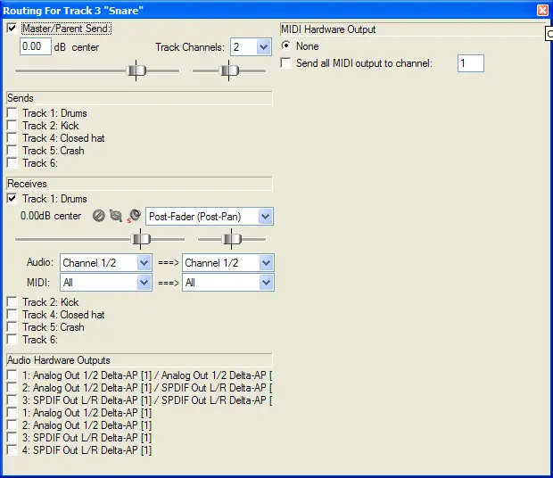

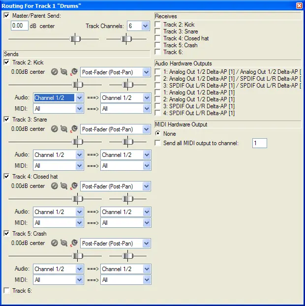

I did as you said Travis but the other tracks aren't receiving any audio. I set the outputs of the drum machine (it has 4 come to find out...kick, share, hi-hat, crash is how I have it setup right now).
I set the main track that has the VSTi on it so the sends are:
Track 2: Kick
Track 3: Snare
Track 4: Hi-hat
Track 5: Crash
I have that main track with the VSTi on it as recording from MIDI keyboard.
What should the input device be set to on Track 2 through 5?
I record but everything gets recorded to the main track with the VSTi on it and nothing on the other tracks. :confused:
I uploaded a screenshot of both the main drum track (that has the VSTi on it) and one of the other receiving tracks I/O.

danny can you post your send screencap?
or better yet, can you come to reaperchat for some realtime help?

Send screencap is the first .gif file on there "drums.gif".
Gonna join the IRC room.
Thanks pipepline!!! Got it working now.
