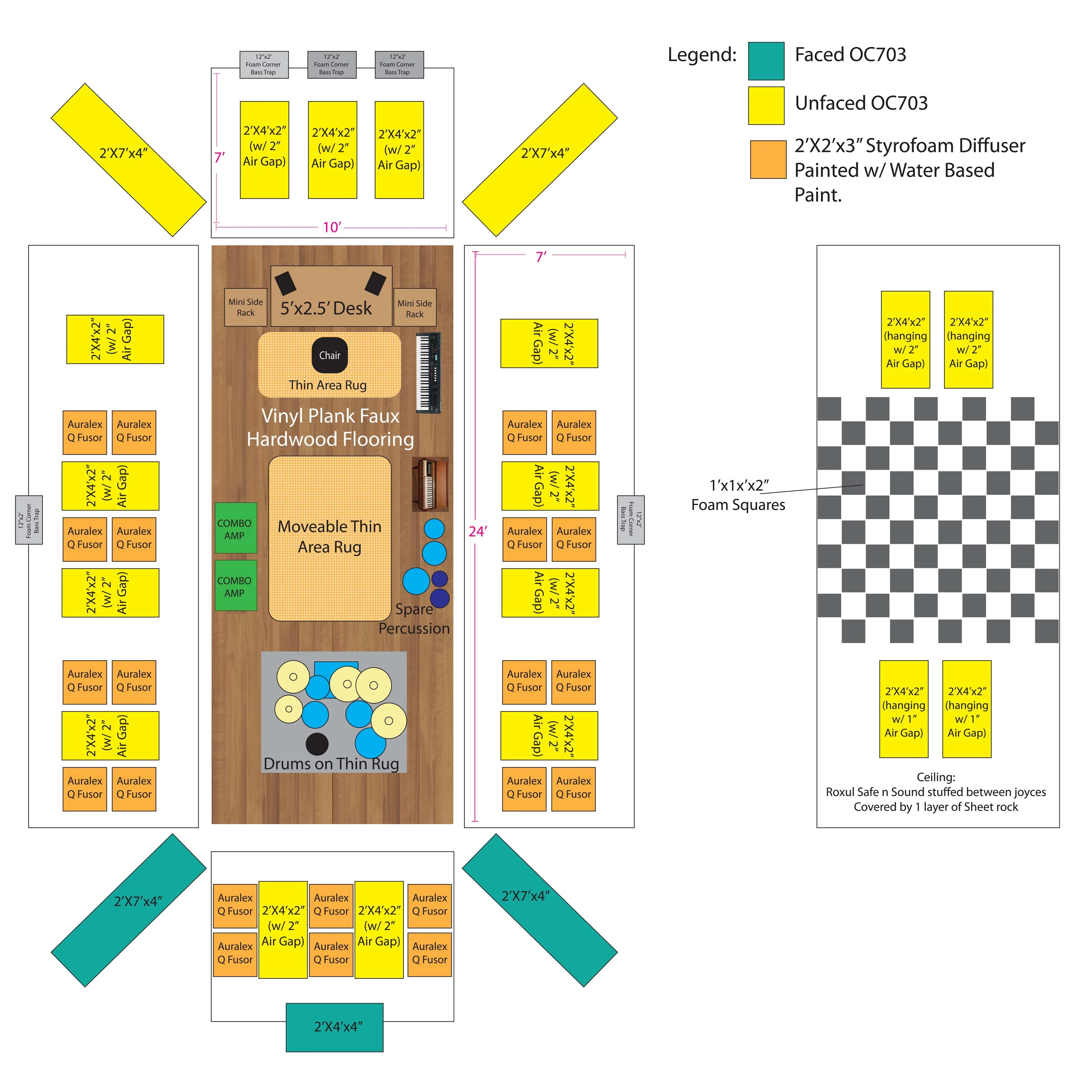

Here is a sketch of how I plan I will place everything.

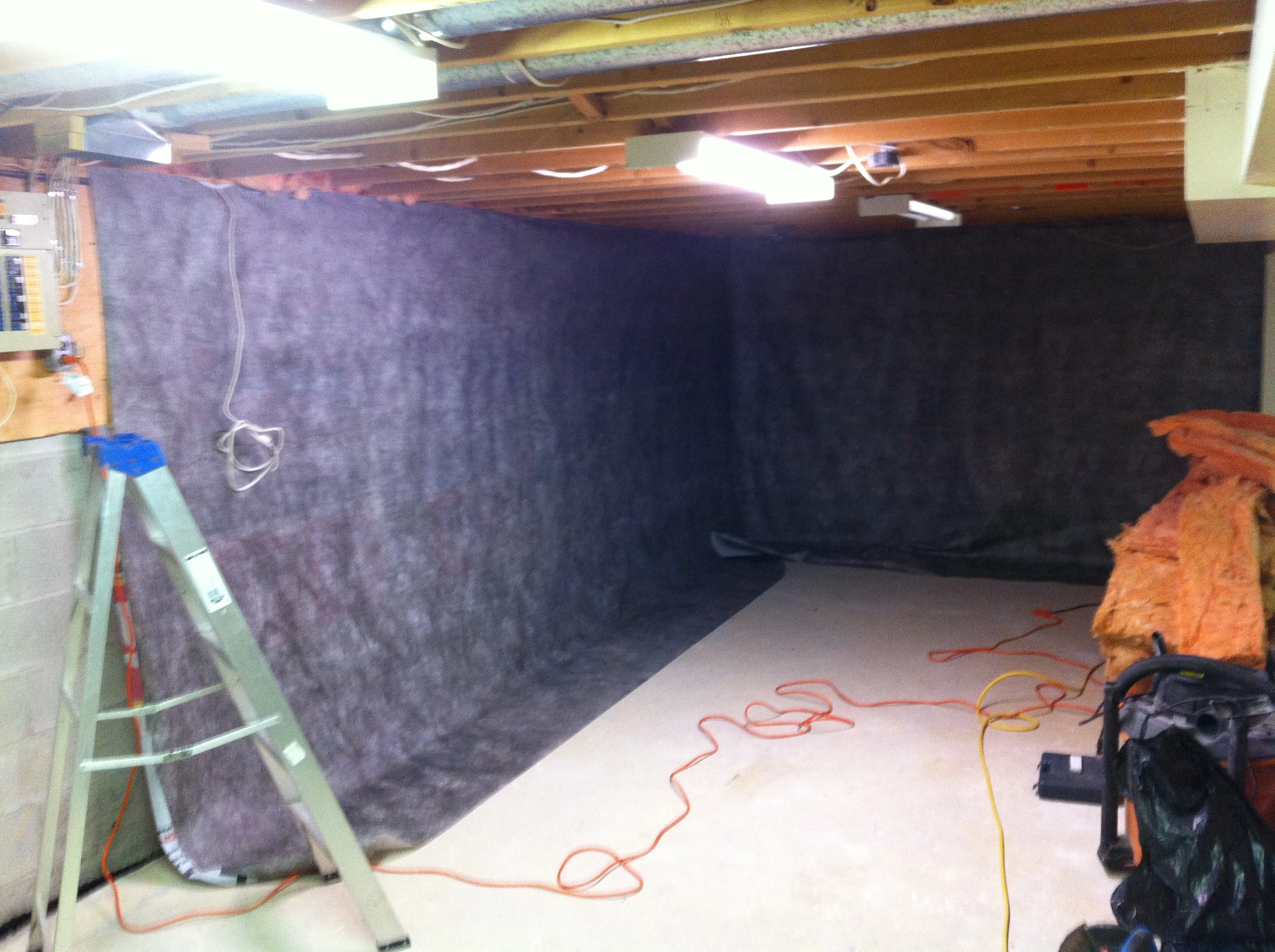

Here is a shot of when i was almost done installing Tyvek house wrap to the inside of the walls (plasticky side facing brick). That way if any moisture ever enters, it will trickle down into the trough system that was dug out and installed around inside perimeter of my whole basement which leads to sump pump.

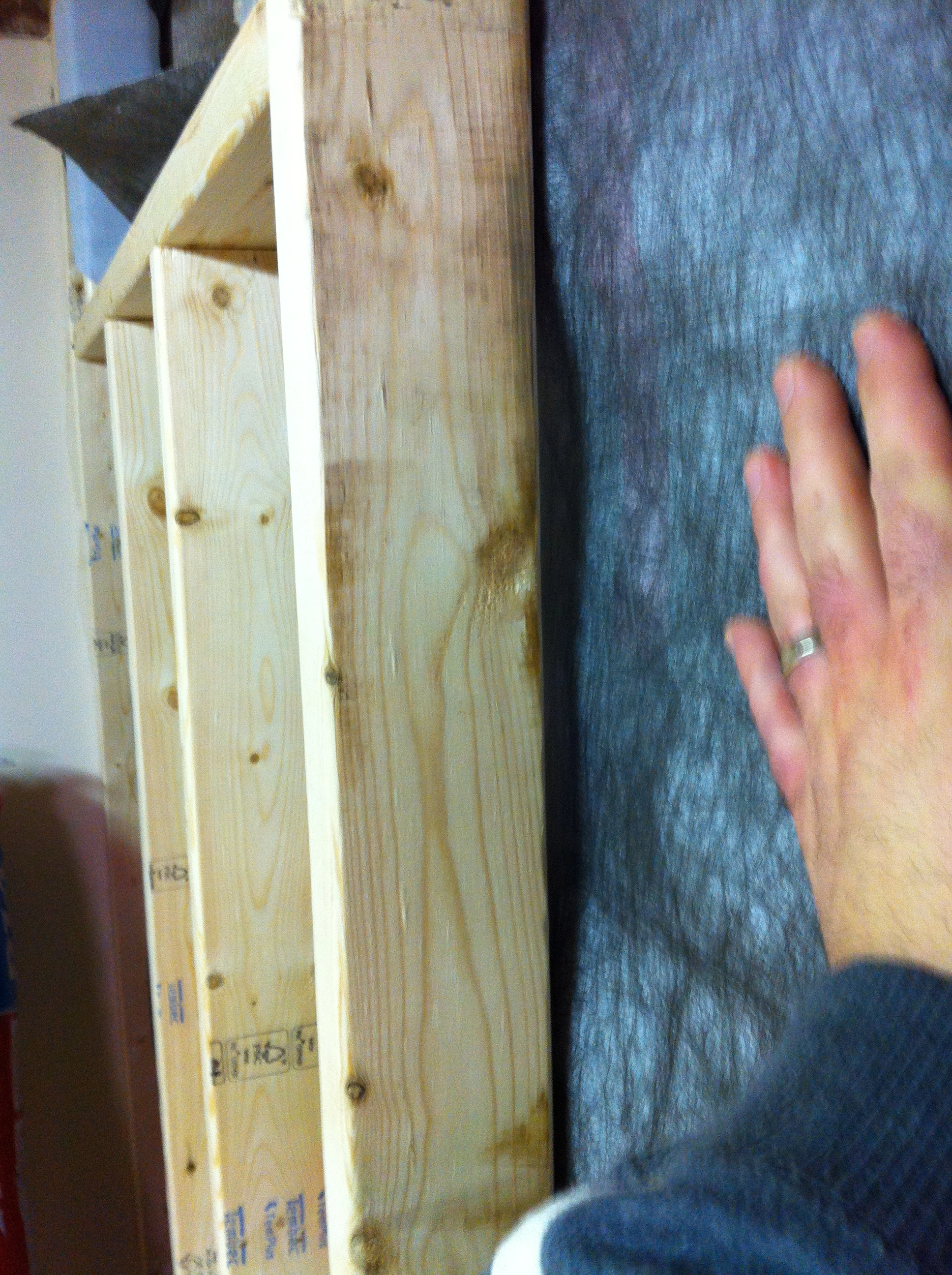

I spaced the framing 1" off the outside walls to (maybe) prevent extra vibrations passing through the wall to the outside. It wasn't difficult so I thought it couldn't hurt!

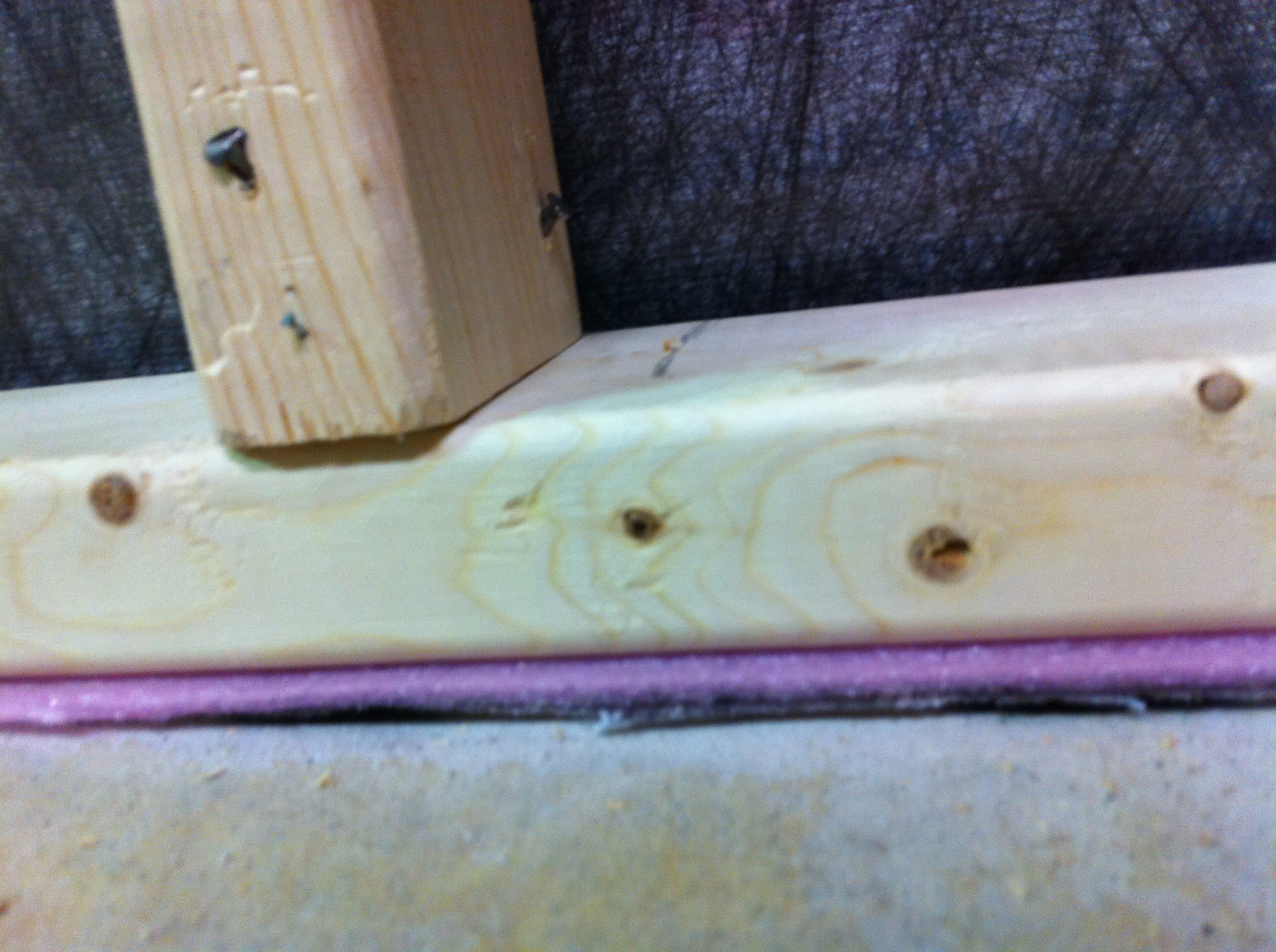

I placed this foam liner underneath the permiter floor plate to (maybe) reduce floor vibrations transferring to studs (better than nothing and cheap) and to further elevate the wood from the concrete floor, in attempt to reduce/eliminate any ground moisture from transferring to the wood.

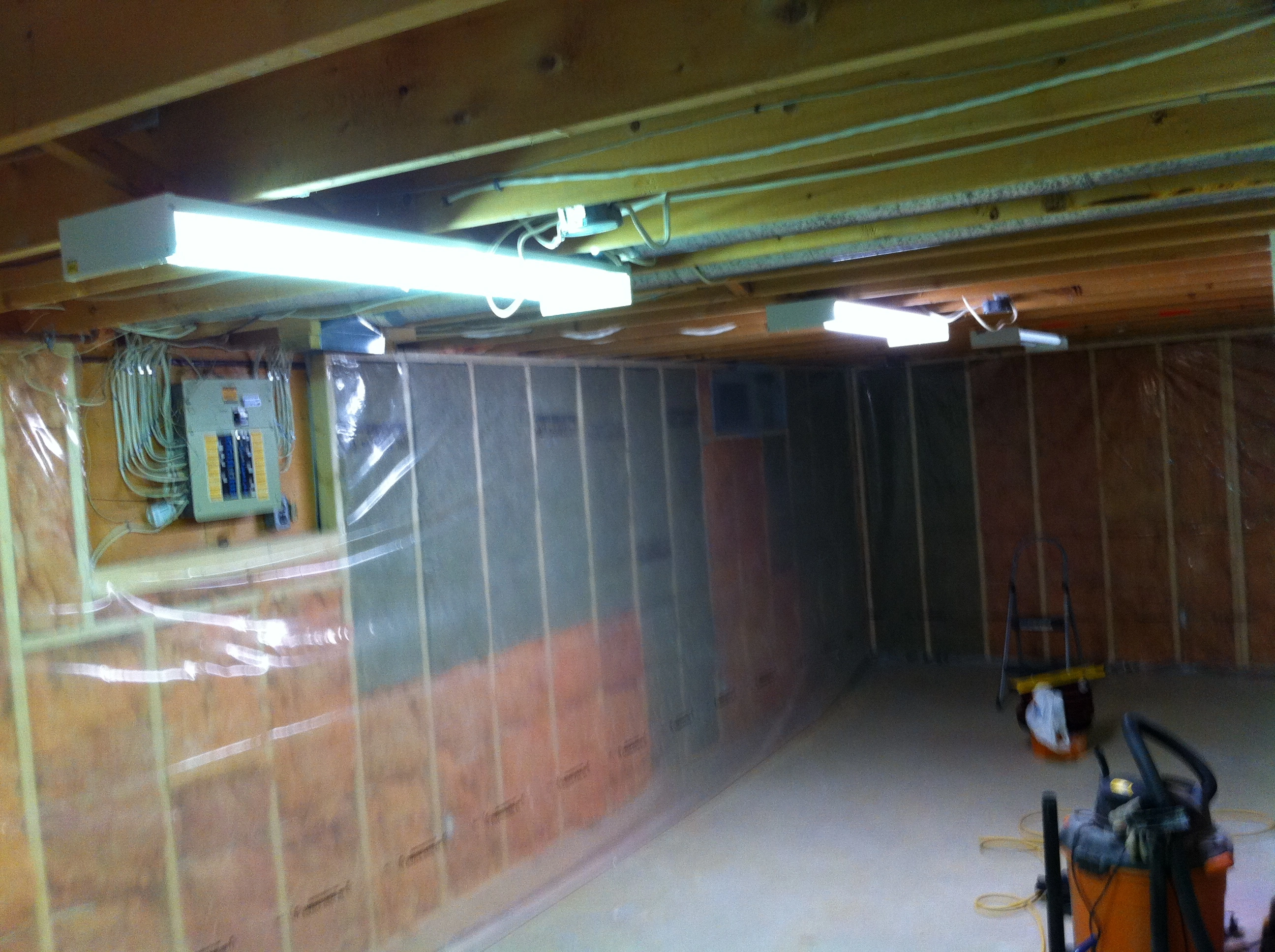

Vapour barrier is now up, electrical done (for plugs) and the inside wall framing has begun, will post pics tomorrow!

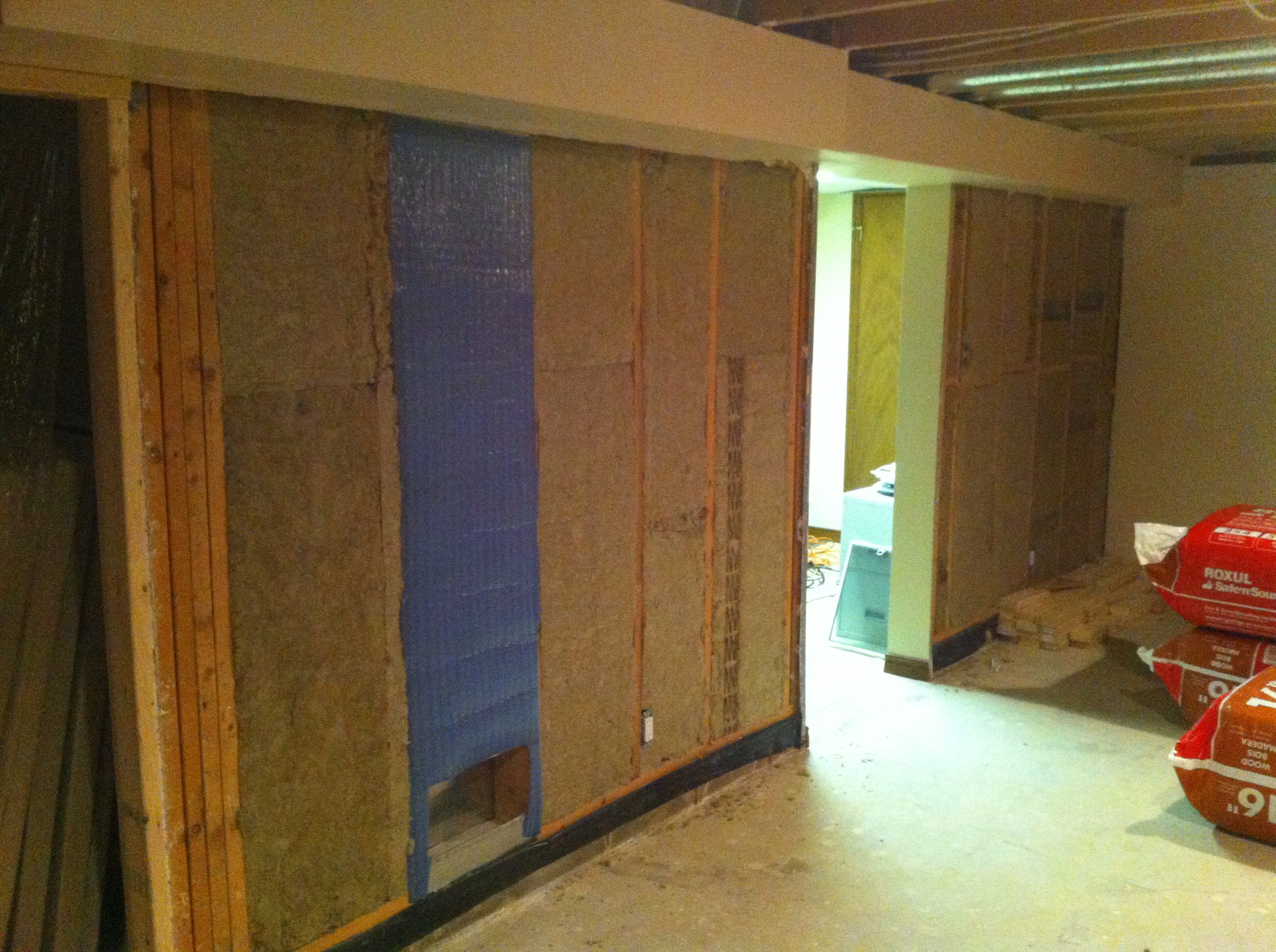

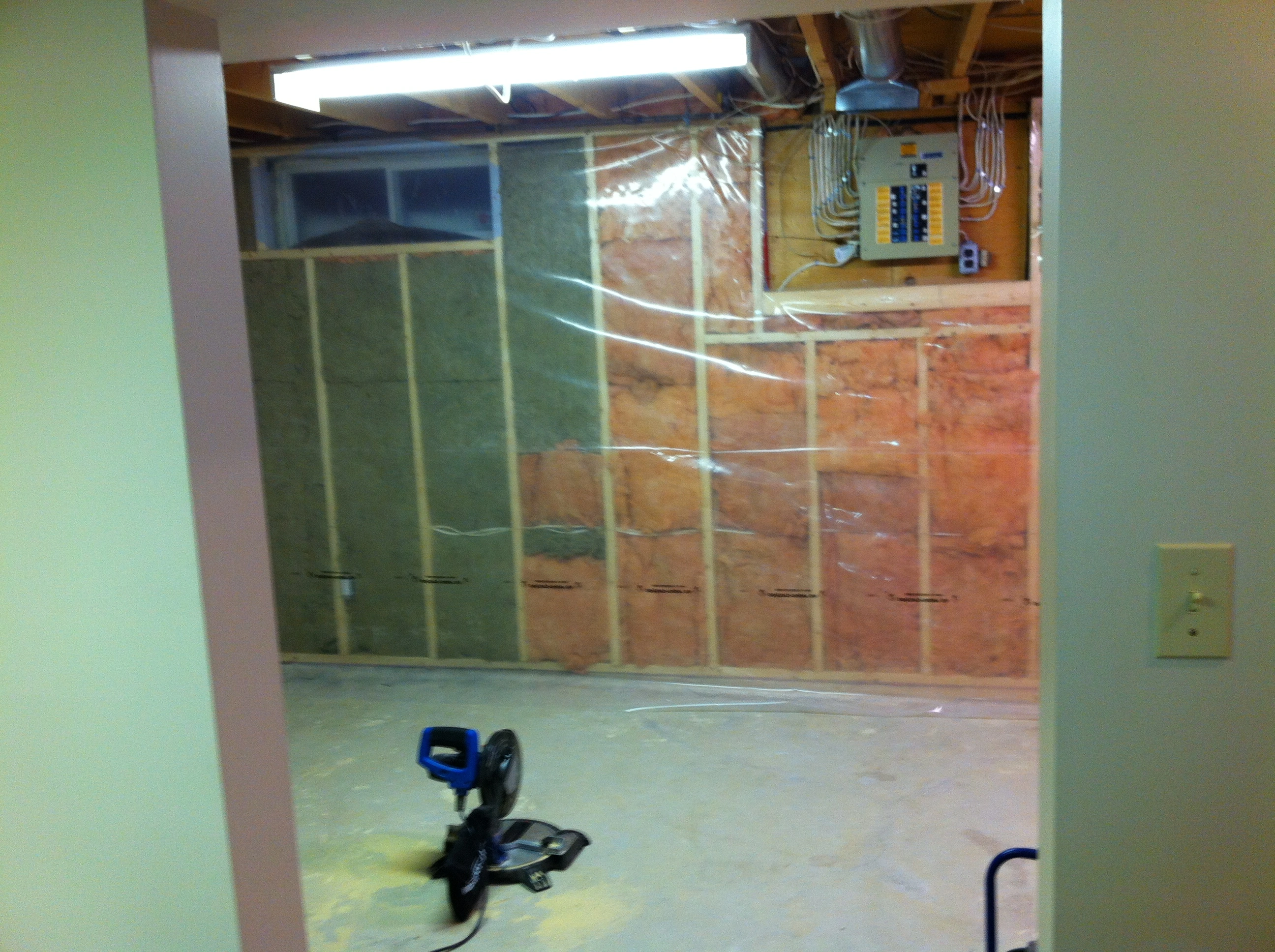

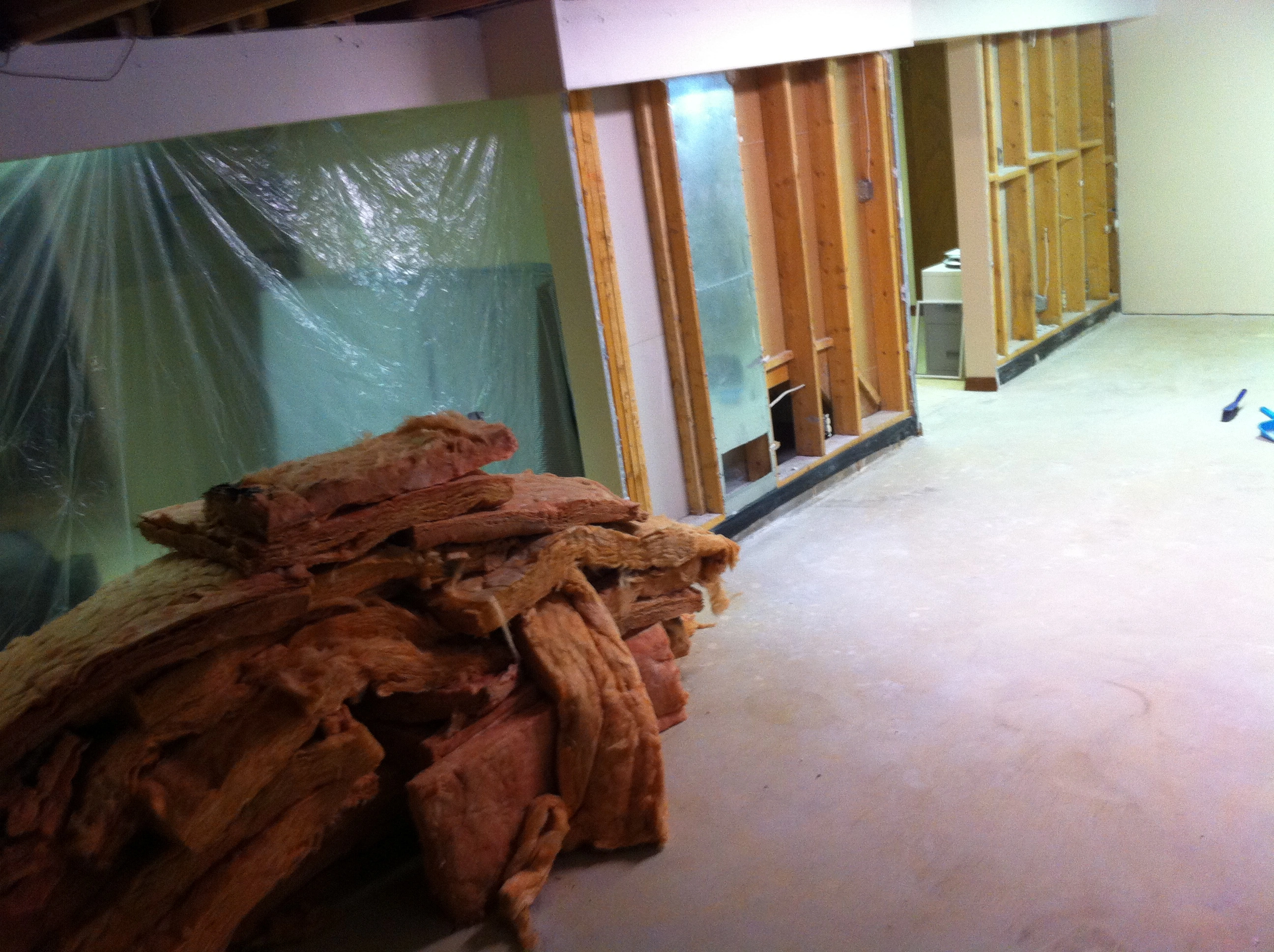

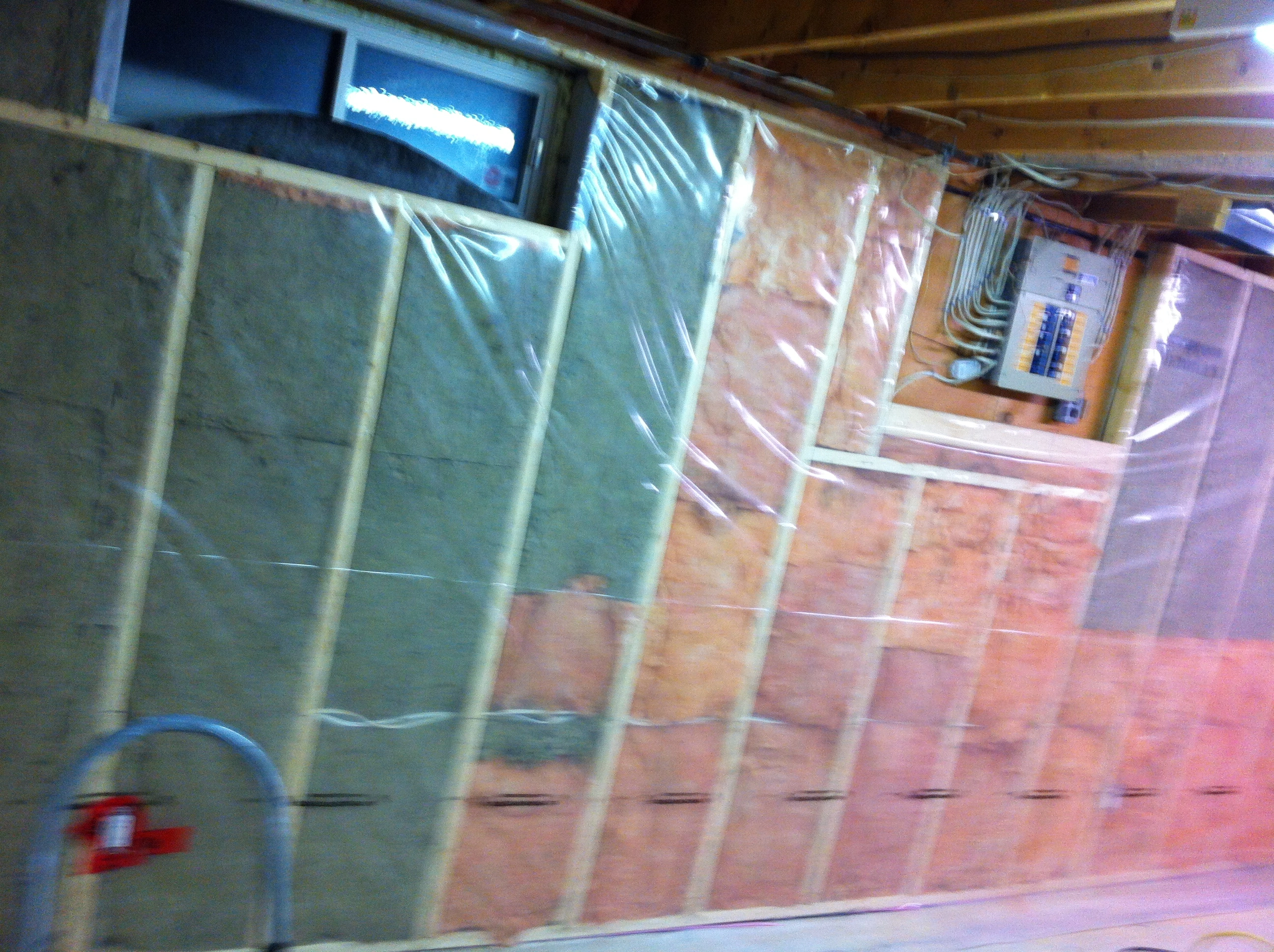

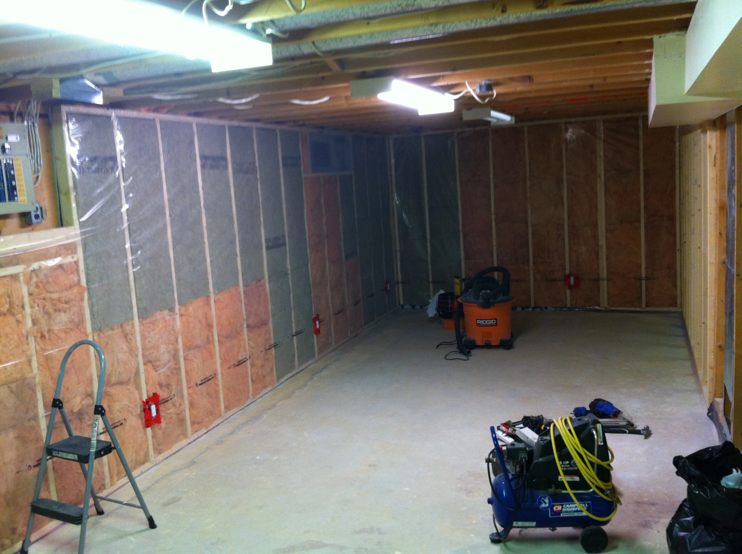

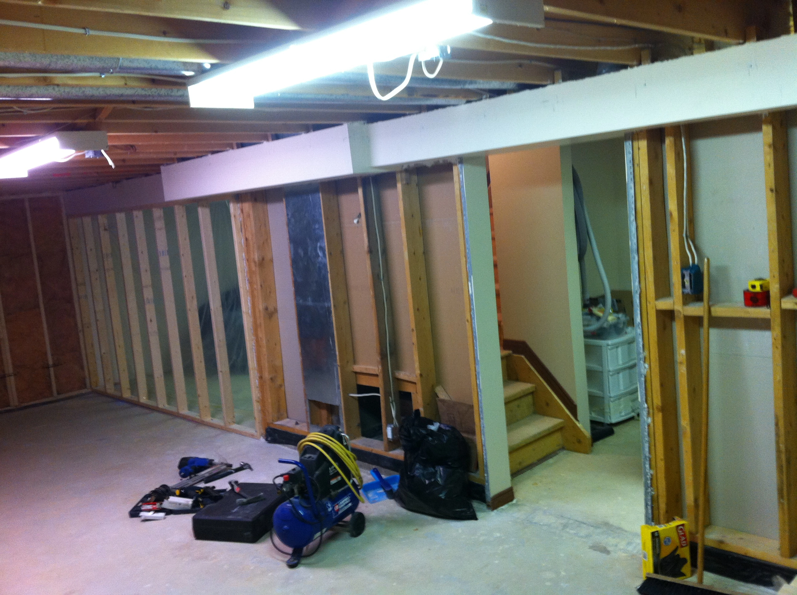

Vapor barrier up, electrical plugs wired up! If you'r wondering why there is mismatched insulation, it's because I salvaged what i could of the original stuff that was still usable. The rest of the junk gets stuffed into that bulk head you see in the 4th pic down. It's a steal I-beam, so I doubt much sound will pass through it to the other room, but better to be safe and stuff the cavity with the old ripped up fluffy I have instead of tossing it.

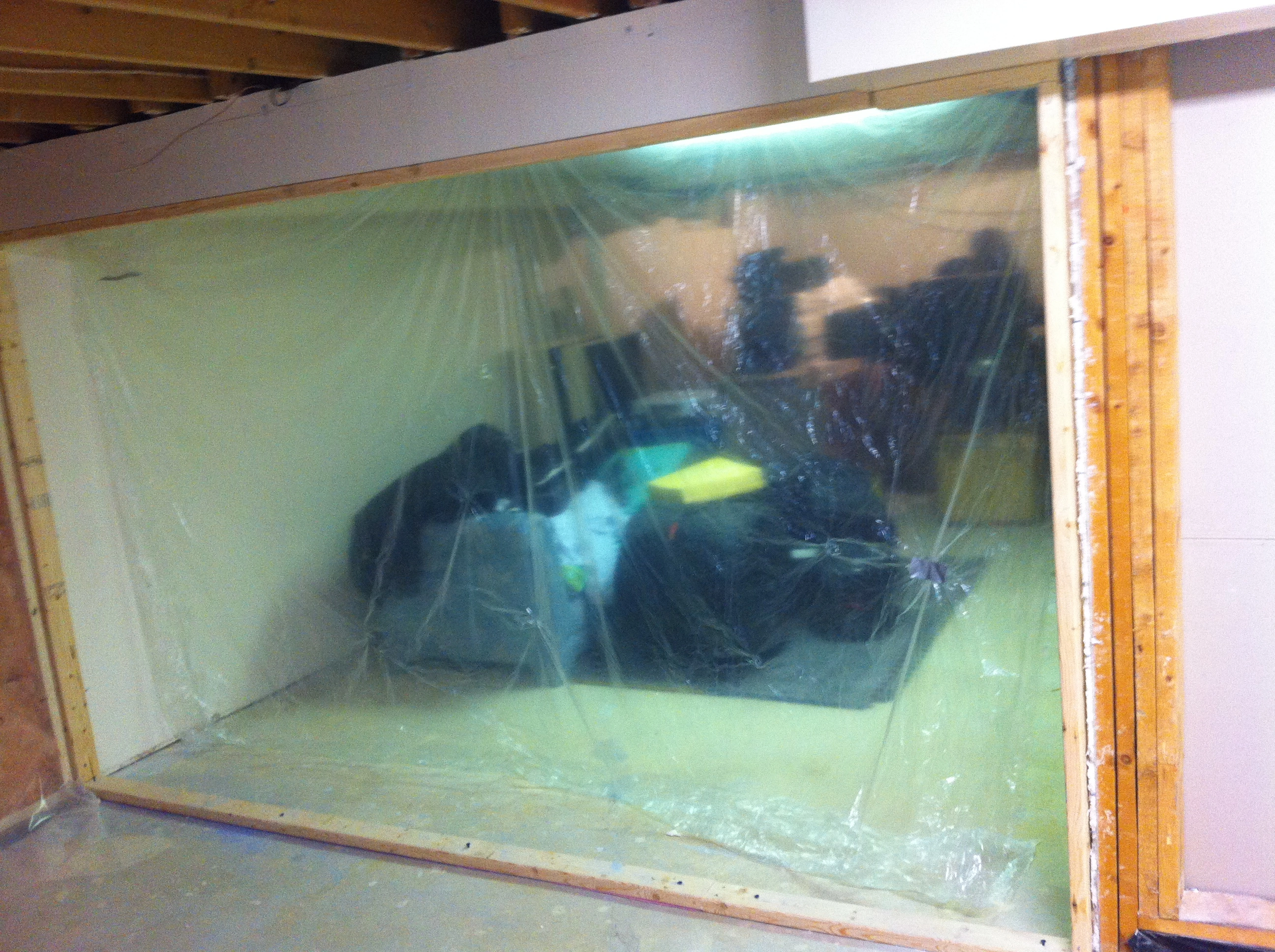

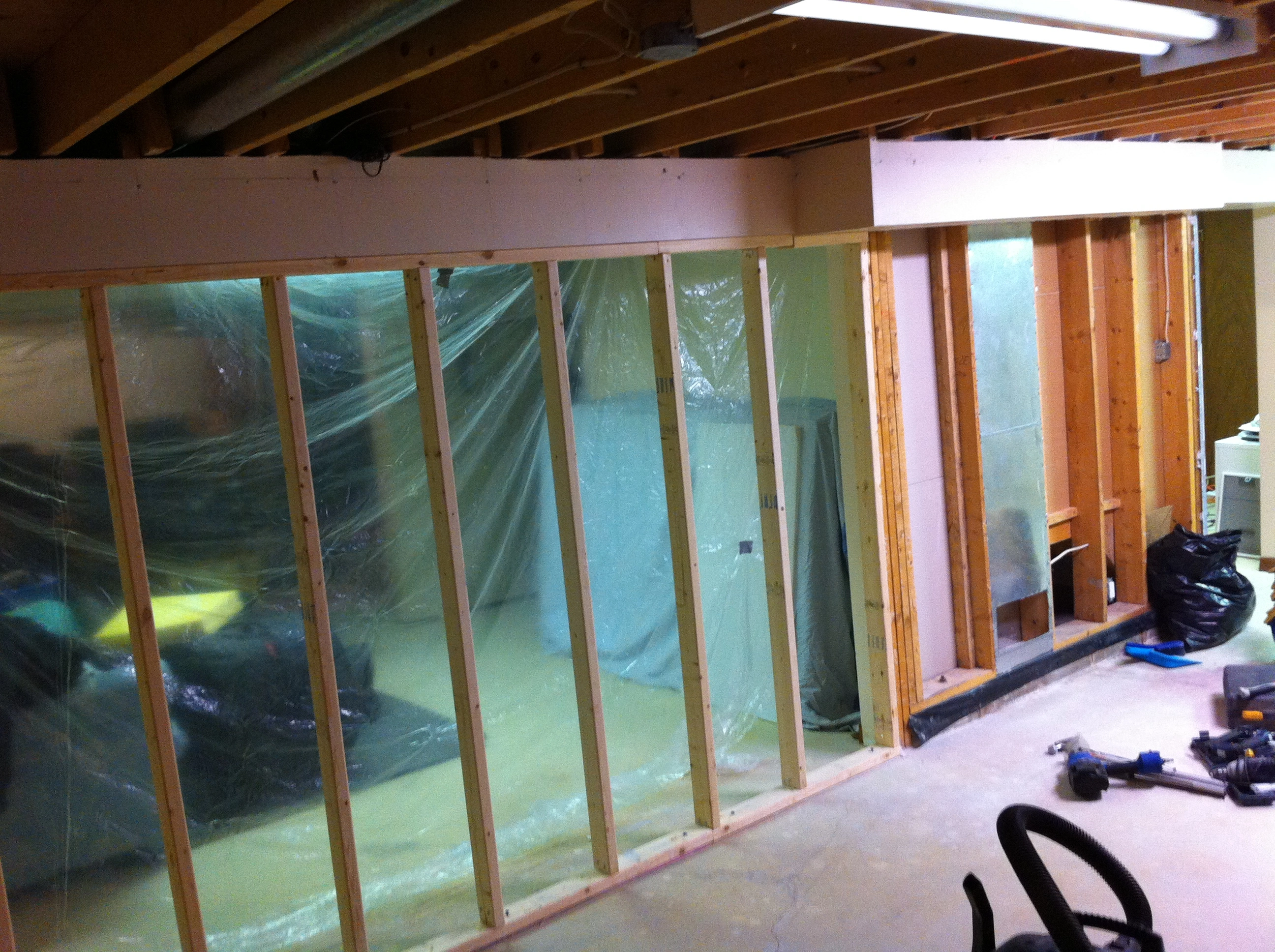

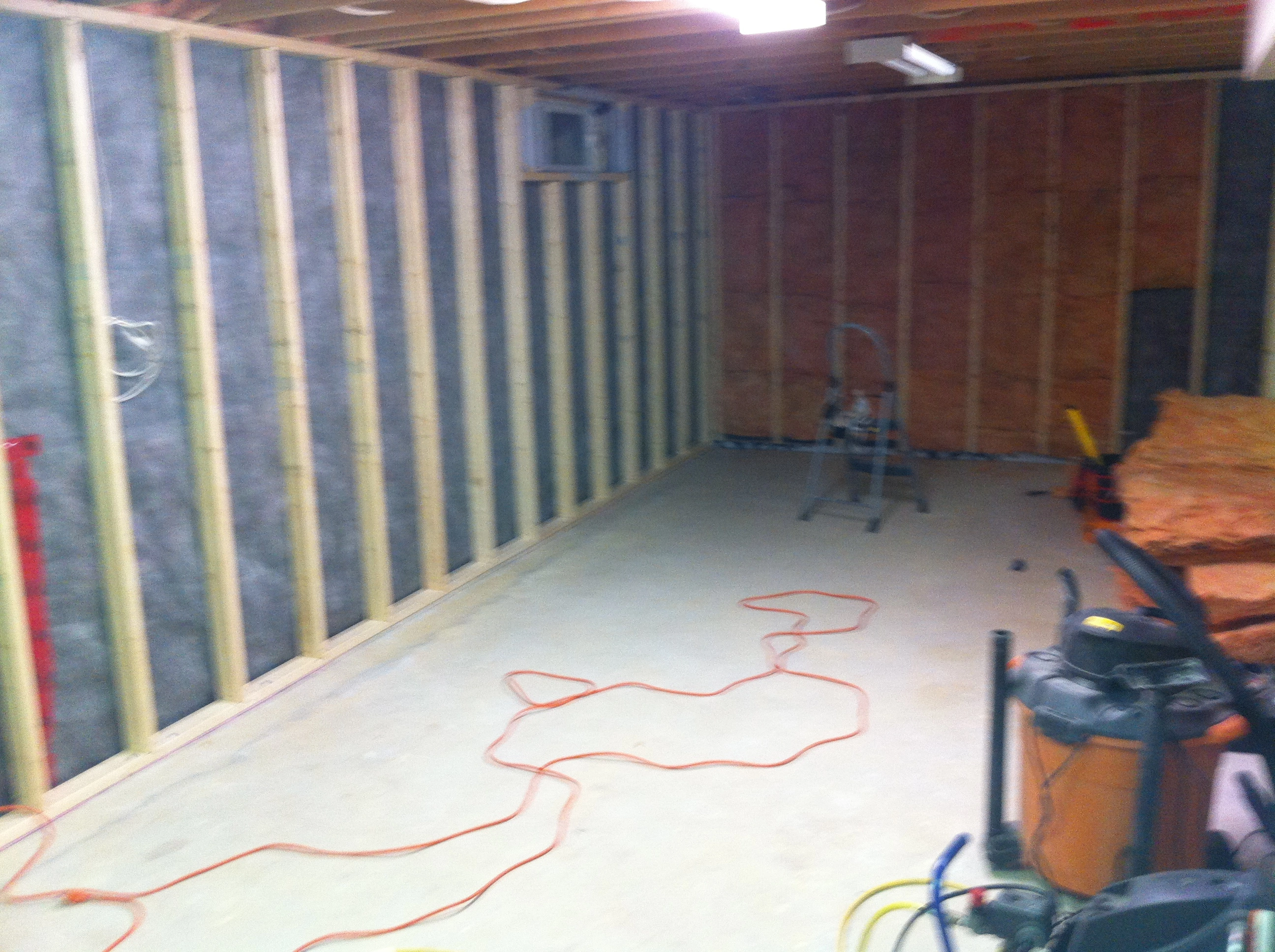

Framing has begun for the portion I am "walling-off". Will be done tonight.
Framing done for the "walled-off" area, more plugs installed, vapor barrier fully stapled/taped/trimmed.

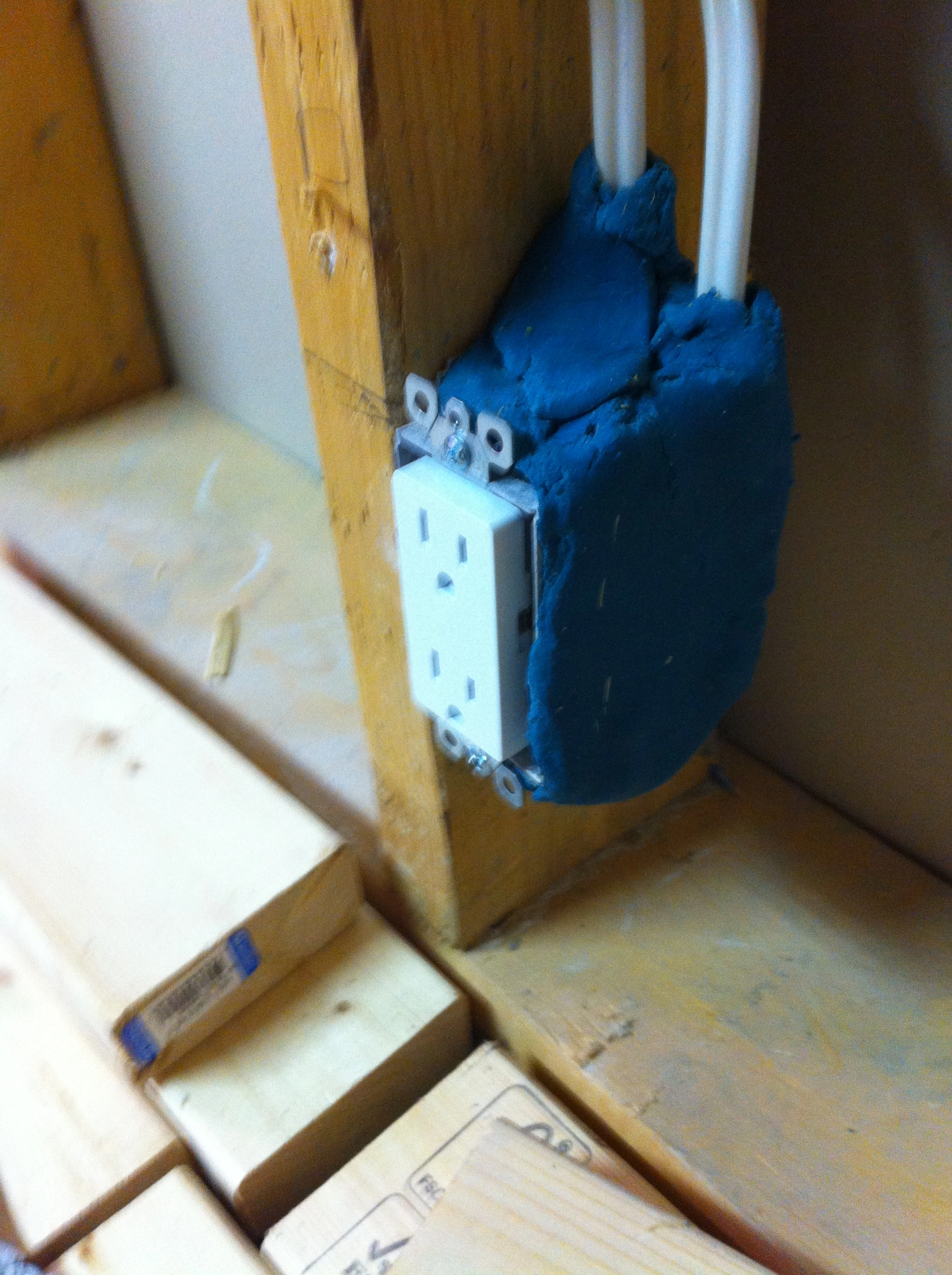

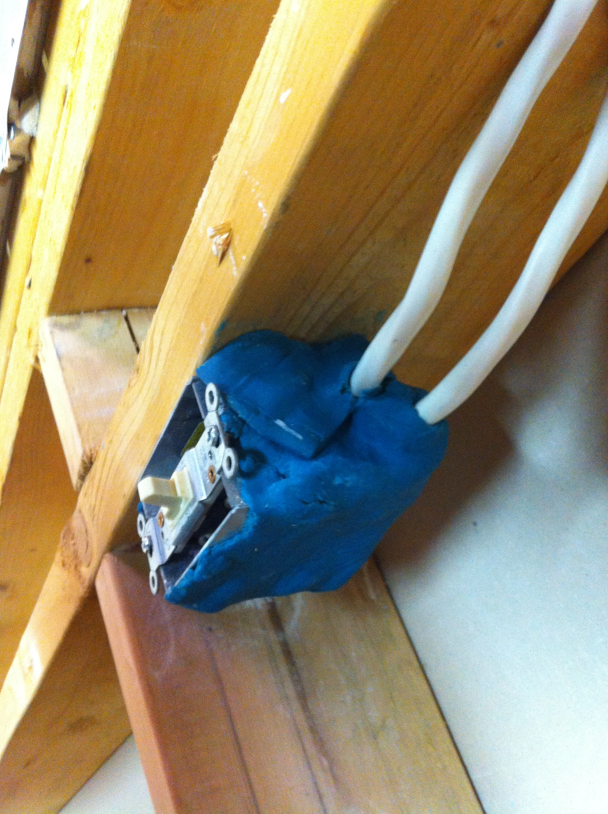

"QuietPutty" installed around plug/switch boxes. This prevents sound from transmitting through those spots in your walls (since you had to cut out drywall to expose the box). Every bit helps I guess.

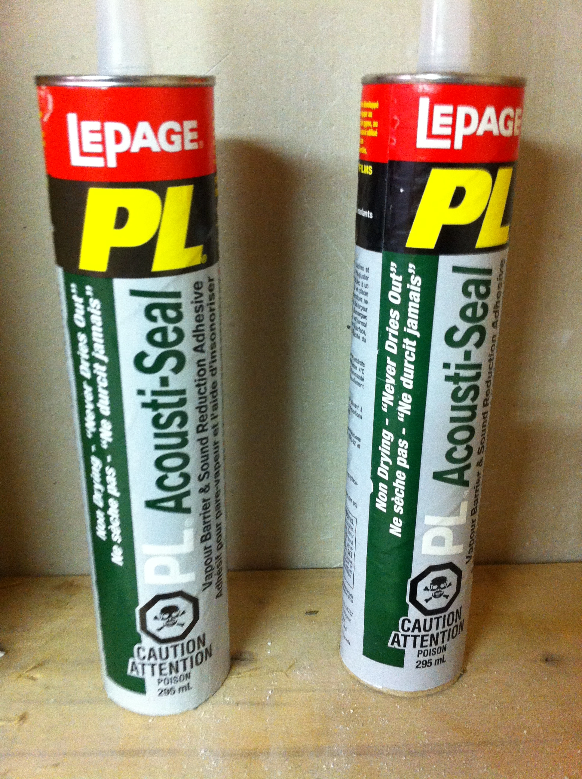

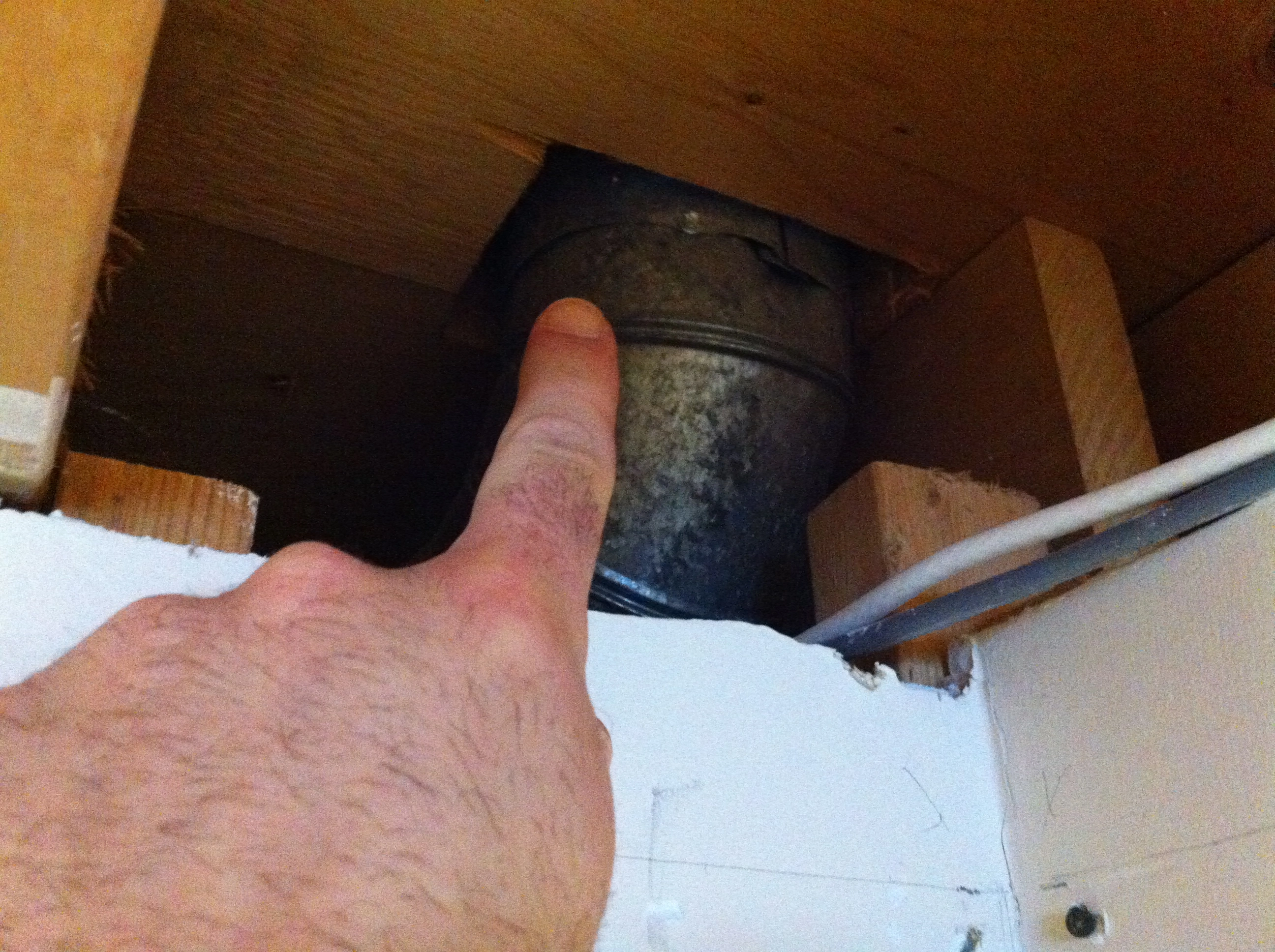

I finished filling all the gaps/protrusions (with acoustic non-drying caulk) that lead from in the studio to upstairs through the floor, like HVAC ducts, plumbing and cables. Pic is of one spot BEFORE I filled it.

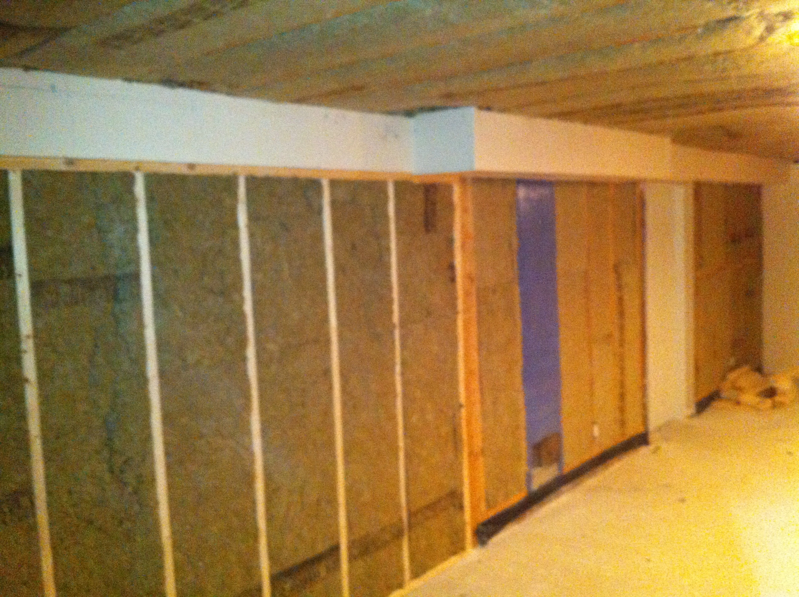

Finished filling half of the interior wall. The new walled off area which is the whole left side of this wall not pictured, will be filled once drywall is put up on one side. Started filling the ceiling...MAN is it ever a pain to work around all the cables, plumbing, hvac and lights that are in between joists, without leaving open spaces for sound to unintentionally travel upstairs!

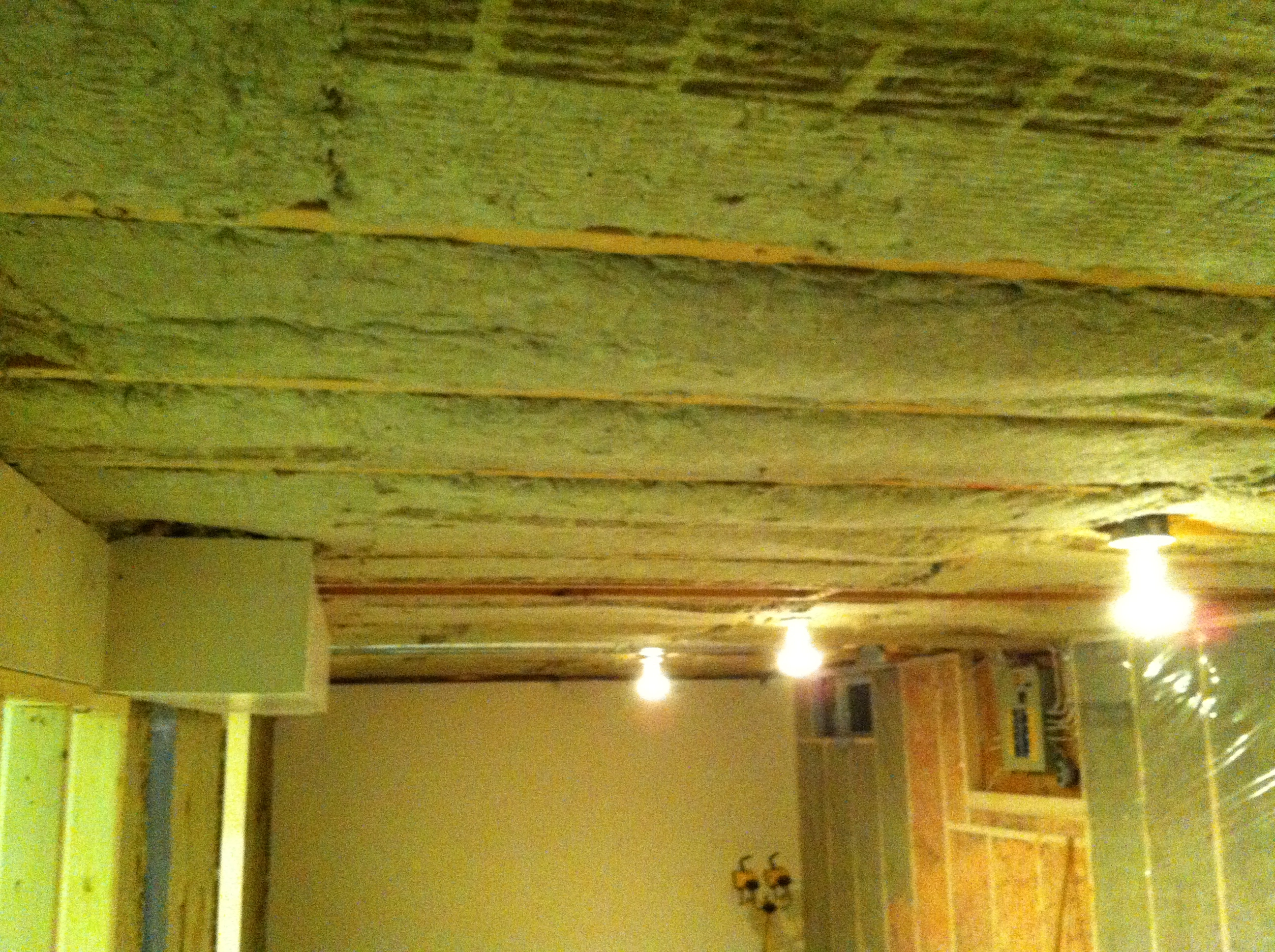

Almost all of the ceiling Safe n Sound is up, I only left the problematic cavities that have hvac pipes as i will need to raise those pipes up slightly in order to put drywall flat across joists in ceiling. Also, how in the hell am I supposed to even put insulation in those cavities when the pipe occupies a huge part of it?!? I guess I will have to put the stuff ABOVE the pipes which I hope doesn't lower the stc rating (having it closer to the upper floor and losing that air gap).
MAN is that stuff nasty to work with when you're holding it over your head and fitting it in overhead places. Itches on the face and even under my clothes!

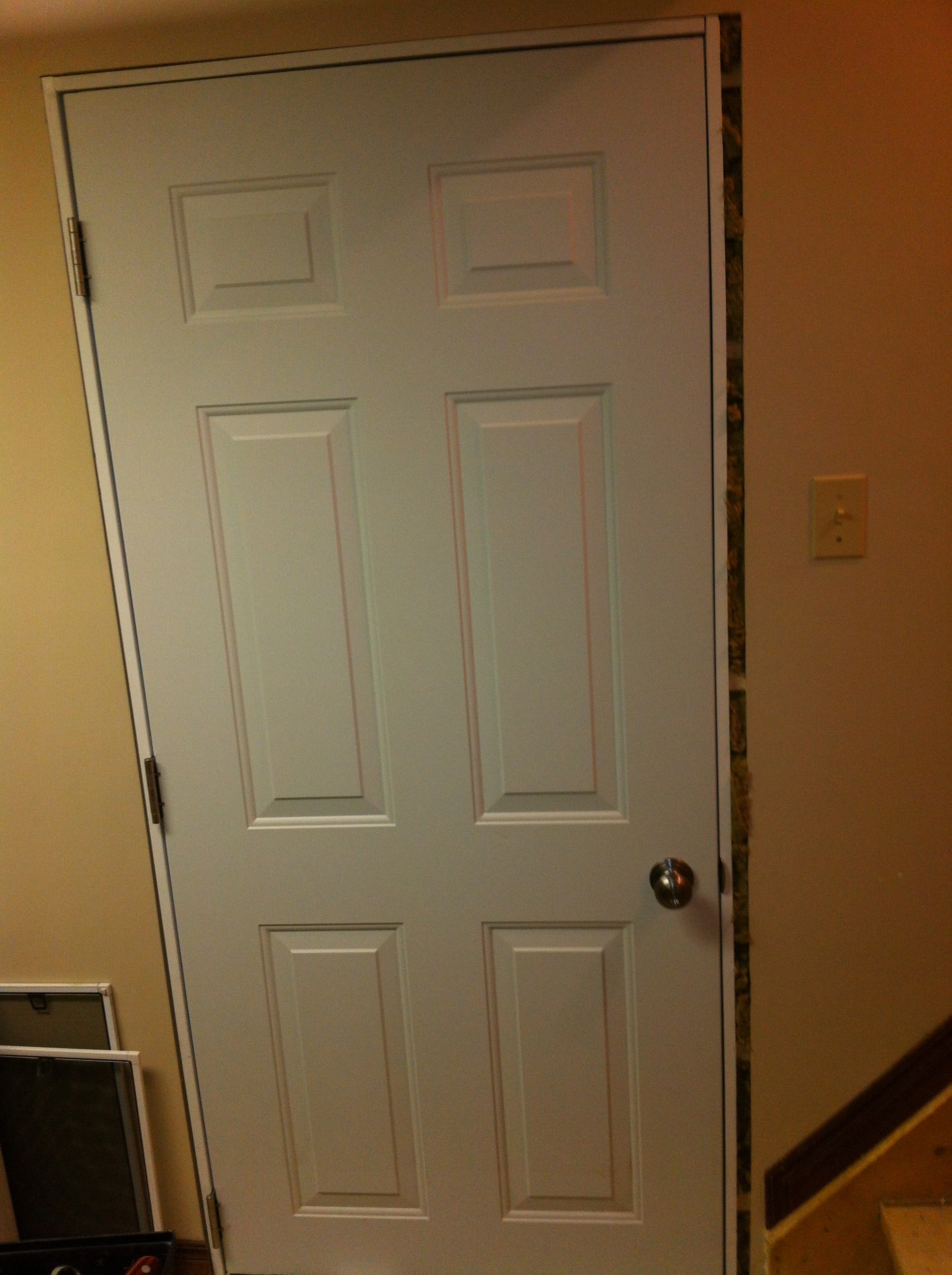

All insulating/sound isolation done. Steel door cut down and installed. Gaps around door filled with Safe n Sound, foam filler (like really skinny pool noodles) and acoustic caulking. Still needs drywall, finishing touches and trim of course.
View from inside
View from outside (needs trim)

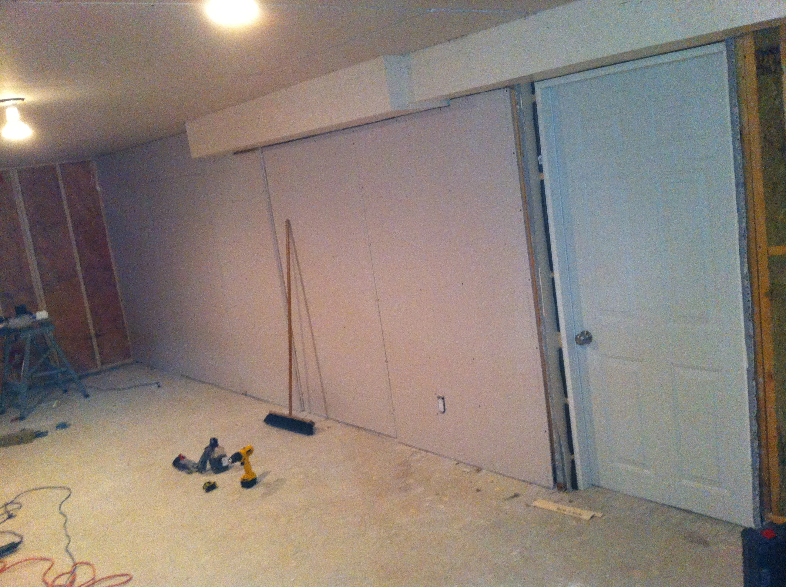

Picking up the drywall today! Will be a combo of really dense 5/8" Firecode drywall (thanks for the tip John H. Brandt!) for the interior wall and ceiling (extra mass for more effective sound proofing), and 1/2" standard drywall for the outside walls (the walls against concrete block).

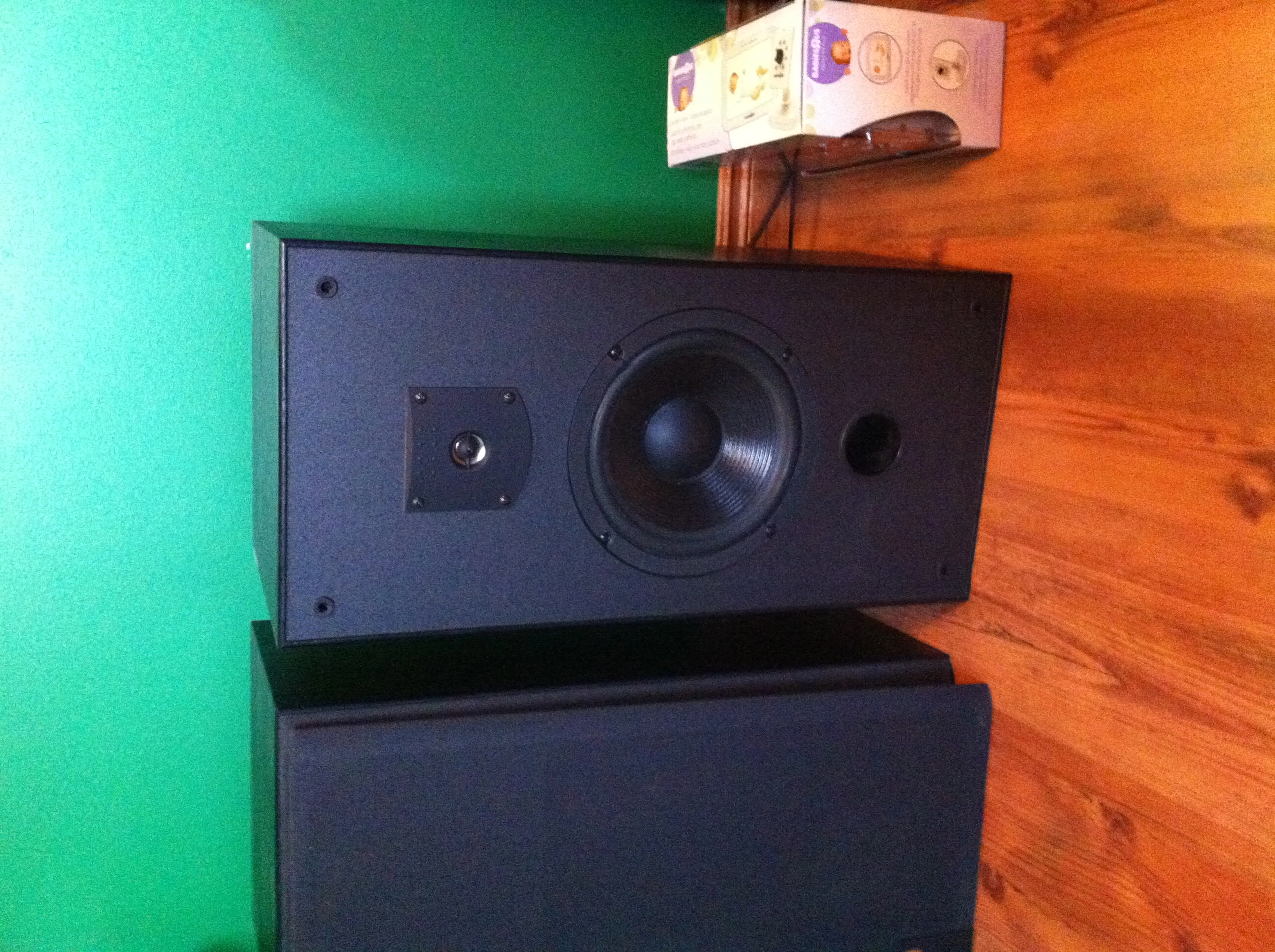

Found these at the same shop. They are JBL's from the 90's with 8" drivers. Freq response is 40 hz - 23 khz. Going to use these spaced wider and further back compared to my mains and using them more as "midfield" monitors. I will be using these just as reference for a good full-range hifi system, a little hyped-up sounding. Also just for fun listening, cranking them way up and for impressing the clients a little.

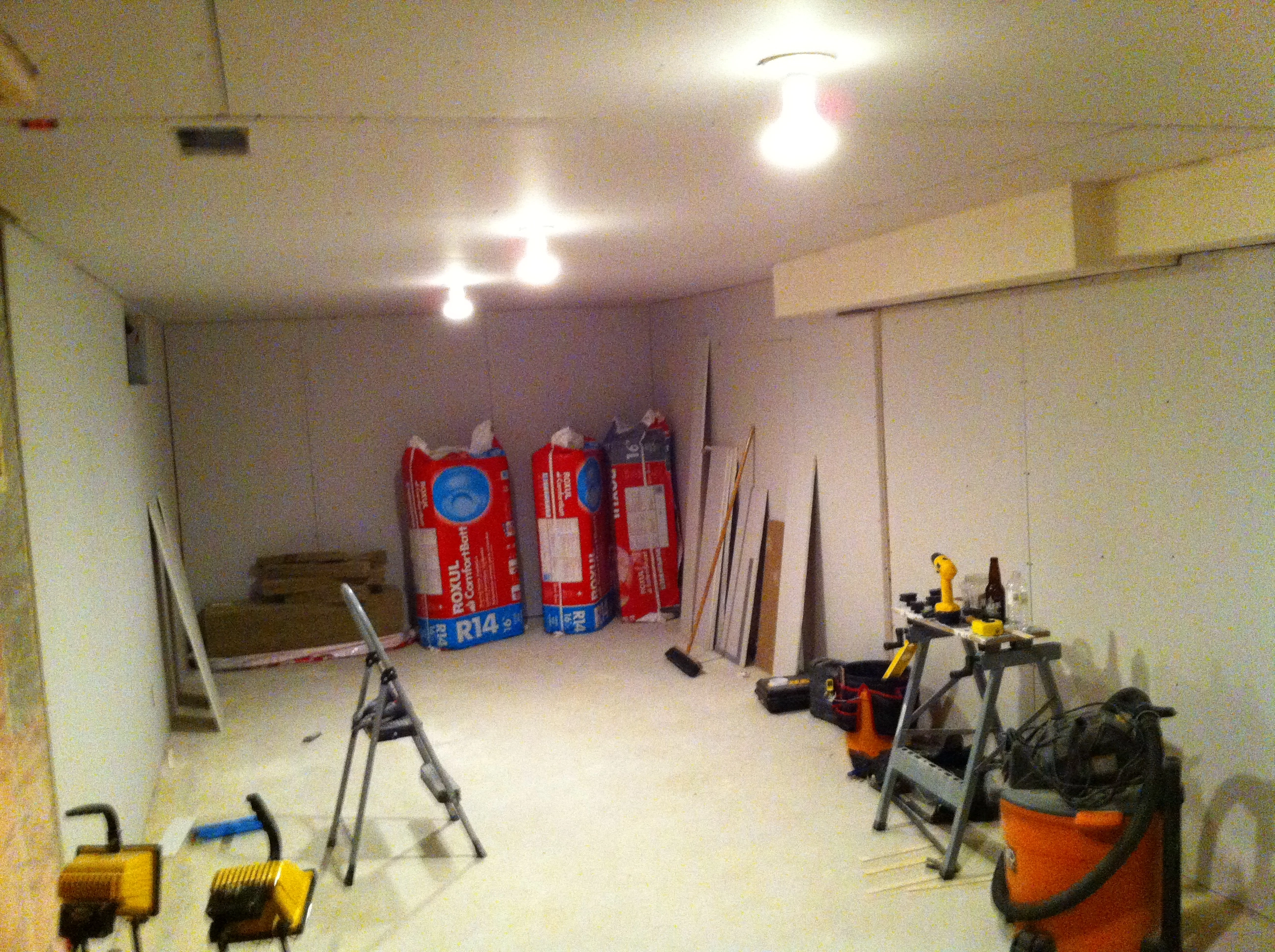

Moving slowly but surely! Drywall is finally almost all up! I'm dreading mudding/sanding this whole place especially the entire ceiling! :eek: haha

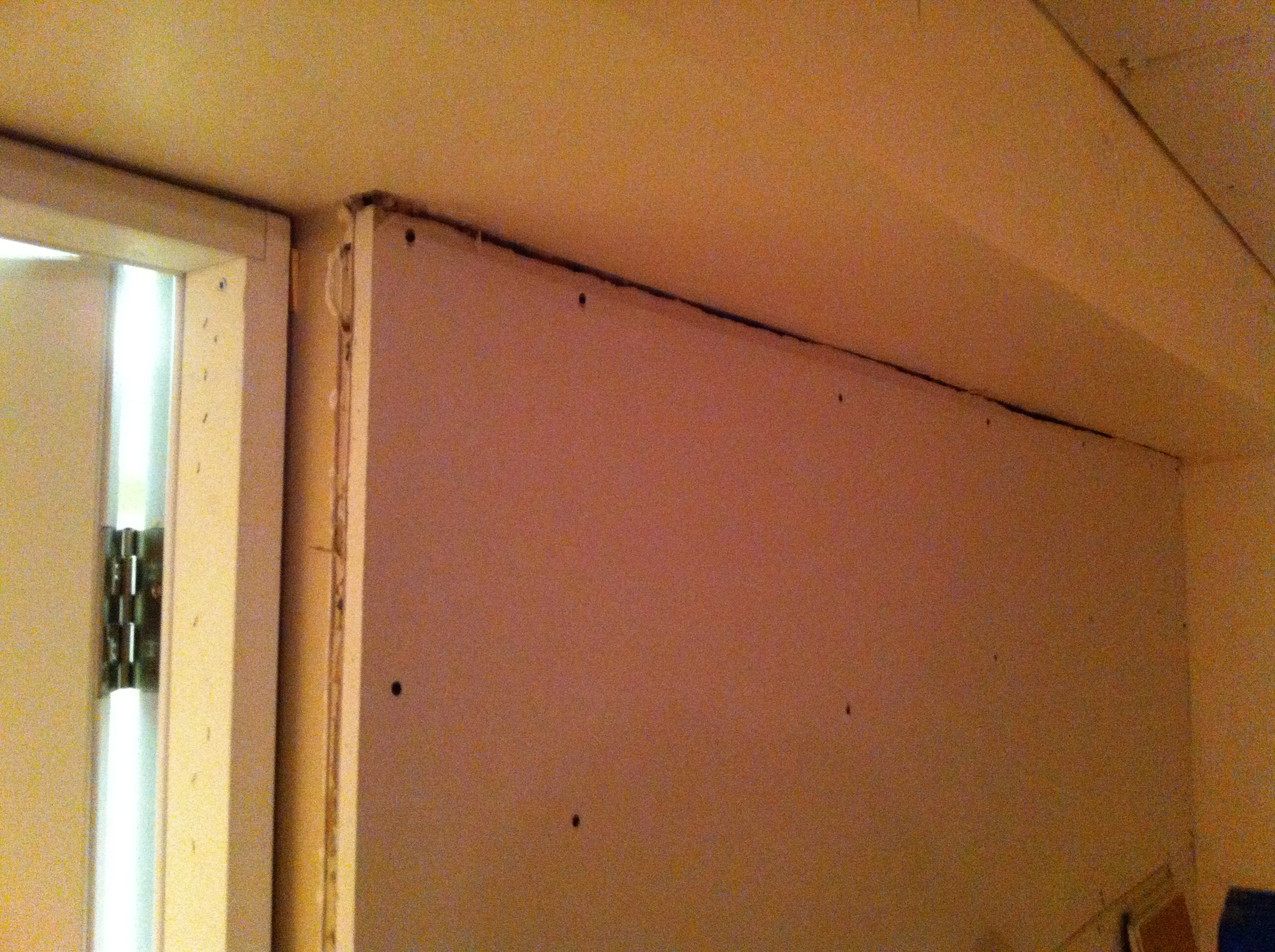

In related news, I have stuffed some foam filler "backer rod" into all the perimeter crevices (see below) where the drywall meets (wall-to-wall and wall-to-ceiling perimeters) as well as around the door I installed. Then i will be filling those crevices with Acoustical caulking, cover with drywall tape, then mud. Actually for around the door, I will be placing strips of firecode drywall over top before mudding. That should hopefully seal the room together nice and tight (along with the other efforts i have made). On the actual door, if I find that the steel door isn't providing enough sound proofing (after I have the door sweep/seals installed), I will attach a sheet of drywall to the interior face of the door using "Green Glue". That oughta do the trick.
