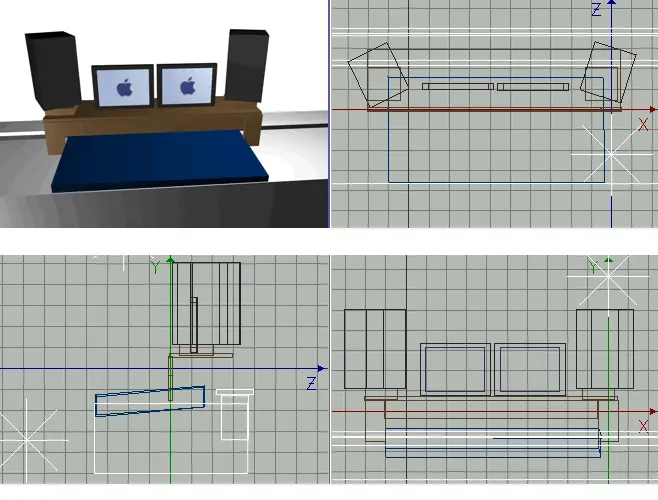

here is a quick blueprint/design of what i want to make for my console...
i have designed it so that it will conceal all the wires...
it will mean my screens are head-hieght
it will mean my monitors are ear height..
it will also make things generally more tidy...
tell me what you think...
(colours are not as i will have its just so you can see things clearly)
The blue box is what the mixer will be, for anyone who couldnt work it out.... and it wont be at that angle, its just it slopes and i couldnt work out how to do that in 4dCinema...

I think that will have to be my only option..... what do you think of the design?
Won't the positioning of your monitors relative to your console create an issue with early reflections? Or is the surface with all those controls uneven enough to deflect them?

@MrBoogie, the monitors arent directed anywhere near the console, they hit at head level where the console is a far way below. I didnt think that a console could cause sufficient acoustic problems, should I take it into account? Will it be worth my while?
I'm not good at explaining the technical stuff, but.... Basically, the way I understand it, even though the monitors are "pointed" at your ears, and not at the console, you gotta remember sound doesn't only go in a straight line, so while the sound is coming towards you, it is also going in other directions, I think the sound exiting the speaker could be represented as a cone shape. So some sounding is going in a downward angle also, and it then bounces off the console or whatever surface the speakers are on, and then comes towards you....at least some of the sound. This sound will reach your ears a bit later than the sound you have heard directly from the speaker and together they can cause a comb filter effect.
There's another thing happening that I don't know how to explain...something to do with directivity and wavefronts adding together causing peaks at certain frequencies and holes at other frequencies. I found this information in my manual for my Tannoy Reveal monitors. You can download the manual at the Tannoy website. The information I am talking about is under section 3.3 "console reflections" in the pdf manual for the passive Reveals.
But, like I said, I'm not sure if this will affect your situation or not. It looks to me like it just might. Also, those affects might be so minimal as to not even really be an issue for all I know.
I don't know if I can post a direct link to that manual, but it's easy enough to find.
I wonder if any of the audio guys in here can comment on whether this is a big enough issue to worry about, or if it's just being extremely picky, and maybe won't have much real-world affects?? I see in several pictures that a LOT of people mount their monitors similarly, and have heard little or no mention of this before.

Its something to think about, but im not entirely sure that it will be noticable because the waves hitting your ear may just overpower any reflections, making them inaudiable.
