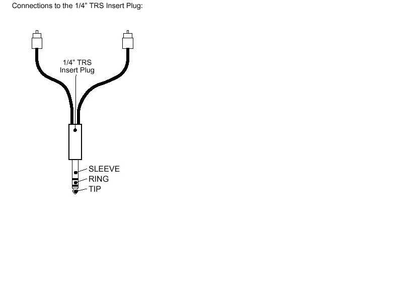

......and in regards to this, I believe you are mistaken. As the tip enters the recieving socket it passes two terminals, (one at a time, as it is seperated from the ring by the insulating plastic), stopping in contact with the first terminal; then the ring makes contact with the second terminal. The Tip and the Sleeve are seperated by plastic, thus keeping a "short" from occurring.
Not so...this is the same reason why phantom power over TRS is very dangerous for equipment (and therefore, isn't ever done). On the cable insert, there is a momentary short.
