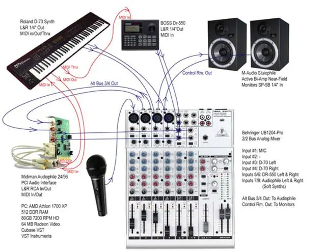

I was looking at this picture since i am going to be getting the mixer and audio card shown i wanted to ask this. I am going to need to use 4 of these connectors right? I mean since the sound card is only RCA in/out..

Yes, you will need four. But it will be rca MALE to 1/4 in male.

yea i see what u mean.. Now i started thikning about something. I am going to be using the KRK RP5 Rokit Powered 2-Way Active Monitor. Now since i see that there is a left and a right on the back of the mixer for Control Room out. How would i connect this one speaker to both left/right? Is there such a thing as 1/4 to dual 1/4 cable?

If you are only going to run in mono, you don't need to hook the speaker up to both. Just pan everything to the center, that way, the same thing is coming out of both the left and the right. Just pick one and plug it in.
