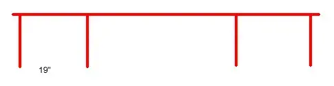

I took a 5" x16" long shelf from Home Depot and attached 4 pieces. Then added the rails. I attached a crude drawing. It sits on the back of my desk against the wall. Hold 10 rack spaces on each side.
Cost $25
There is an old picture on my website here at http://www.mxstudios.net/facility/facility-Pages/Image0.html
