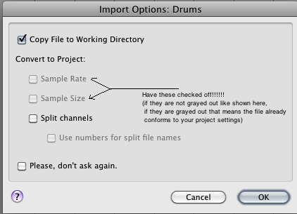

If you pitch shifted the files and your not to into it I would start over by re importing them. Hopefully you can undo the offline processing (if that is what you did) If you are worried about losing all that mixing you did FEAR NOT! haha you can save the entire mixer as it was set (minus the sends for some fucking stupid reason).
To save your mixer settings: Just right click in the mixer window and use the "save all mixer settings" option and save that to a location you will know later.
Re setup the session, IMPORTANT!: Make sure your tracks fallow the previous session (so if you have your drums: kick, snare hat, rack 1, rack 2, floor OH L, OH R, GTR L, GTR R make sure your tracks are exactly in the same order. Also make sure you add all your busses, basically the mixer needs to be the same as it was).
This time when you do the session though do this! :):
