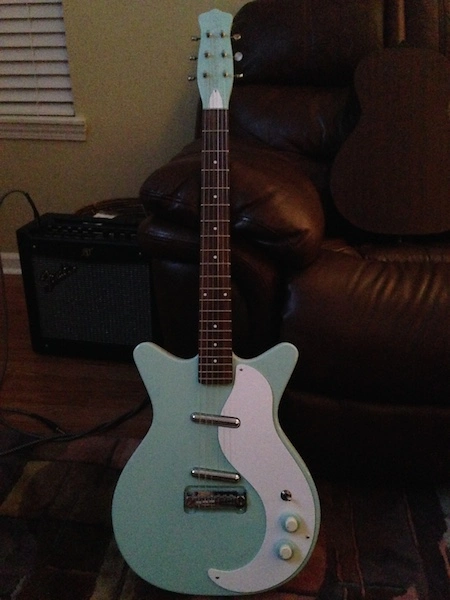

what is this?
Crappy picture but helluva guitar!
Question is about the lipstick pickups. Not sure how sensitive they are compared to "standard" single coils but there is a noticeable difference in volume between the bridge and "neck" pickup. The neck (more like middle) pickup is considerably louder than the bridge pickup. The heights are, without putting a micrometer on it, just about the same but dang. Neck pickup is booming and bridge is just kind of there. Would a height adjustment fix that or is it just the nature of the beast? This is my first hands-on experience with lipsticks so wasn't sure if it was just physics or a crap design.

Cardio: I'm pretty sure the pickups are adjustable, the screws are through the back of the guitar. I'll have to play around with that a little later today. The amp is a little Fender Mustang I that I keep in the living room for dinking around. It also doubles as a play toy for my 2 year old niece when the in-laws come over. It's not bad for a practice amp.

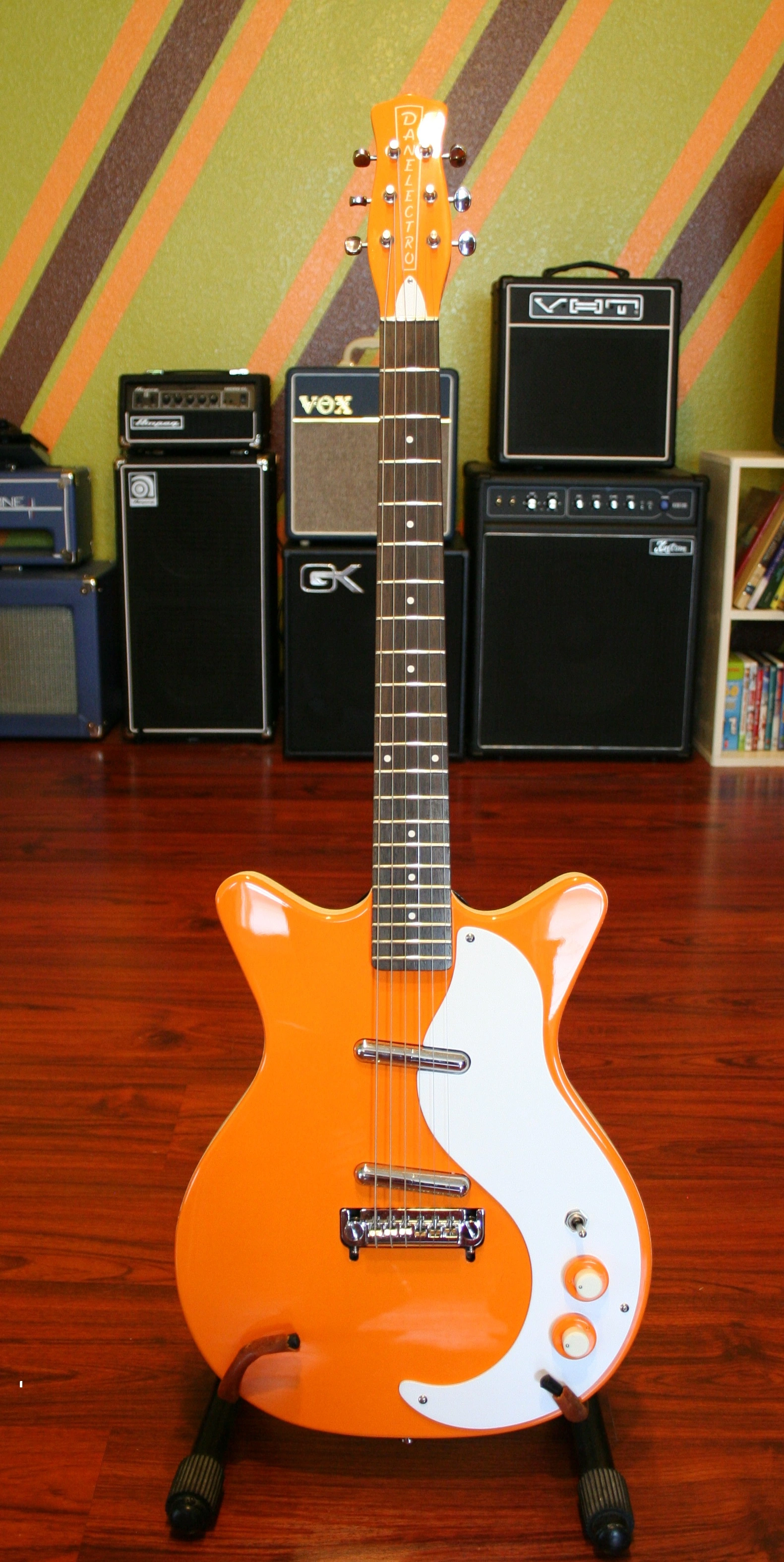

Very nice, beagle! I almost went with the orange, was also considering the "baby come back" blue but my gut was screaming sea foam green! Nice amp collection, by the way...what's that blue mini stack in the left of the pic? I've been trying to find a VHT to try out, too...

Yes I do/did have that same problem with mine. I figured it was because, as others have said, the pickups were probably identical, and the string vibration at the neck is much greater than at the bridge. I adjusted the heights of both to compensate for it, but the neck is still a bit louder. It's livable though. If I remember correctly, the middle position on mine is the loudest of all.
That blue piggy back is a "Montone," named after my old cat Monty. It's a clone of a Marshall 18 watt that I built. The cabinet has two 10" Webers in it.
That little VHT Special 6 totally cooks! I love it. For the price, it's amazing.
