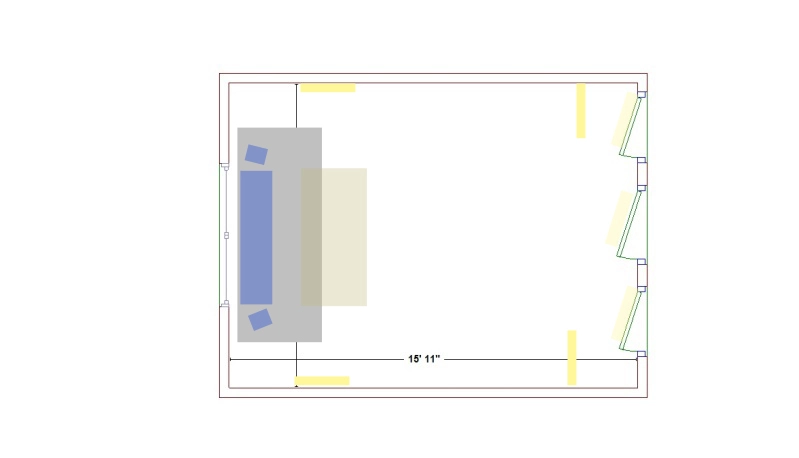

I'm currently putting together a small home recording studio, and I have a few questions. It's primarily for myself (piano/guitar/vocals). The room that I have to work with is rectangular. Dimensions are 11' 10.5" x 15' 11" with a 7' 8.5" ceiling. It's a bonus room above a garage, and it's the only room on the second floor. It's NOT a typical bonus room with 5 foot "knee walls." There's only a small diagonal (~6 inches) at the top corner of each side of the room. You can see it in the pics. I assume this will not hinder anything at all acoustically, but I may be wrong. The window on the far wall is 5' 7" wide. There are two closets, one to each side of the entry door that leads to the staircase. You can see all of this in the pics as well. The room is carpeted with standard residential low pile carpet. I know this probably isn't ideal, but I don't have the ability to lay hardwood or snap laminate at the moment. My questions are aimed at getting the best results I can with what I have to work with.
I currently have an M-Audio Mobile Pre interface that I plan to use. I also have a Yamaha Clavinova CLP120 that I will use for piano and as a MIDI controller.
1. Is a decent studio even a possibility in the given space considering dimensions, carpet, etc?
2. What type of monitors do I need considering the space I have to work with? Do I need to use a monitor/sub combo?
3. What treatments do I need for the walls or ceiling?
4. Where do I need bass traps? What type do I need?
Please feel free to give any other suggestions or recommendations. I'm new at this and here to learn. Thanks in advance for the help!

Anyone else have any layout or treatment advice based on the pics in the original post?
If you look at the back wall where the three doors are located, you'll notice that vertical traps in the corners next to the closet doors aren't really an option. How big of an issue is this? How should this area be treated so that the closet doors remain accessible?
How about the stand alone traps I mentioned?
Basically some bass traps that you can just move into place when needed.
Plus you have a thermostat in the corner.
I have a novel approach which I don't know will work or not. Maybe GIK can confirm.
4" thick OC703 on all three doors. Then two gobos, floor to ceiling a few feet in front of each corner. Make them portable to move out of the way when not needed.
Then typical mirror spots, cloud, behind monitors, etc.
My drawing isn't great, hope it shows what I mean.

The drawing looks fine to me. :) That idea definitely makes sense. I had already thought about the possibility of panels / traps on the doors since I couldn't place them in the corners. Maybe GIK will weigh in on it as well.
