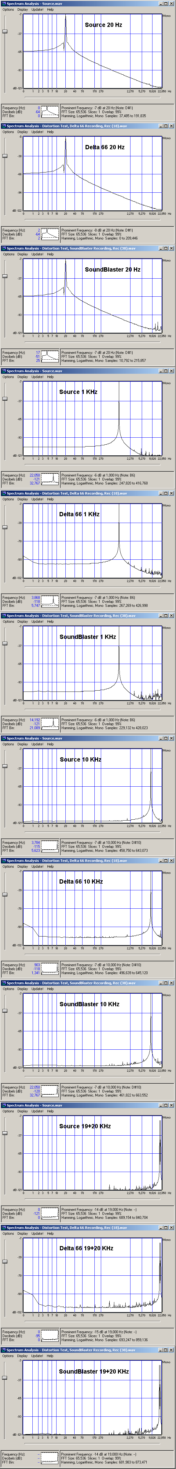

I have a bit more to offer. Below are FFT screen caps showing the THD and IMD and spectral noise of an original Wave file, a copy played out and back in through my Delta 66 sound card, and again out and in through my $25 SoundBlaster X-Fi sound card.
I have a big "oops" to report. When I did those sound card distortion tests in SONAR, I accidentally had the MIDI metronome playing a hi-hat through the SoundBlaster card. D'oh! So that explains the surprisingly high level of HF noise. The new graph below shows the correct results. Yes, it's still not as clean as the Delta 66, but it's infinitely better than what I showed. Sorry for any confusion, and hopefully this exonerates my SB card to everyone's satisfaction. :D
--Ethan
Nice catch Ethan. You probably know this better than anyone...What's an average studio have as background noise? Would that mask the distortion from a soundblaster card using a properly set up front end gain structure?
Believe me, I've made that point many times when people claim they can hear stuff like dither and jitter that's 90+ dB below the music. Put up a microphone and set a level suitable for acoustic guitar from a foot or two away. Then record a few seconds of room tone, play it back and note the play level meter. Oh, it's -50 or maybe -60? :D
--Ethan
