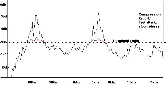

First, download the pic with this post. My question is, does compression have some pseudo-eq effects? Let me explain- pretend that the picture is that of a single kick drum hit being viewed through a spectrum analyzer, so you can see how much energy is in each particular frequency. You'll observe that in this particular little kick drum hit, there's a lot of low end around 100hz, and allot of attack near 3khz. Everywhere else is fairly even and more consistent. Now, we're going to compress it like this.... the threshold is -9 db (this will be a dotted line in the picture). The attack is fast, and release is slow so that it will catch any transients. The ratio will be set high so that it is really "squashing" the waveform, I said 8:1. The red line shows what I predict it would look like after you compress it (am I close?).
Now if you look at the red line, you'll see that only the peaks in the 100hz and 3khz were affected by the compression. Everything else is below the threshold, so it was not compressed. With me so far? Now, here's my point, you see what happened here, what's to say that you couldn't affect the wave form in a similar way by setting a parametric eq with a width of about 2 octaves and gain reduction of about 6 db, one centered at 100hz, and the other centered at about 3khz? And if so, when you compress a waveform at the top to tame peaks, is it only affecting peaks in certain frequency areas, which would be the same as eq'ing the waveform in a bunch of different spots at different areas and levels, giving it an "unnatural sound" which our ears recognize as obvious compression or "pumping"? And is this why compression makes mixes sometimes "muddy", because they are reducing hi-end peaks that usually make it "crisp"?

Its the threshold knob that gets you into trouble here,not necessarily the ratio.The threshold should ideally be set in decibels the distance from the average level of the track up to the highest peak.That way,the vast body of the music is completely unaffected with only the peaks getting pushed down.Trouble comes when you set the threshold down into the body of the program material.What happens is you are listening to the music just fine when a transient peak makes the compressor clamp down on too much then release after the peak passes and the music sounds ok untill the next peak.Notice how cymbals sound weirdly hollow during pumping and breathing artifacts.
Get gram.exe from http://prorec.com in the software page as Spectrogram.It is a free frequency analysis program where you can load a track or a mix and get a visual readout against a graph of RMS or dB.Cool Edit also has a freq analysis function.Put your mouse on the highest peak and note down the level.Do the same for the average.the distance between those two numbers in dB is the threshold setting.Set the ratio by eyeing the gain red from 5 to 15 dB depending.Let your ear be the judge here rather than a number.
