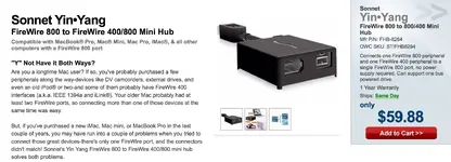

Older online forums talk about using a fw400 drive with Oxford 911, 912, or 923 chipsets to daisy chain into the 003. But with those Oxford chipset drives not being made anymore what would be my best attempt at getting the mini to see the 003?
Would something like this maybe do the trick? Or does it sound like it's jusut a glorified version of an adapter?
Has anyone found a way to get a mini to recognize an 003 without first going thru a fw400/800 external drive?
Guys thanks in advance for any help, I am grateful.
After some googling on that yin yang adapter, some good news may be on the horizon for folks in this same boat. I just found this review of the YinYang FireWire hub on B&H photo's web site. It sounds as if someone was in the same situation trying to connect an 003 to a Mac which had only fw800. Here's what he had to say:
It looked promising so I ordered one :guitar::guitar:
I'll post back whether it works or not when it arrives. Keeping fingers crossed!
